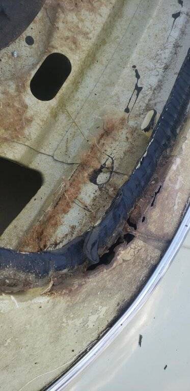

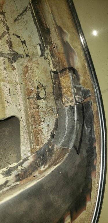

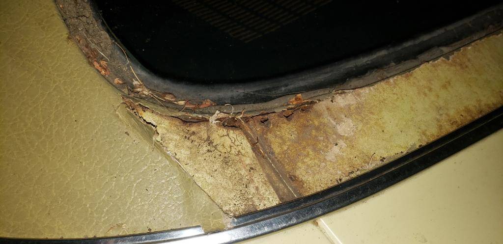

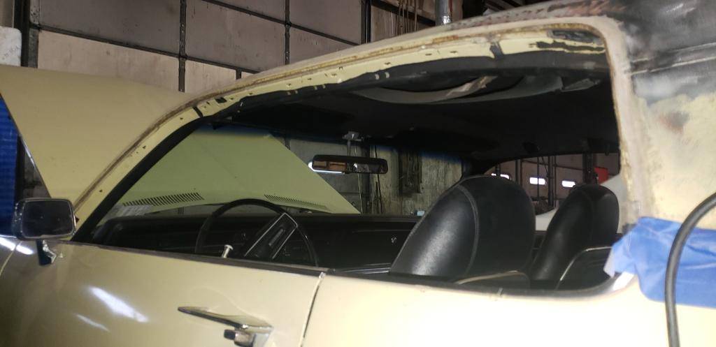

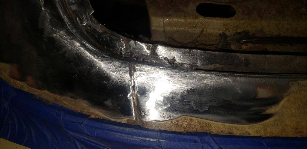

Meanwhile, repair work is progressing apace on the top. @71Polara383 has sent me the pictures below. The good news is that the rust we have found is limited to the lower left corner of the rear window and to a few spots due to rust out of the moulding/trim clips. Here are some photos of the main rust area right after pulling the vinyl, after cleaning before repair, and during repair. Those small metal patches aren't welded into the corner yet, but I like those handmade patches from 73NYB metal. Once welded, the should blend in completely:

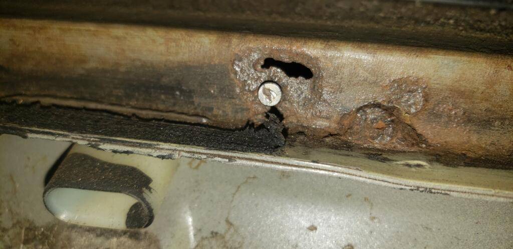

Here is another issue that Wyatt is now fixing. It seems it rusted right at the clips under the back window. Wyatt needs to whip up a few more patches for the rust around the clips:

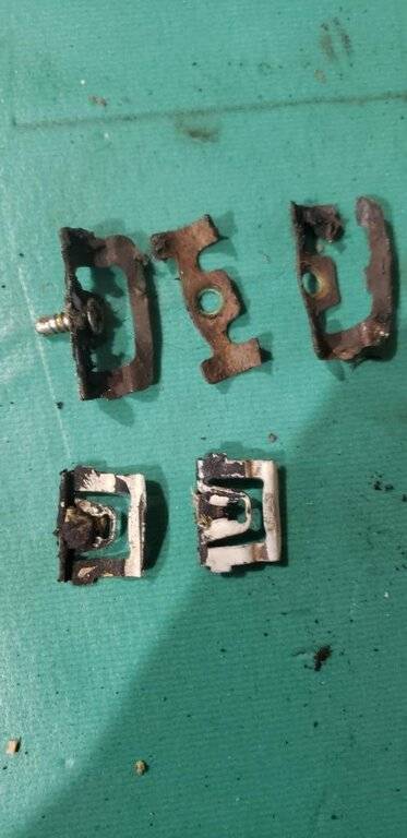

The clips are indeed in poor shape, which was to be expected:
Thanks to @Analog Kid , who identified and vouched for a source on eBay, I have ordered the correct large clips (12 needed), small clips (ditto), and screws.

1. the metal work on the rust repair is finished, thanks to @71Polara383. It seems that the trim doesn't fit the corner as tightly as it should on the driver's side as it does the passenger's side. The pictures I had from before the top came off show that this issue existed before the repair. That's likely why it rotted in one corner and not in the other: there was a pocket. Wyatt is therefore making an adjustment for a better fit. Here are a couple of pics showing the progress.

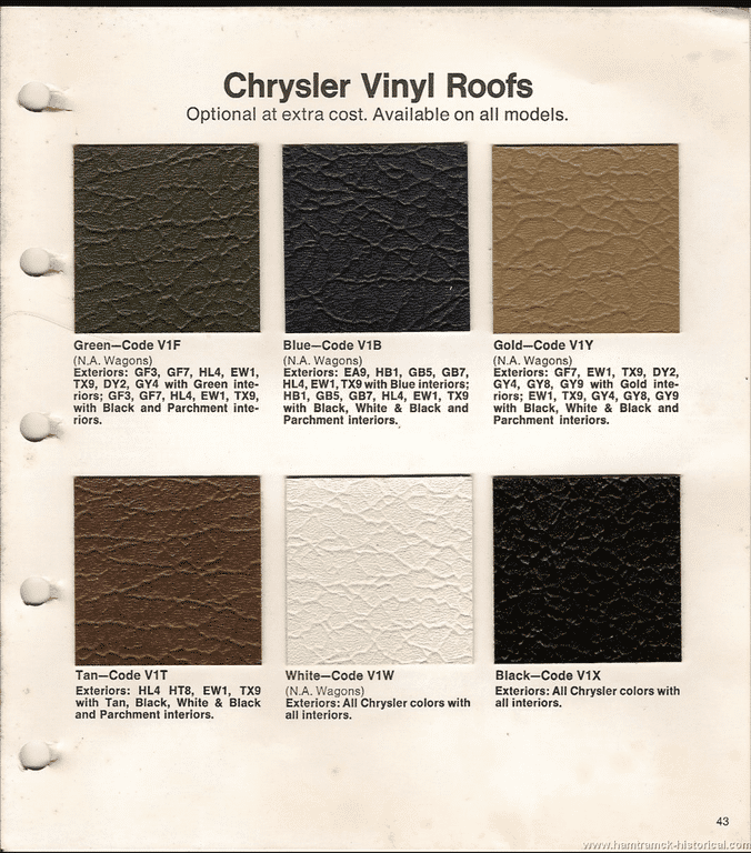

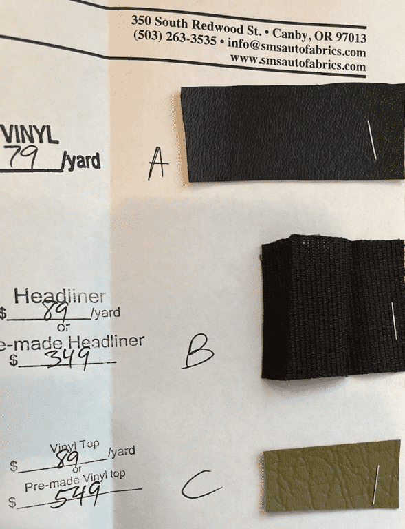

2. I have received material samples from SMS. I need to see them side-by-side with the original materials, but from the pics I have they seem to be matches. Assuming all is good, my plan is to order the vinyls (seats and top) from SMS and to have the shop recommended by @david hill do the cutting/sewing/fitting work, while ordering a headliner from SMS. There is no rush replacing the latter, so even if they tae their own sweet time that'll be OK.
Note, in the photos below, the slightly greenish tint to the V1Y vinyl, which I thought was discoloration on Buttercup but apparently is correct. Pic #1 is in the shade, pic #2 is in the sun.
