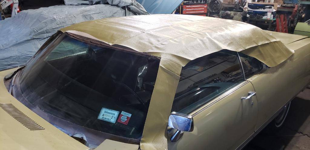

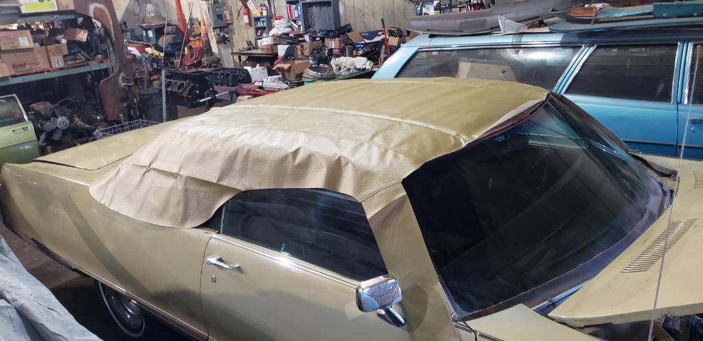

Not yet. My thinking at this stage is to get the correct material and have it correctly reproduced by an upholsterer/top specialist.
@73Coupe has now
struck out twice with SMS, so I am thinking of getting the material from them and hiring someone to do it properly.

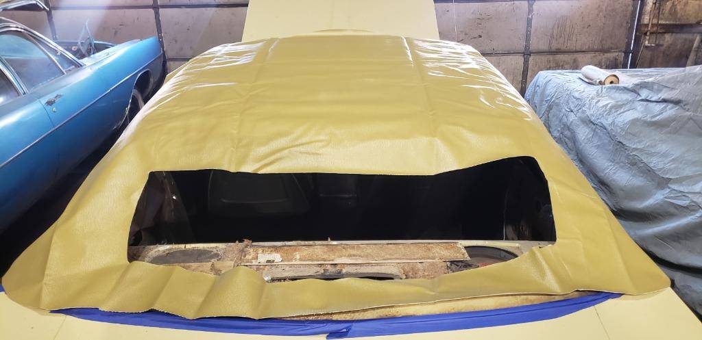

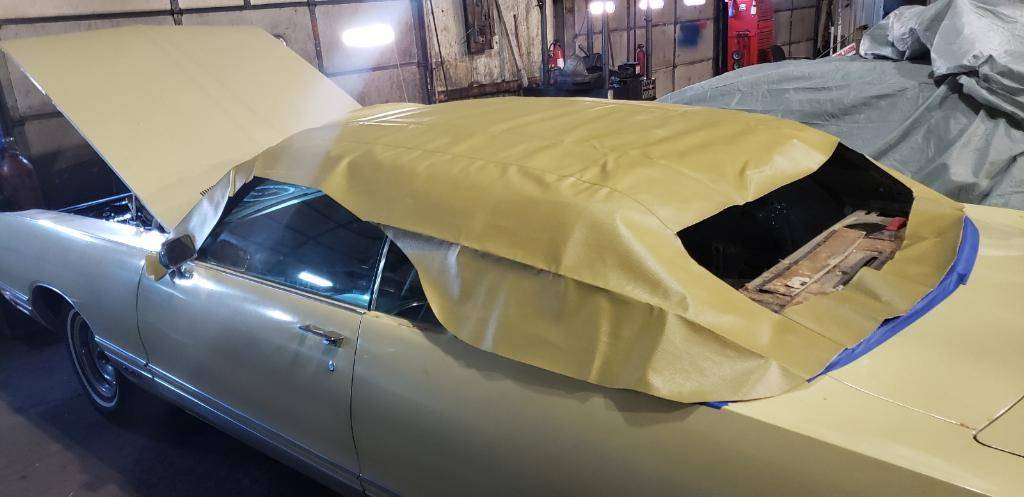

Meanwhile, repair work is progressing apace on the top.

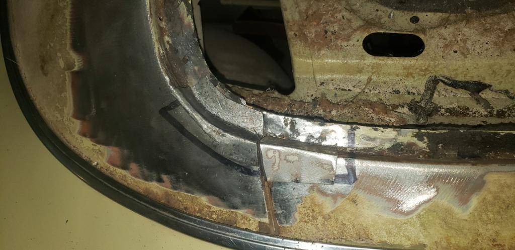

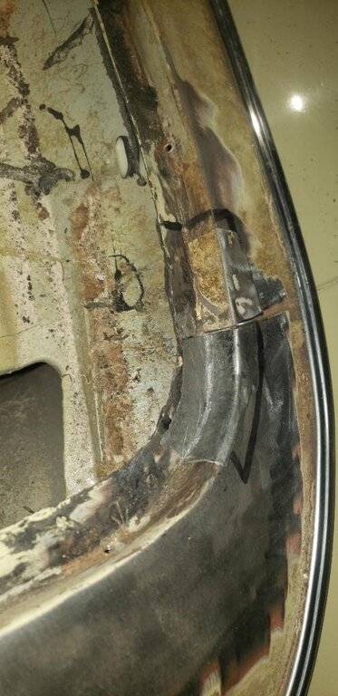

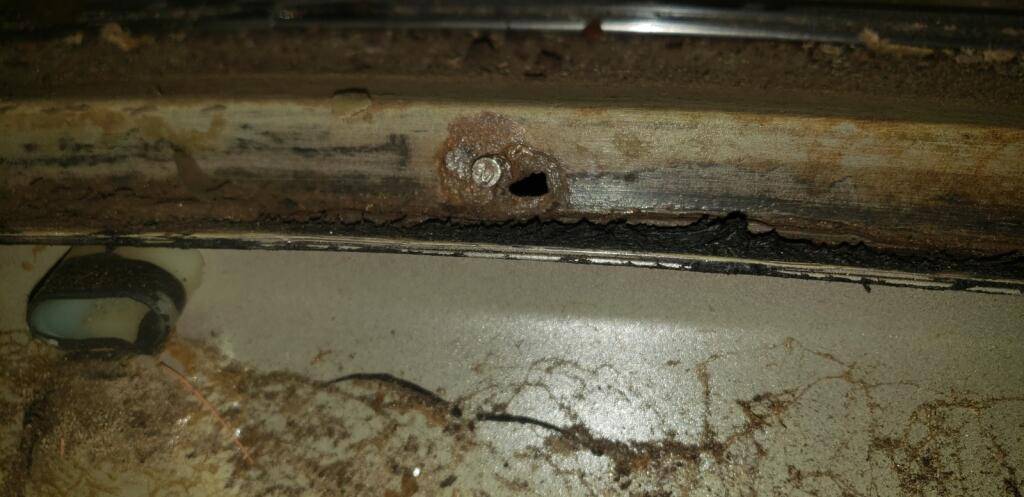

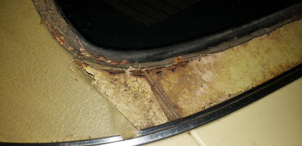

@71Polara383 has sent me the pictures below. The good news is that the rust we have found is limited to the lower left corner of the rear window and to a few spots due to rust out of the moulding/trim clips. Here are some photos of the main rust area right after pulling the vinyl, after cleaning before repair, and during repair. Those small metal patches aren't welded into the corner yet, but I like those handmade patches from 73NYB metal. Once welded, the should blend in completely:

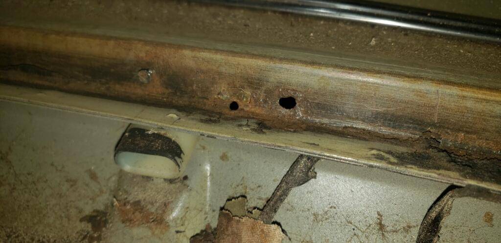

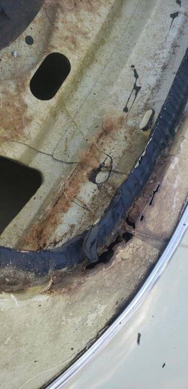

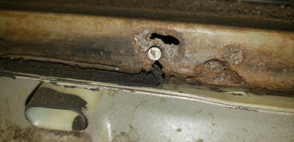

Here is another issue that Wyatt is now fixing. It seems it rusted right at the clips under the back window. Wyatt needs to whip up a few more patches for the rust around the clips:

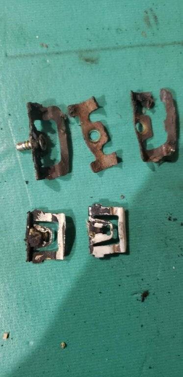

The clips are indeed in poor shape, which was to be expected:

identified and vouched for a source on eBay, I have ordered the correct
large clips (12 needed),
small clips (ditto), and
screws.
