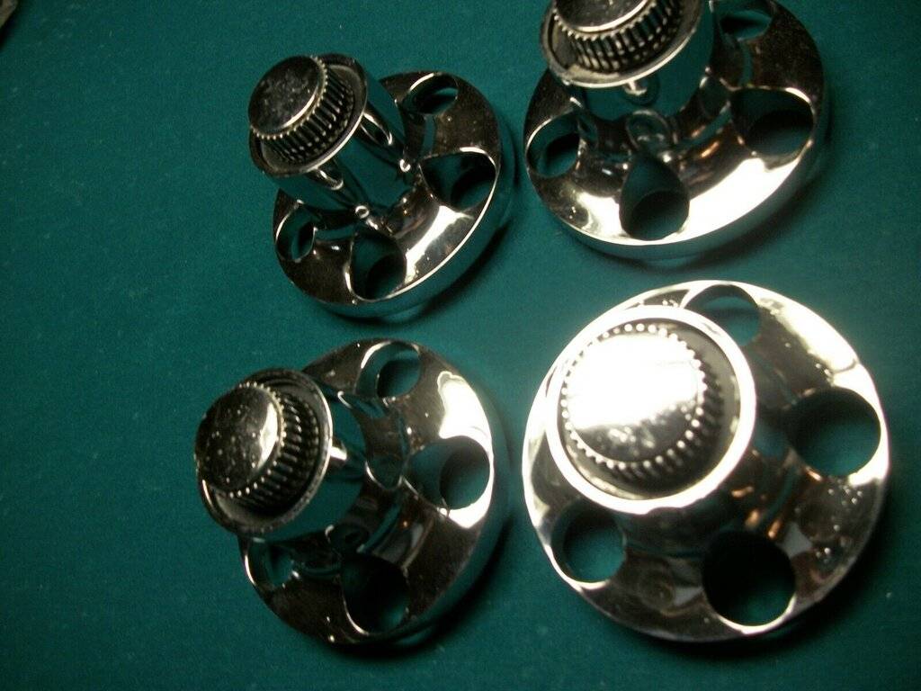

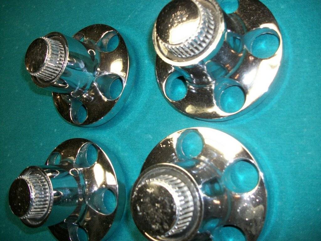

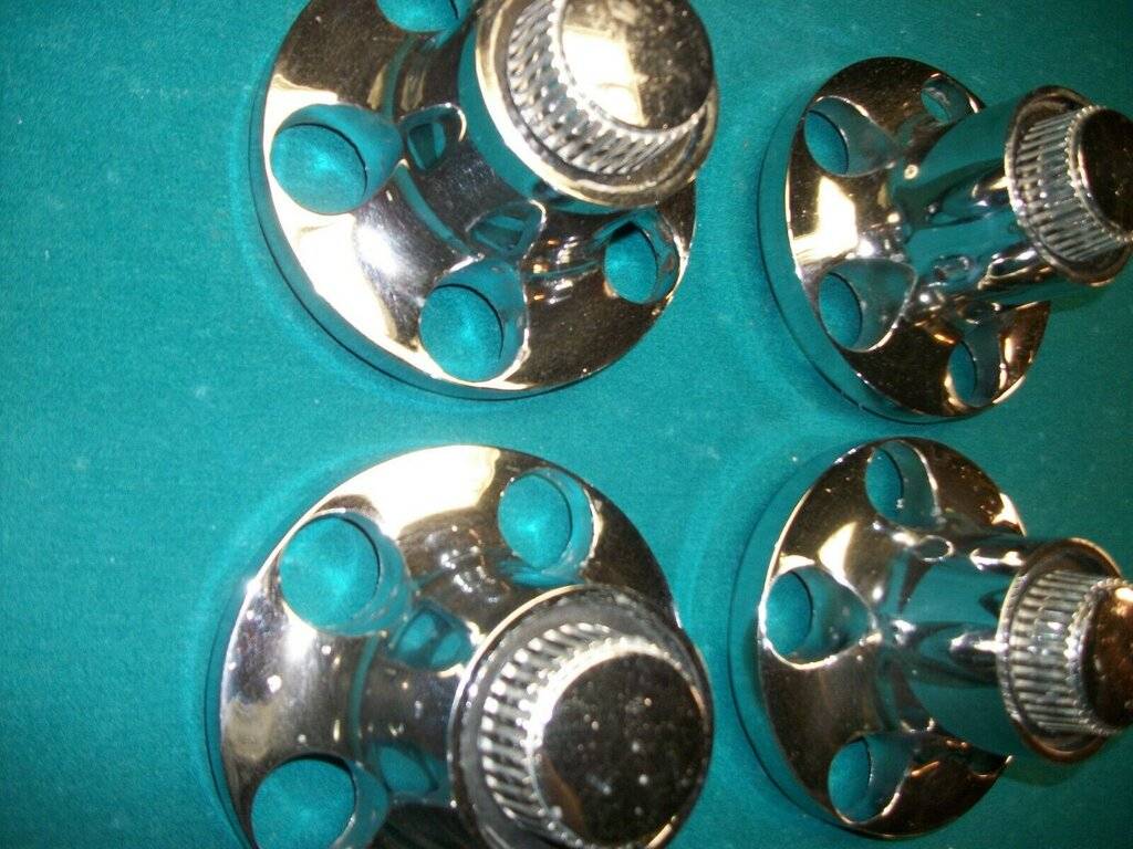

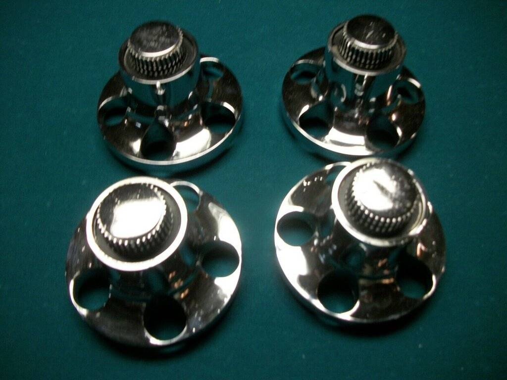

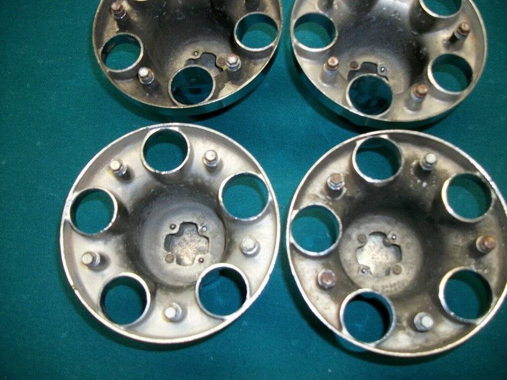

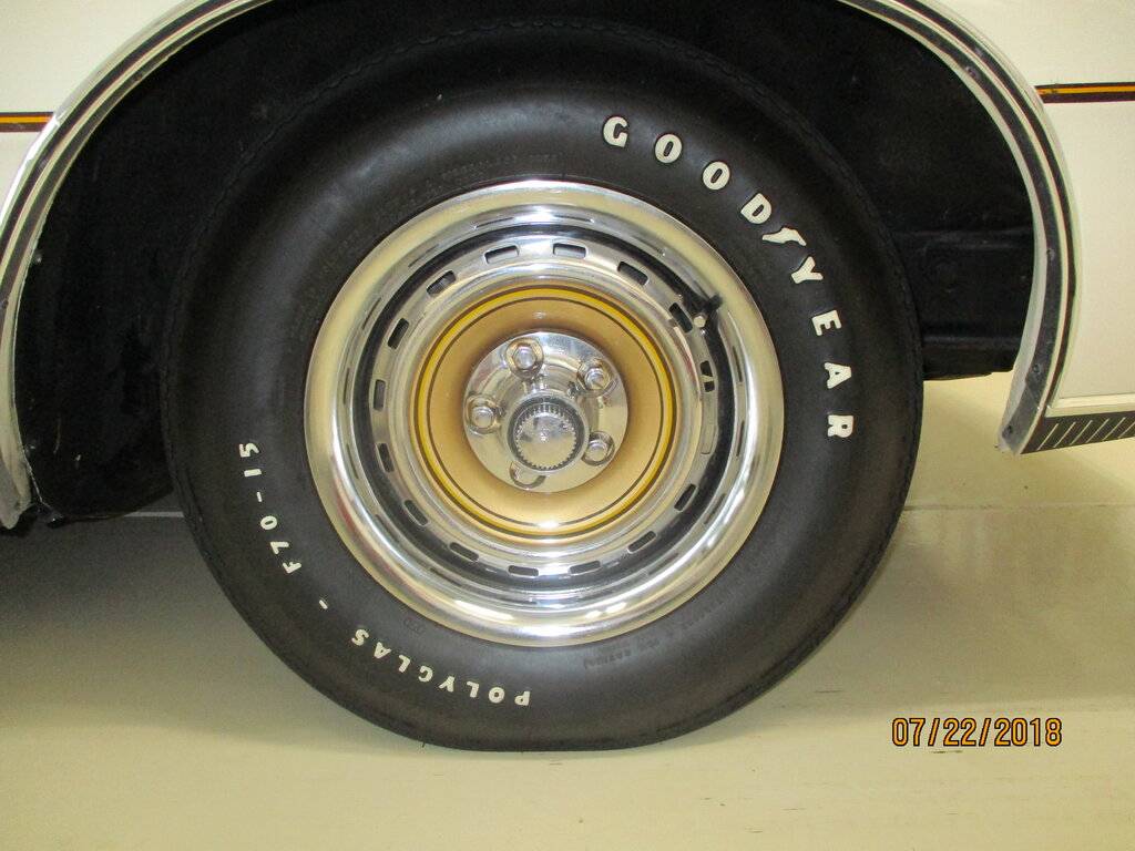

Snow White has incorrect center caps on her road wheels. That issue has been solved as I won an eBay auction ending yesterday. They are not perfect, but then Snow White is meant to be driven and I think I got a fair deal. Here are some pics:
Very nice score!
Just a caution--I almost lost the center "spline" out of this cap because the tiny bolts were loose (one missing, the other loose). Check them, use Loctite, etc.
Very nice score! Just a caution--I almost lost the center "spline" out of this cap because the tiny bolts were loose (one missing, the other loose). Check them, use Loctite, etc.
Thank you for the sentiment and for the warning. The reason why I posted the pic is because I had noticed that several of the tiny bolts would need to be reinforced. What did you do to yours, exactly?
Yes, it looks like you're missing one screw that I can see...or is the head wrung (twisted) off?
I took all four caps apart, cleaned the internal threads in the "spline" portion of dirt and corrosion, used quality stainless steel screws (hardware store) with thin washers, and assembled using Loctite. Loctite is the key step, as you don't need to rely on excessive torque (to keep the screws tight) and risk stripping the threads. Snug is good enough with Loctite.
I didn't much worry about the bolts that hold the cap to the wheel. Cleaned the threads, no Loctite, hand tight.
When I say "hardware store", I mean "my hardware store". :D
When I got the car and first started driving it a few years ago, I heard this jingle/rattle noise. I figured it was a typical Old Car rattle, but by sheer luck I thought to check those caps, not even realizing they were of two-piece construction. That spline was VERY loose and ready to jettison itself into the weeds, and I shuddered to think how hard it would be to find a replacement.
Were these the ones on Facebook? I thought about those for a second and thought better ..
Nice centers. That car wasn't an original roadwheel car?
That is what happened to a friend, so I will ask @71Polara383 to check/fix the caps as per your suggestion when they get to his shop. Thanks again!

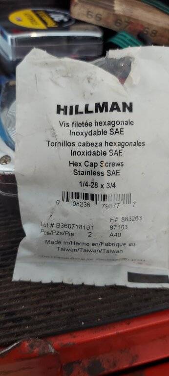

I posted a photo of what bolts fit. An off the shelf product at the Lowes, used lock washers and Loctite. :BangHead: I forget what thread that was in.
I've had three NOS sets, one I used. I NEVER wanted to hear that puppy come loose.
Thank you. I actually bought two sets this weekend -- the FB set to which I think you're referring for Buttercup (my GY4 1972 NYB) and this set on eBay. Both cars came with road wheels when I bought them, but the center caps were of the later (incorrect) model in both cases.
Thank you. I actually bought two sets this weekend -- the FB set to which I think you're referring for Buttercup (my GY4 1972 NYB) and this set on eBay. Both came with road wheels when I bought them but the center caps were the later (incorrect) model in both cases.
So likely not Roadwheel cars. Another curiosity, they weren't expensive, why not order them when the car was new...?... remarkable, we all want them now.

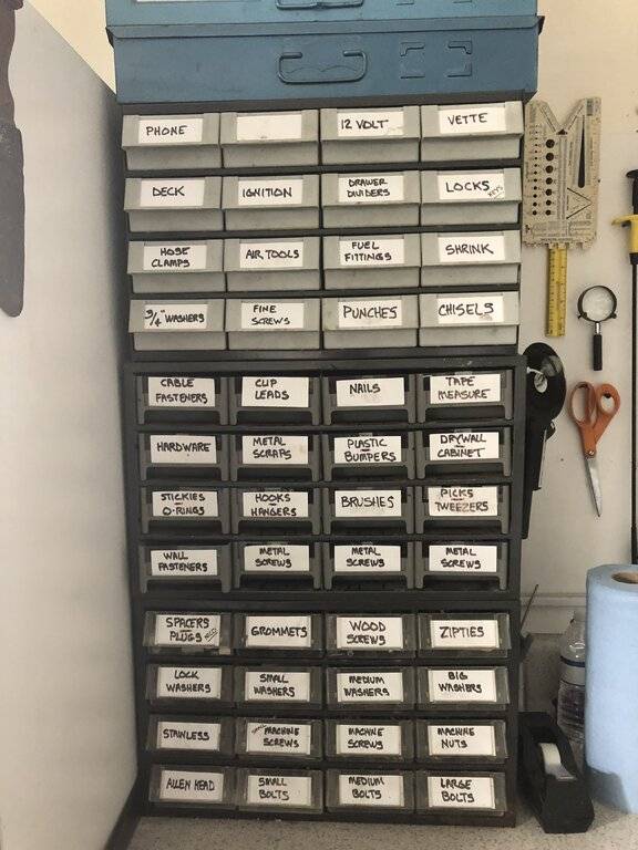

I know I know, I can not find American made hardware ...these are what I used on my centers on Adleen and Missouri.

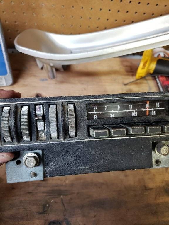

--> Thanks to @70 Sport Suburban, I have been able to acquire the hard-to-find R35 AM/FM radio that I needed to replace the aftermarket unit currently on Snow. I will now send the radio to S&M Electro-tech for refurbishing and will take the opportunity to replace the three front speakers as well (Snow, like her sister Regina, does not have the R31 rear speaker). Here is a photo that he sent me of the radio that will go into Snow:

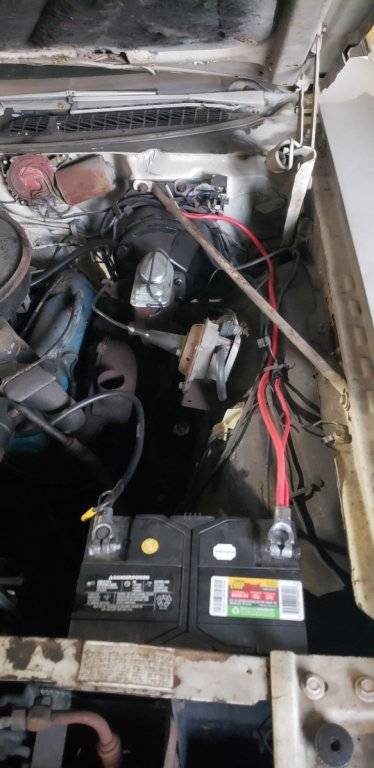

1. First is something that's been bugging me, the positive battery cable. Snow had an incorrect cable on, and I ordered a new one from Evans (see this thread) that @71Polara383 installed this weekend. Here are the before/after photos:

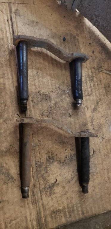

One of the shackles broke during the replacement, as often happens, but Wyatt had one from a parts car and that solved the problem. Those shackles are not available new (NOS or repop) to the best of my knowledge), so my advice is to not start on this repair unless you have access to a friend with parts on his shelf. Here is a pic that Wyatt took:

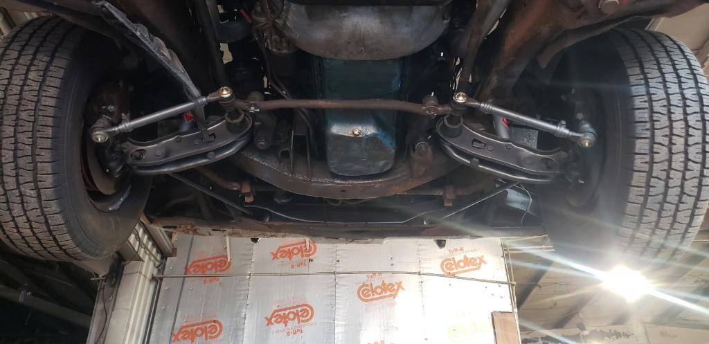

4. More importantly, Snow will get an alignment before she goes to @david hill (who has kindly agreed to shepherd the top replacement process). Here is a photo of the front end seen from under the car, with some of the new steering and suspension components bits whose installation that I have documented before:
