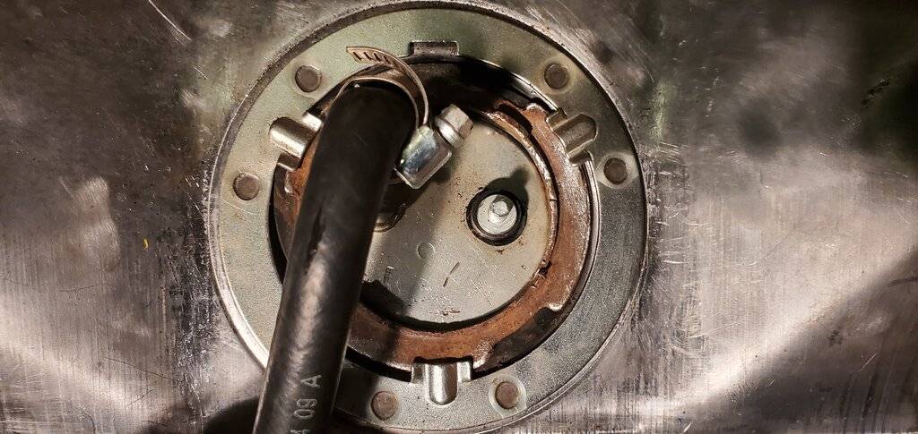

The problem is cheap aftermarket locking rings are not as thick as OEM or better aftermarket.
The gasket is not being pressed down enough.
Used the original lock ring like the elders recommend (used a new gasket)
I installed a new sender into my Polara, (tank in car), about a week and a half ago using the original lock ring, It leaked. Today I swapped out the gasket and ring with one I got from Vann's. Vann's lock ring was visibly thicker. I used a piece of 1X11/2X6" oak with a small hammer. Again, tank in the car and up on ramps. Filled the tank, NO leak.
