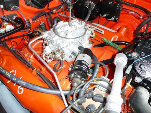

One other thing, you did remove that fuel line from the carb, right? No sense in pumping gas into the manifold and making things worse.
On this pic (stolen of the web) you'll see the fuel line going to the rear of the carb and the PCV line going to the front of the carb.
Yup... all set with that TY! Like I said... I have a good mechanic in my town... hell, he has came over and looked at the car, turned some wrenches, knocked on some metal and dint charge me a dime even though I wanted to pay him for his time. He is passionate about these cars st like you all are so I guess I am in good hands.
