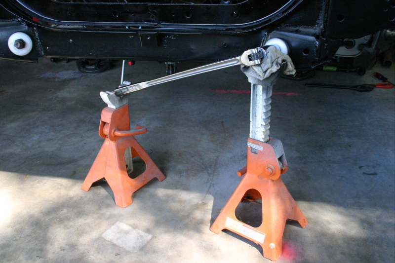

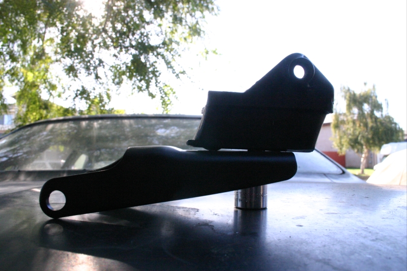

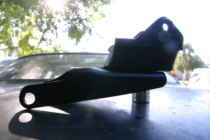

I could have pulled out the impact gun but from years of working without owning one I tend to look for other options.
The bar wouldn't reach the floor and I couldn't hook it on the frame so I needed a way to hold the socket to keep the bar from spinning.

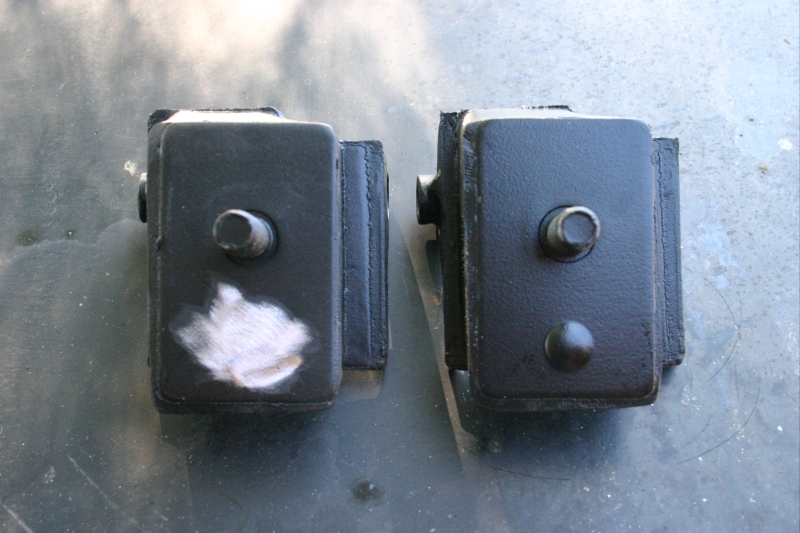

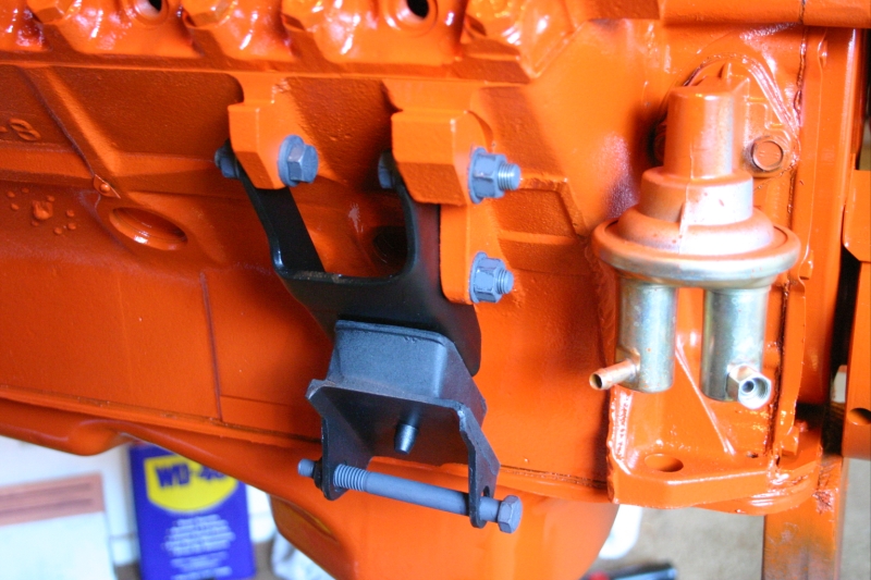

Before the engine could go in I needed mounts, needless to say I needed to order them. Upon test fitting them I noticed the locating nub didn’t line up with the hole in the bracket, I checked with a friend and he had the same problem with his 70 Cuda. The decision was to just grind it off, now the pad seats properly.
After playing musical hardware and referring back to some before pictures I was able to get everything back as it was (less grime). A torqued and ready to go.
