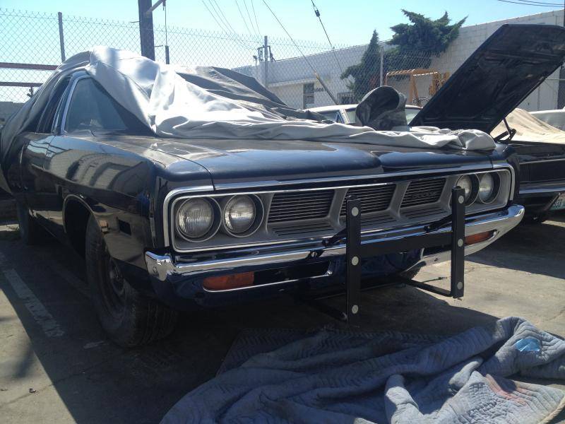

MrMopar's 1969 California Highway Patrol restoration
1-3644-Unknown Status
2-3645-Under Restoration
3-4685-Carsten (Driver)
4-4690-Needing Restoration (not driveable)
5-4808-Driver
6-4870-RON's
7-4948-ALAN
8-5081-Driver (recently painted all black)
9-Driver
10-Needing Restoration (not driveable, same owner as 4)
11-Unknown Status
12-Unknown Status
13-4551-Assumed scrapped, I have a hood from this unit
14-4889-Scrapped
I have more details on some of these but try to limit what I share with the world
Alan
5081 would be mine...
Yes, I know your car and saw it prior to your purchase and again just after it was painted. I’m also the one who made the facsimile of the broadcast sheet (I hope it was given to you), It was a scan of mine doctored to have your car information.

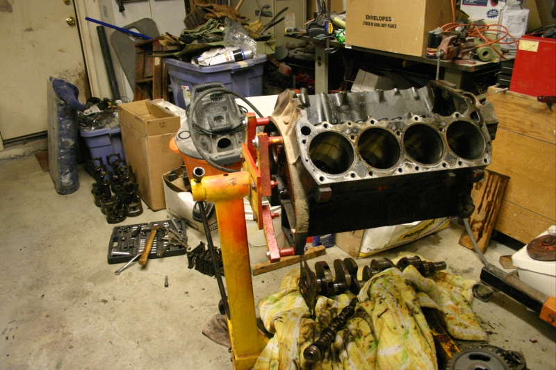

Well not much to say, I put the engine on the stand and stripped it down. It will be interesting to see what the machinist has to say, the only thing I saw was that it had a new timing chain. The car has 165,000 on it and doesn’t appear otherwise to have been touched. The car did sit in a field for 30 years and the engine was seized when I first started on it a few months ago.

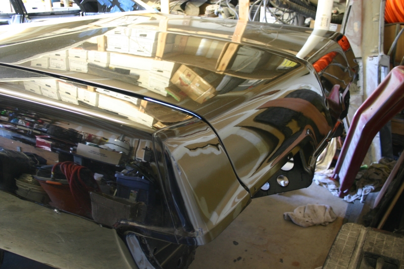

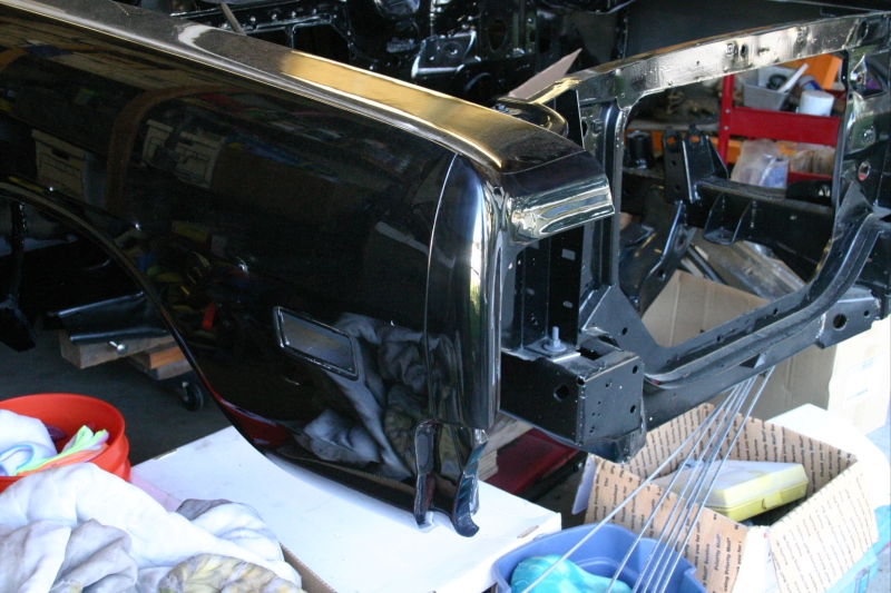

Even though I haven’t done much I felt I should post an update.
My body guy has signed off on the car for now (he wants it back in the booth when it’s done to fix a couple spots). The hood was polished along with the fender/quarter extensions.
The hood will wait till the engine is in.
With the engine apart I cleaned it the best I could before taking the block to the shop tomorrow. I have the block heads crank and all the rods loaded up and ready to go.
Then it’ll be about getting the car back together. Nothing has been cleaned up yet and will need to be done as it is needed. Heck even though I have already done one car I feel a little at loss on where to start.

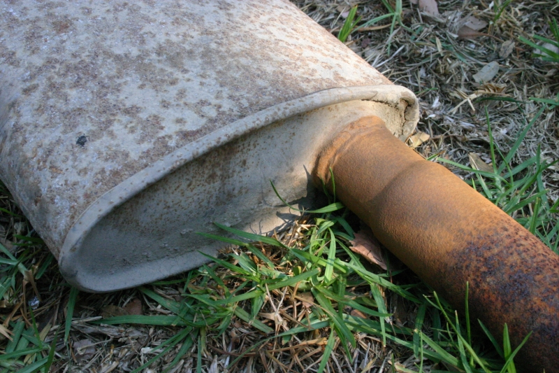

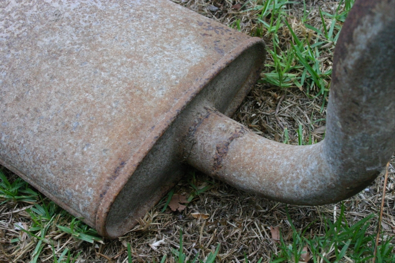

With the recent talks about exhaust I thought I'd look at mine in more detail.
I have no reason the believe that this is anything but original.
The system was specified by CHP to be fully welded.
The tail pipes are two piece, I'm guessing that they may have chose to use the standard piece for the tips.
The larger section measures 2-1/4 OD and the smaller 2" OD, I'd have to cut the pipe to get a true inside diameter.
The head pipe is choked down right at the muffler, that is not a welded joint. Head pipe is 2-1/4 up to this point although it is hard to tell as little of the pipe is round (from the factory), midpoint there is a foot long part that is flat on the bottom and the size varies in and around every bend.
Is it possible while your car was in service, it needed an exhaust ststem and that's how the boys in the farage did it and not the factory?
Were there any written specifications on the exhaust system as to be delivered?
I'm amazed the original exhaust made it through the entire service life of the vehicle.
Back then, ww were doing exhaust sysrems at 50k miles.
Posted via Topify on Android
I have my doubts, the date code on these is 4-69 which is good for a 5-69 build date.
The car left service with about 75k, unless it was a problem I bet they left them on. Previous owner did not do it.
The funny part is I looked through the spec and the exhaust is not mentioned, everything else is.
Looking at this installation I do no see how one could remove a muffler and fit this one in unless it was bigger than the original, or they had a pipe stretcher.
The pipe is consistent with other CHP cars, even the splice in the tail pipe and one piece headpipe with a welded flange, mine is the only one we have seen with what looks to be original mufflers.
This car had 165k when parked. My 1970 Dodge D200 has its original mufflers with 80k, my other Polara had a new muffler installed shortly after I got it, shop said it looked to be original, replaced as fitting rusted through, car had 60k on it.
Alan
My Challenger still has original pipes from manifolds to mufflers. It is amazing how stuff just doesn't rot out west.
