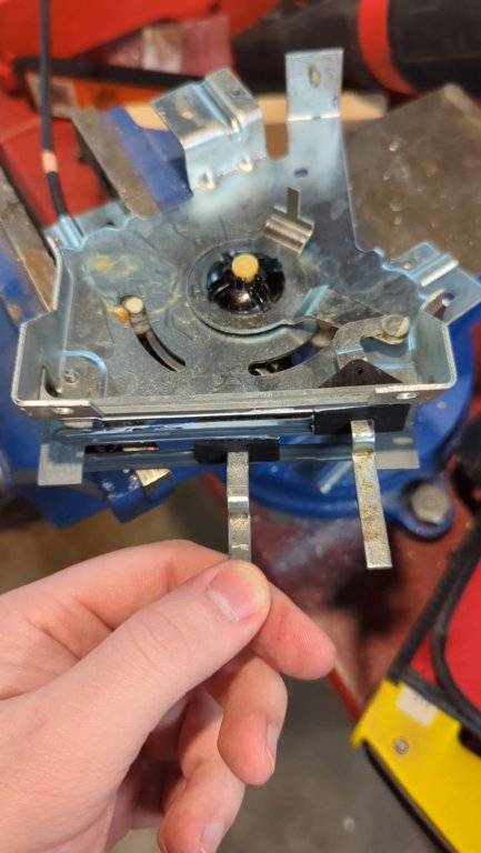

Edit: Forgot to add, I 3d modeled and printed new sliders for the heater controls. They work like a charm, still holding up after 3 years.
