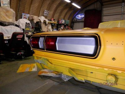

I've thought about that with my pitted 68 R/T tail lights and hood inserts. I did consider getting them powder coated too but Cuda Chick says the failure rate is pretty high for pot metal though

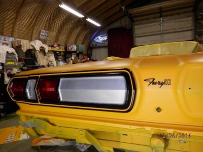

How are you going to fill in the blank space inside the tail light surround?
I'm thinking Argent Silver.

Pics don't show it well, put did paint with some rattle can stuff I had, was very close to what was there. Also, cleaned the lens with soft toothbrush and toothpaste, they came out very well.

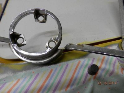

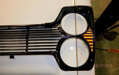

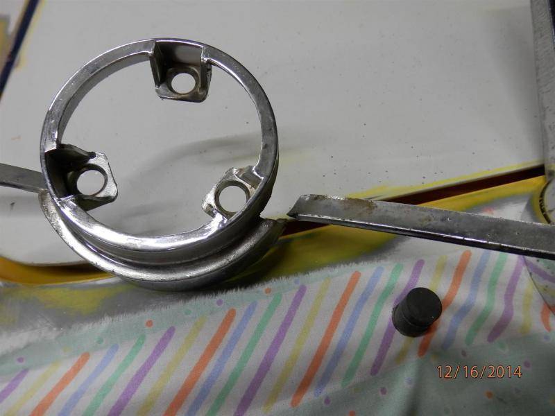

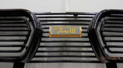

Since the back light bezels came out nice, decided to carry theme to the front. Also, the old horn center was crappy and horn ring broke, scored both plus contacts off epay for $50, a little paint, thinner to wipe off chrome, almost new looking steering wheel, feel good about that deal.

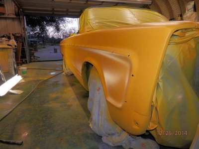

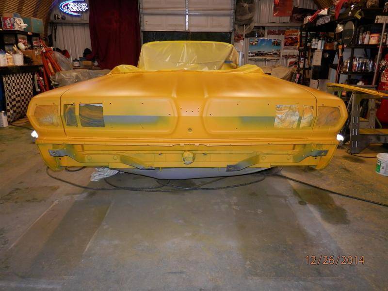

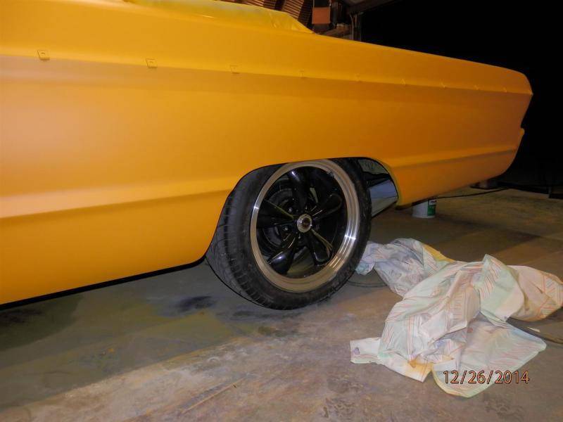

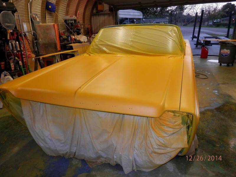

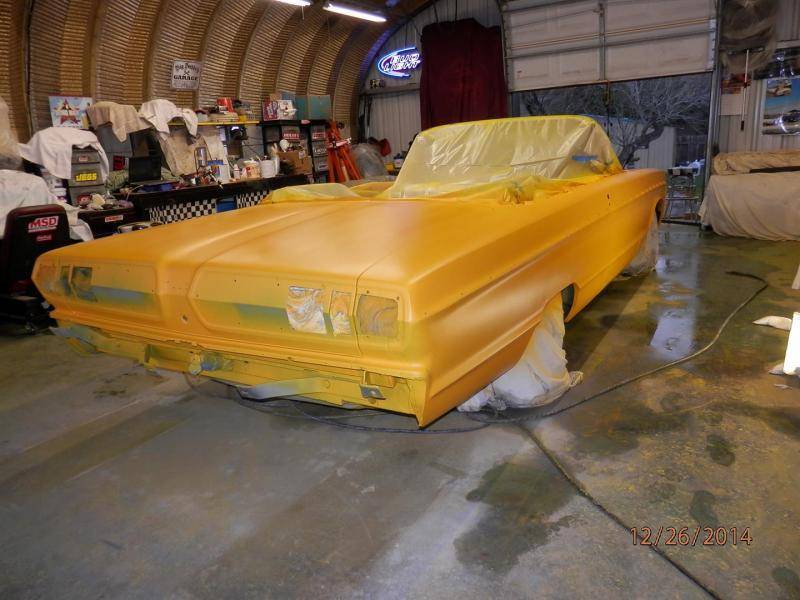

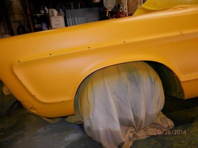

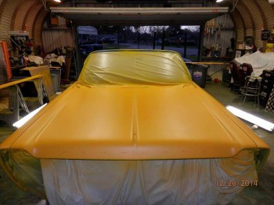

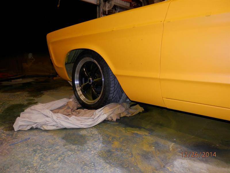

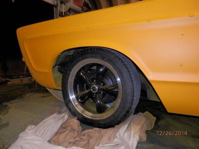

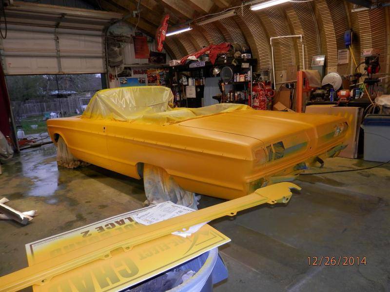

Color is on. The good - not 1 single bug in paint. Bought some screens for the doors, they worked great. The bad - this d@mn car is soooooo wide, and my short arms/legs made id very difficult to do the middle of hood/trunk. Got a tad heavy in a couple spots. Need some more reducer for the clear coat anyway, so will get a 1/2 gallon paint, wet sand, 1 more coat paint, then hit with clear. All in all, not to bad for a garage job.
