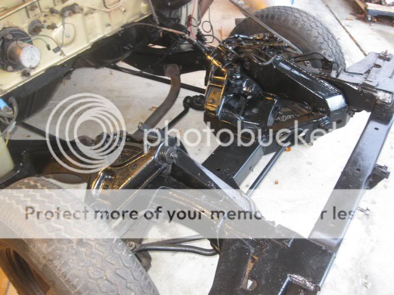

The story takes a hiatus, since amidst the "2 week" project of pulling and freshening the motor, I bought a house. 2 years, 2 bathrooms, 1200 sq ft of hardwood, a kitchen worth of tile, and about 20 gallons of paint later, i'm ready to get back into it. I pulled it into the garage (scary that it hardly fits) and started the process of prepping it for bodywork, and reassembling the motor.
