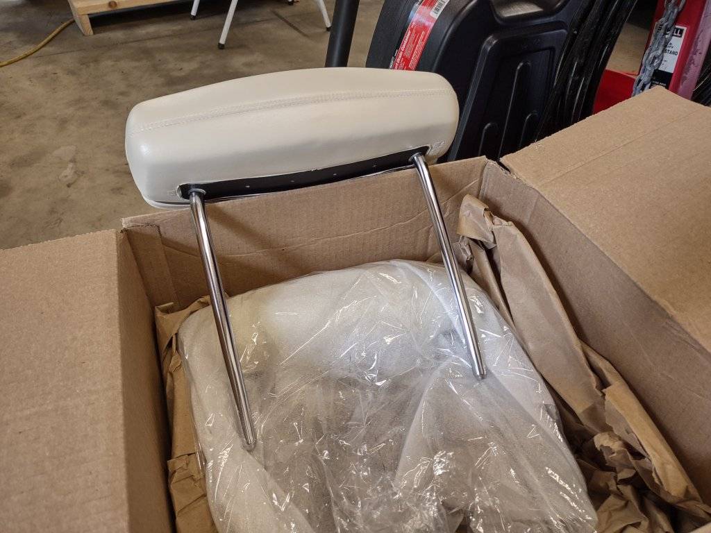

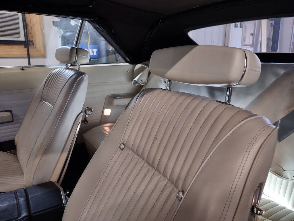

In addition to the above, I also installed my newly restored headrests. They were redone by AMS Obsolete. They did a fantastic job; I think they are better than new. Here are a few photos:
View attachment 624544View attachment 624545View attachment 624547View attachment 624548

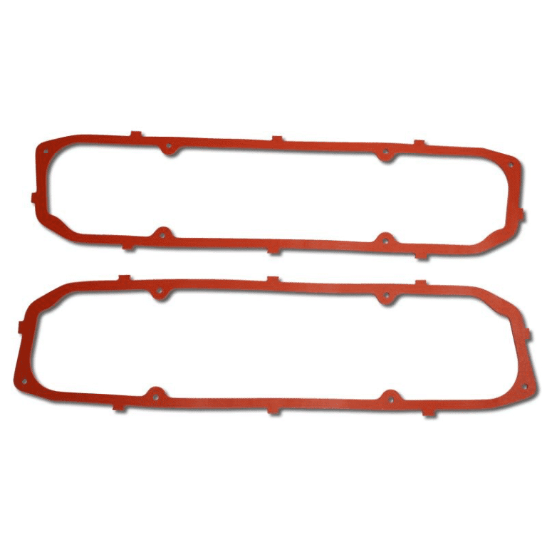

In addition to the tasks shown in this post, I also spent considerable effort to fix my leaking valve covers. You all may remember seeing my Wanted thread inquiring about replacement valve covers. After two failed attempts to fix the leaks using FelPro gaskets, I finally ordered the Tennessee Real Gaskets and a set of studs that replaced the stock 7/16 valve cover bolts. All is now sweetness and light - no more leaks. Home

@Ripinator -- two questions:
1. Why did you order a set of studs to replace the stock 7/16 valve cover bolts? And what studs did you buy?
2. TRG has two different sets of valve cover gaskets. Did you order the ultimate silicone ones?
Thanks! But why did you change the originals?
We had a helluva time getting the gaskets to stay in place correctly when mounting the valve covers. Having the studs allowed us to better position the gaskets and covers.
