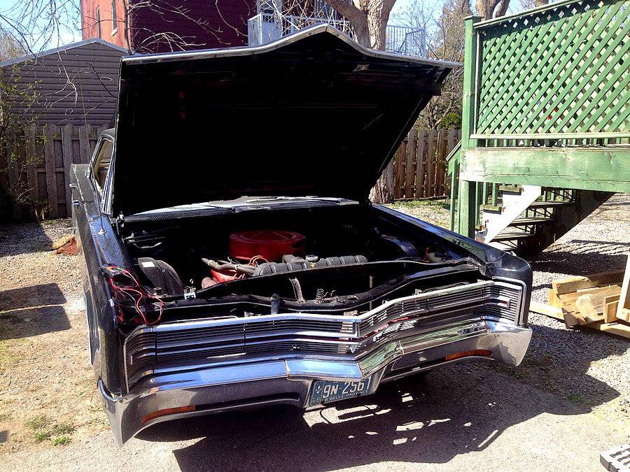

Lets continue the little tour of my 300 and after I show you the little work I've begun

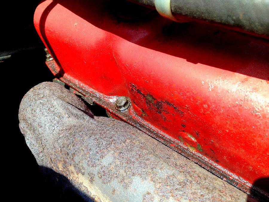

The valvecovers gaskets are leaking, but not enough to drip on the manifolds so it gonna stay like this for now, later I'll remove them, repaint and reinstall with new gaskets

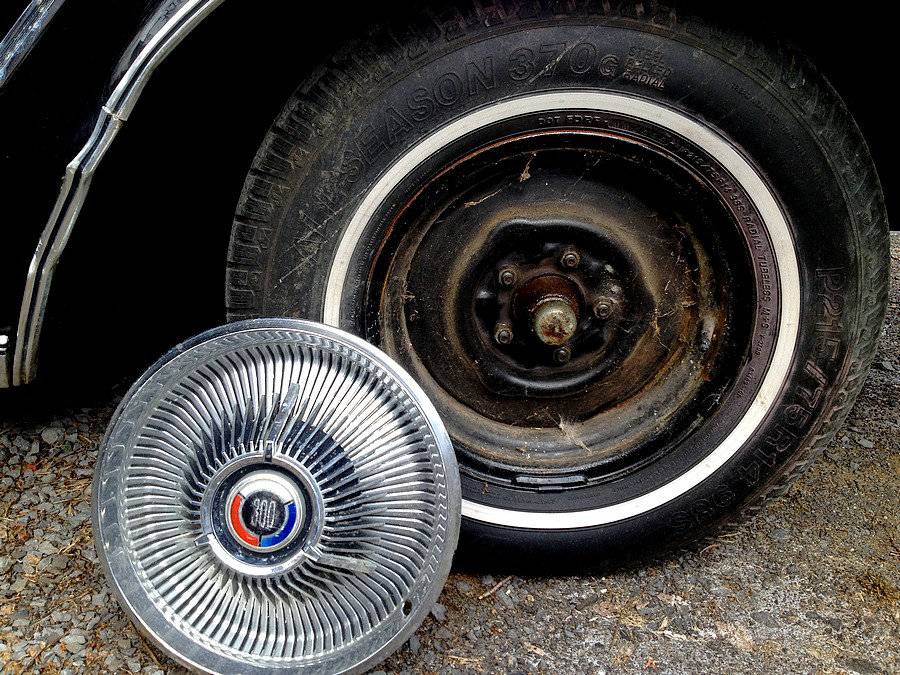

The rims under caps are really clean, and the 4 original caps are decent
When I received the car the 2 headlights panels were stucked open this was ugly, I've searched the reason with a multimeter but everything was good and the electric motor for headlights panels was receiving the good tension, then I strike a couple of times on it with a hammer and panels closed, magic! :sSig_noob:
The car is radically nicer with these headlights hidden!

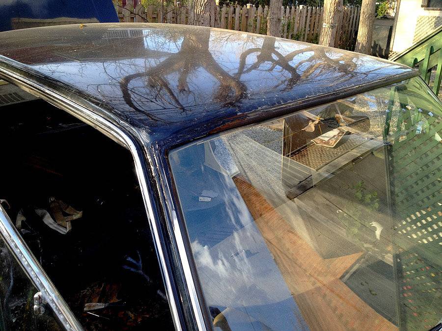

There was already a seal of old silicone sealer on top of the windshield but the right corner was too deteriorated
I think the water is entering by the bottom of the windshield too or a moulding near because the water is still entering now, but just some drops
Like you see, the top windshield moulding is missing :(

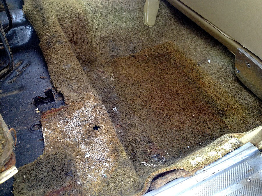

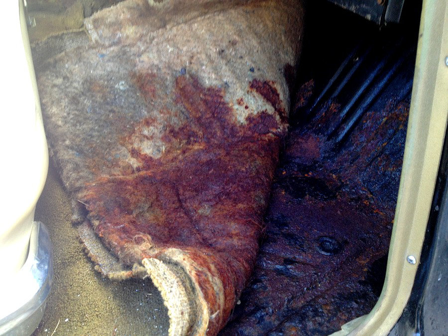

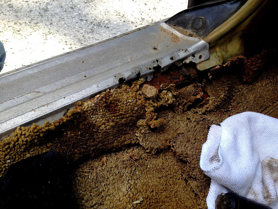

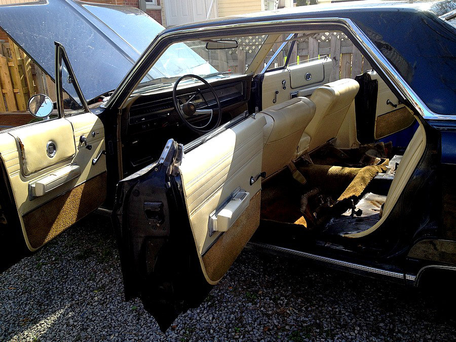

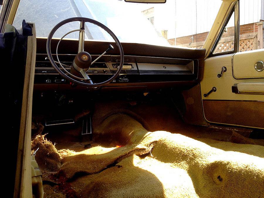

Just when you see these carpets you understand instantly that you'll have some really bad surprises when you'll remove them
All the carpets are wet and soaked, the insulating pad stucked under the carpet is good in Florida or other south states, but in Canada when you enter in the car with snow, slush and calcium, it stays in this pad and never dries before spring...

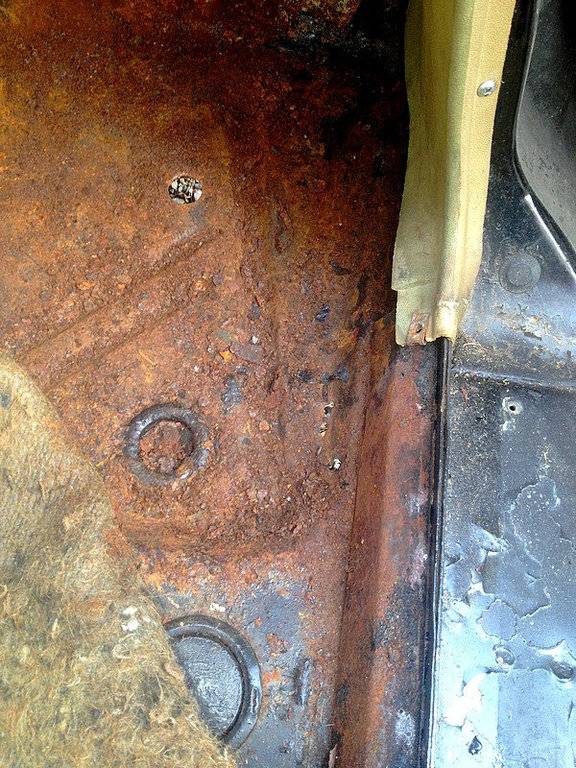

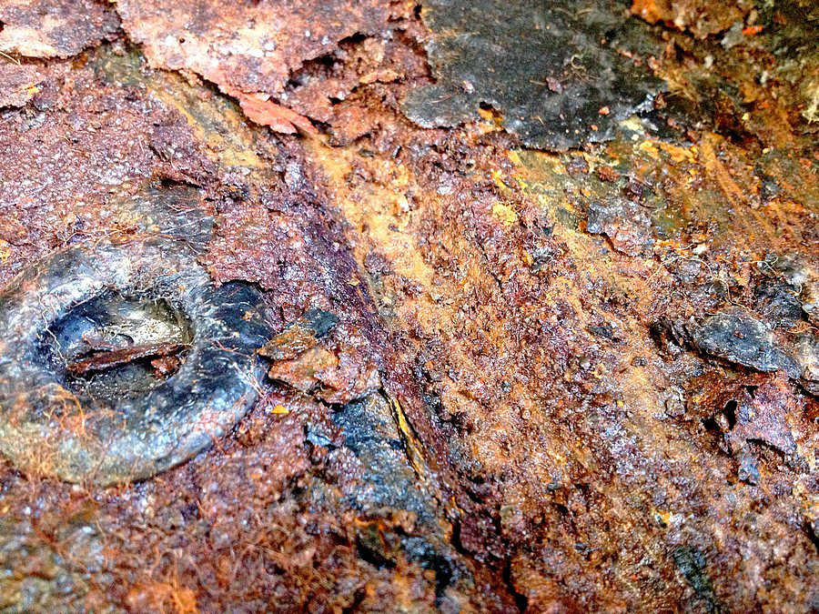

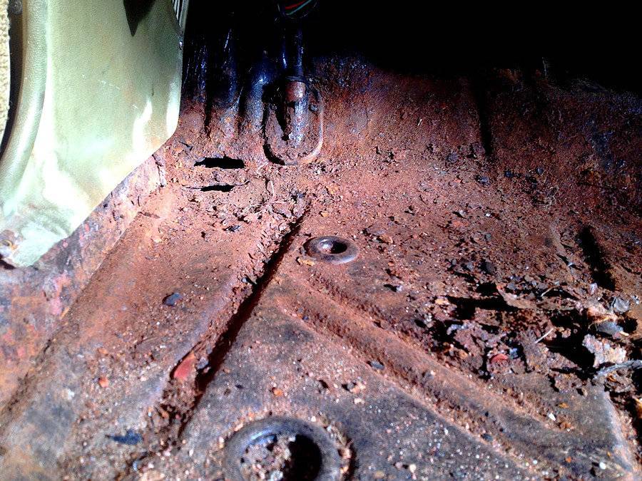

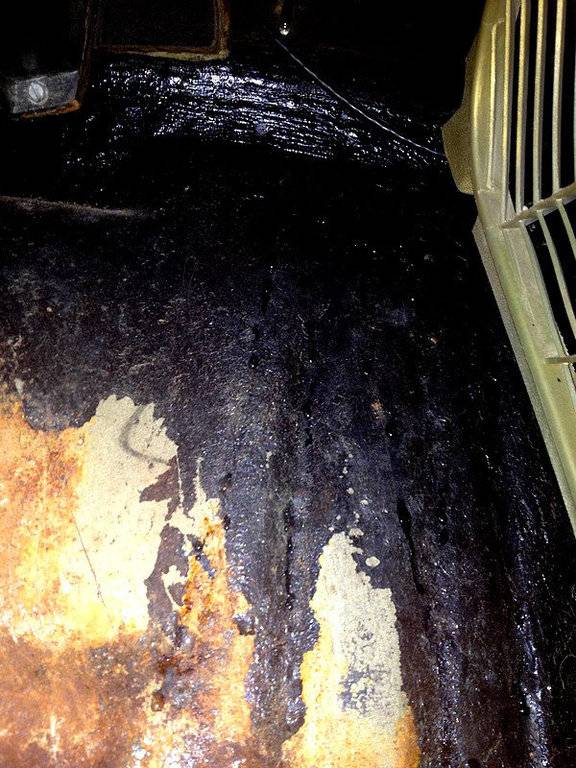

In my 300 like you see the floor pans is beginning to rust and I have a lot of work but the pans are not rotten yet

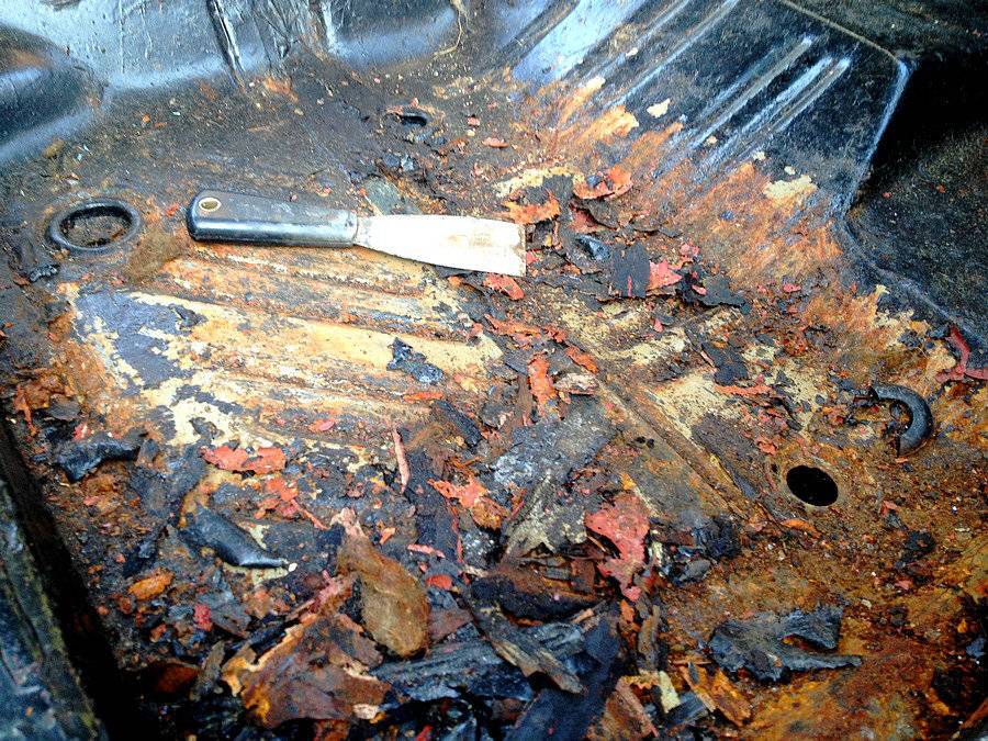

On a close-up view this is pretty scary but in reality this not so bad: the car was repainted black a long time ago, fully repainted, interior-exterior, even the floor pans, so you see the black paint peeling off, but the gold original paint below stills relatively well preserved

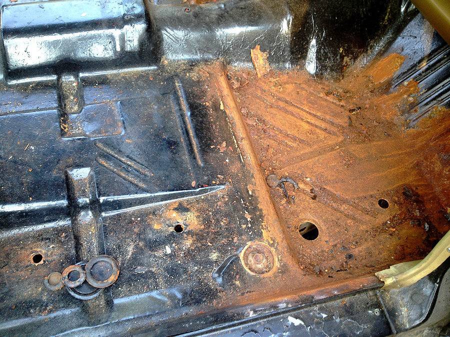

My job is to remove all the drain plugs from the floor pans, scrub out all the black paint and all the rust, then, eliminates all the rust until the good metal
After my plan is to sand all the floors, repatch holes (with fresh new sheetmetal and a MIG but I don't have one and I don't have time so I'll probably just repatch with fiberglass putty or other stuff until I can restore the entire car (or sell it, because I rarely keep a car)
After repatch, repaint with a good and thick black paint or a sort of "gravelguard" I don't know

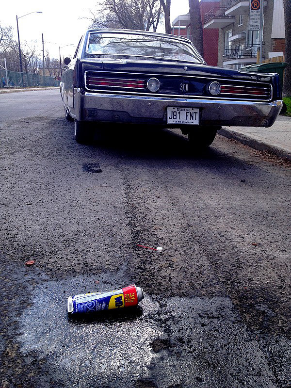

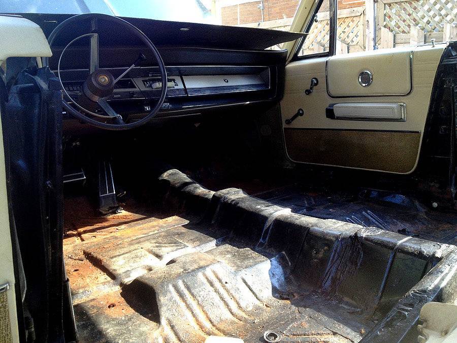

Before remove the old carpet I must remove the front bench seat, and the seat is fixed 4 nuts...below the car...
What a good ideal Mopar engineers, below the car, with the projections of mud, snow, water, calcium...
Surprinsingly my studs threads were good and the nuts were not so jammed so with a lot of WD40 a lot of patience I'd successfully removed all the 4 nuts (one broken but at least I'd removed it even though)
Brand new WD40 can : 0
Chrysler 300 : 1 :laughing4:

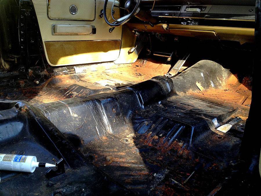

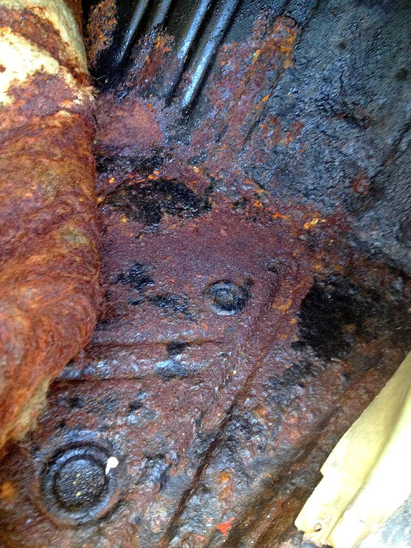

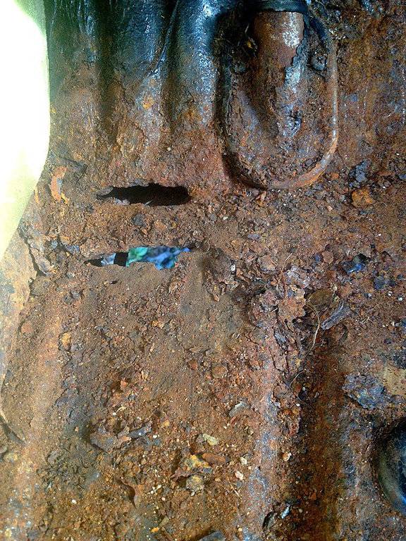

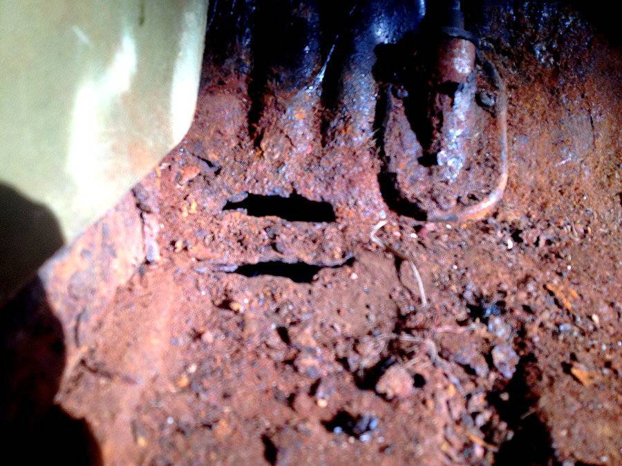

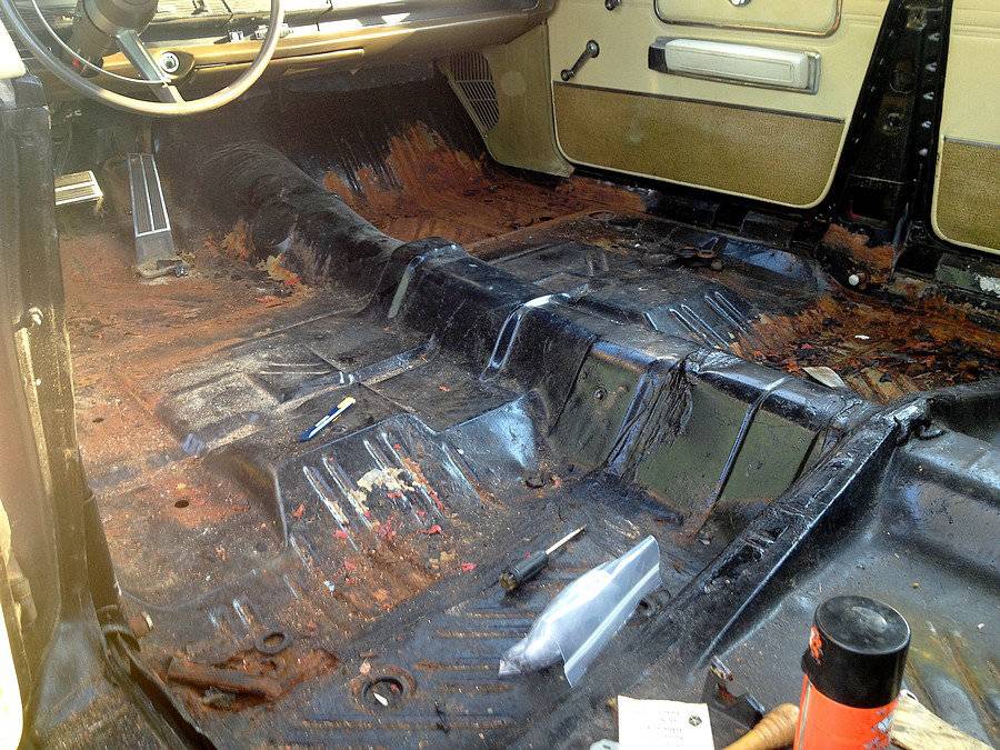

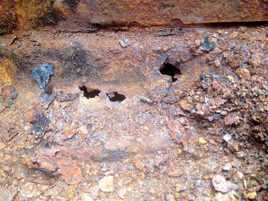

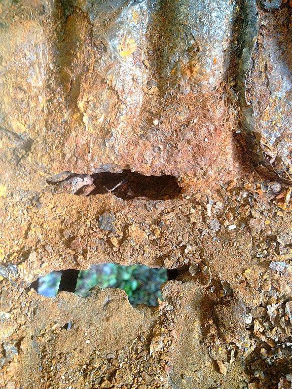

Now the truth about my floor pans...I've scrubbed a long time with a screwdriver and a trowel and open a couple of rust holes but not so big, the bigger ones are these ones, on the left front corner
Same thing on the right front corner, and a lot of places elsewhere but only little holes, maybe 1/4 to 1/2in each
The seat is out!
Before and after
The floor pans are in better shape than I was thinking!
There is a good amount of work but at least they are not completely rotten :)
Yoo see on the second to last pic all the crap (old primer and paint) I must peel off ahahah

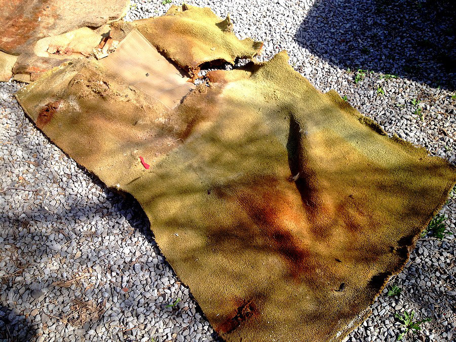

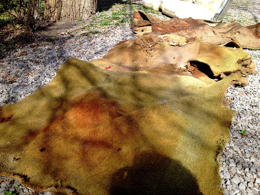

The front and rear original old carpets...they're definately scrap...
The question now is: what can I do?
http://www.ebay.ca/itm/1965-1968-Ch...id=100011&rk=1&rkt=1&sd=131505374330#shpCntId
I'd seen on eBay (and Summitracing I think) these new molded carpets ("licensed by Mopar"!), it seems really nice and the price is not so bad (210$ CAD) but all the fees seems to be terrible: shipping 40$, import charges 30$, Ohio sales taxes (I've never paid taxes on a eBay purchase...?) 7.25% so 15$...and shipping within 15 open days + 20-28 days for delivery...I could not receive the carpet before 1 or 1-1/2 month :BangHead:
Anyone here ever bought a carpet like this?

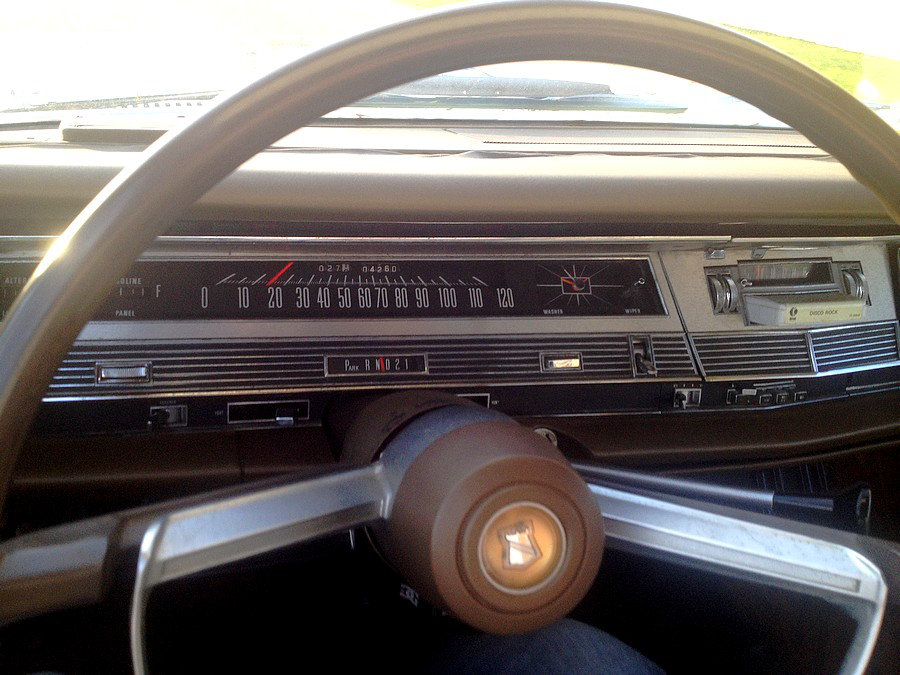

A random pic of the dashboard...I really love this old-school design with an enormous and deep steering wheel, long horizontal speedo, chrome switch (unlike the ugly round knob headlight switch of later models) for headlights and wipers, and the awesomely old-school half-moon horn ring...scuse this enthusiast, I'd never owned old '60s rides, my '70s Ford and GM does'nt had these "special features" :p (and my '71 Imperial not either)

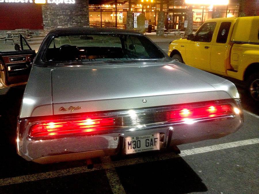

This pic was taken during my first ride with the car on the road, just after successfully and legally plated it, bypassing the provincial mechanical inspection (obligatory for a car that does'nt been plated for more than 1 year...and mine does'nt been plated since at least 10 years)

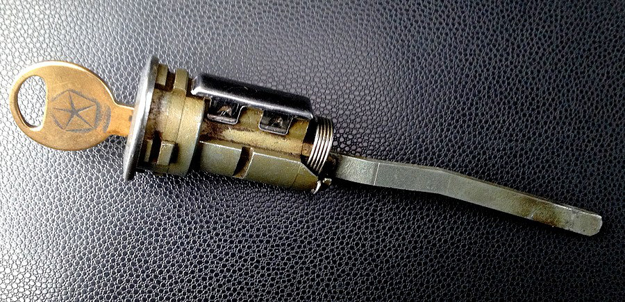

When I received the 300 the trunk was stucked, I've tried all the ways, never been able to open it with the key...
So since I'd removed the backseat I'd be able to "crawl" into the trunk by inside the car and unbolt the trunk latch by inside of the trunk...with the sun on the BLACK trunk door I was suffocating but it was a success, the door opened!
I'd bring the lock to the locksmith and for 30$ they refurbish it, I'd reinstall it and then it's working perfect :p

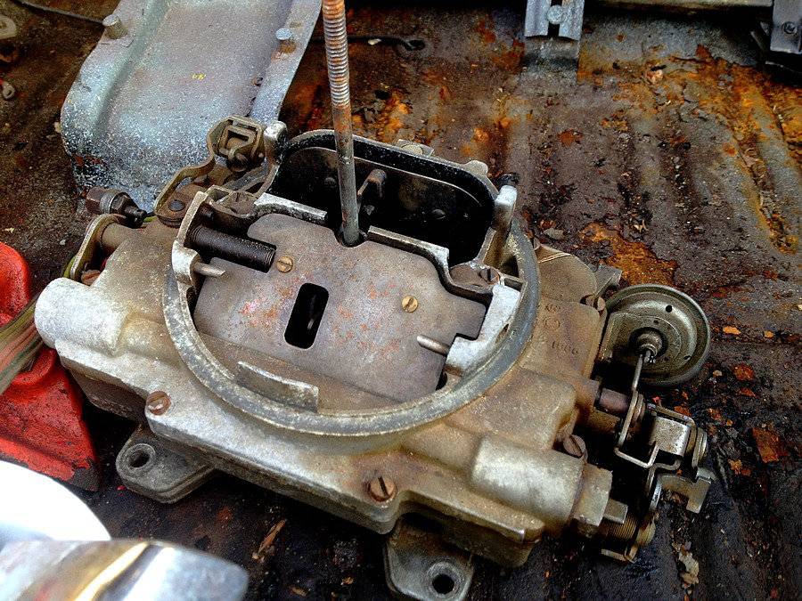

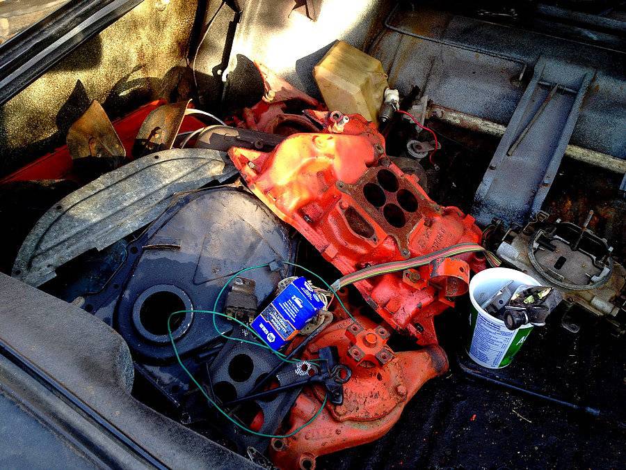

Like you'd seen I finally opened my trunk, and find a great stock of spare parts...intake manifold, exhaust manifolds, water pump, valve covers, fan, timing pan, window handles, wiper linkages and motor and a lot of gaskets and other parts...I'll show you them in details later
There is a carb too, I don't know the exact model I'd quickly check but does'nt found any number stamped on it

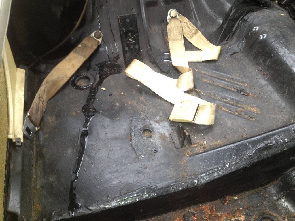

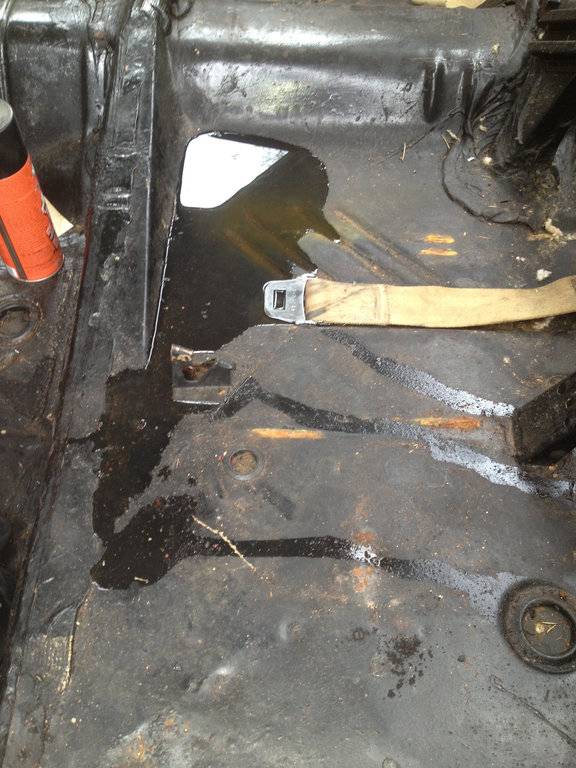

When it's raining (and after), I see that:
Right front floor
Right rear floor
Left rear floor :BangHead:
The water drops on the rear wheel archs into the trunk (at the bottom of the backglass) and runs down on the floor pans

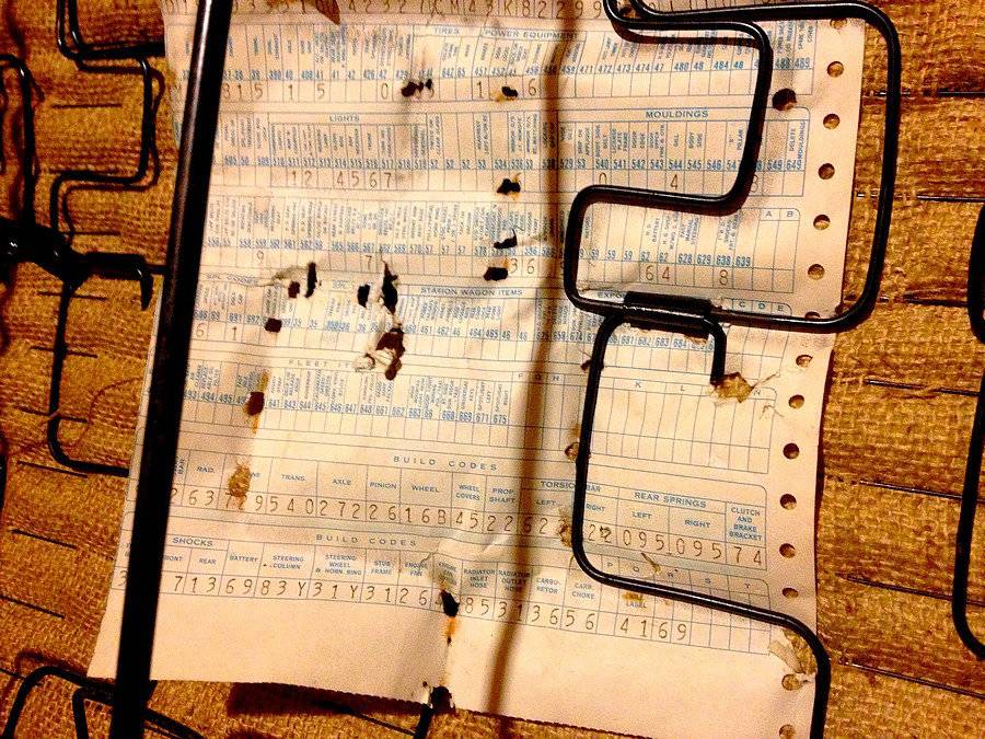

Funny fact: look out what I'd found below my front seat:
The original option sheet (or I don't know how you call it?) of the car!
