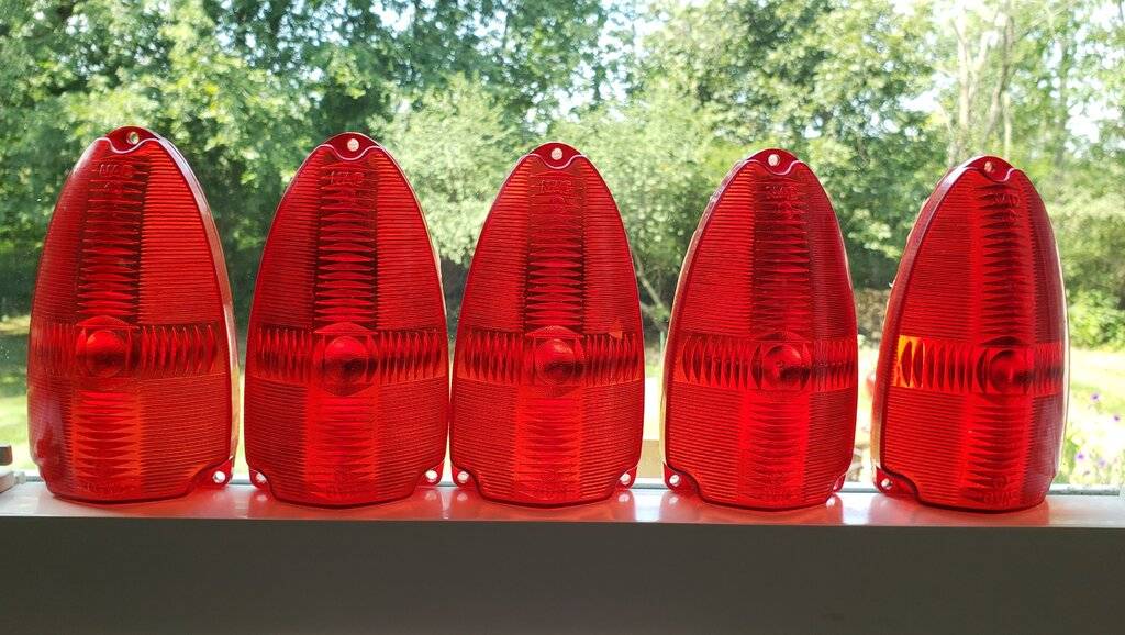

@pomonamissel has had great patience with me, and his 1960 Rambler lenses. I have finally achieved the end result I was looking for. The 5 lenses posted are the rejects.
It seemed everything that could go wrong happened, from burning thorough the clear coat several times and then waiting a week before the clear I was using to cure, so it could be buffed out.
I had my compressor crap out and then my products shelf life expired, which I didn't realize until after making 3 lenses with these mystery contaminants appearing. The contaminants ended up being a film which dried over the product, in the container.
It was all worth it. Many ideas on paper were eventually achieved and the next time I will be able to take a straight path to reach my goal.

They look good to me as is, but as they say. "Looks can be deceiving", what's wrong with them?
One is actually perfect but has a clear coat applied so not selling. 3 have a couple small particles. One has a slight wave which usually only happens when I don't heat my mold beforehand.
Generally, installed on the car, you really wouldn't notice the flaws unless you really inspected it. They all would be better than probably most of the orginal lenses which have clouded, the color is perfect.
