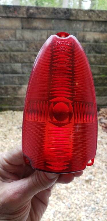

Very happy how the lens came out considering the condition of the original.

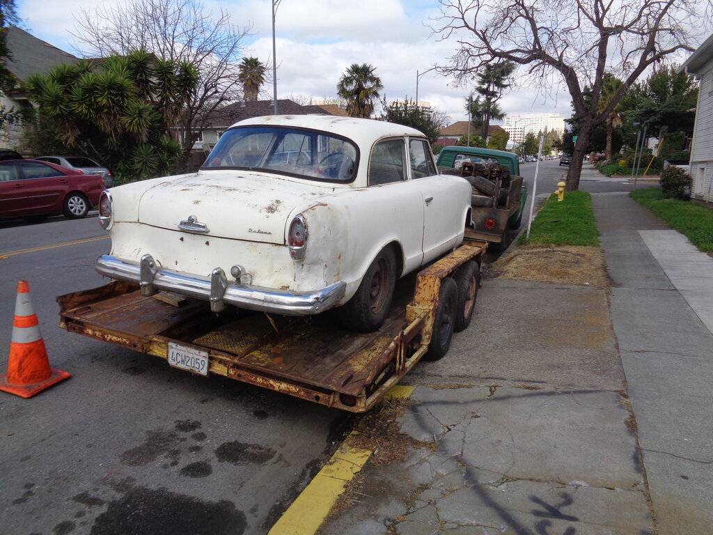

Z is doing a great job on these for me , and others that have a rambler lens need . lol ! this rumblur gasser will be a fun build , cutting on it will not even stop this vintage gasser project . unless someone wants it as is . its slated for a 440 or 383 4spd dana . here a pic wheels up , lol .

hey this is Z's first try , and he wants it better . what a craftsmen , he is smoothing out my lens for better castings , my hats off to him . if anyone needs a lens , here is the man for the job . he will be going my lens .

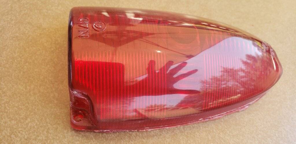

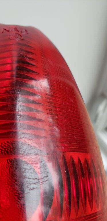

I think I have finally achieved the outcome I have been looking for. If there is a flaw in the lens which 1500 grit paper won't take out I can't buff the urethane resin to a mirror finish. I decided to clear the lens and then cut and buff and got a great result.
The first detail picture shows the scratches and the last the cleared lens buffed to a near perfect reflection of my hand.
