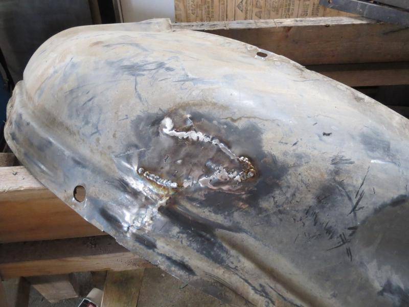

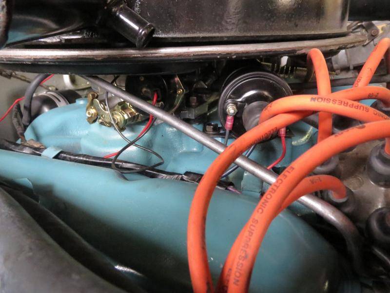

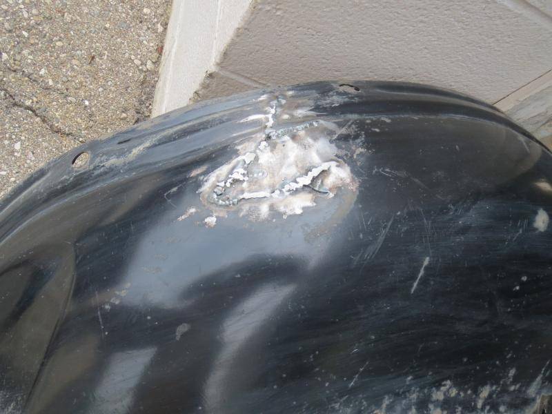

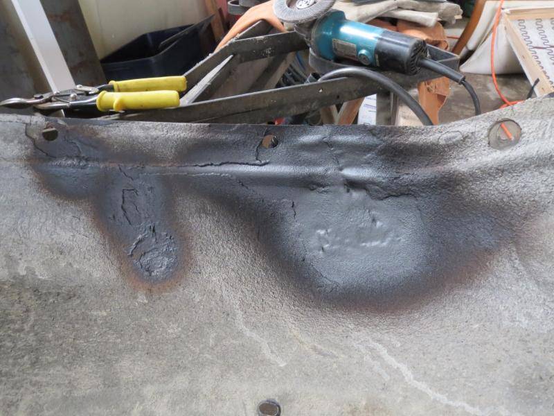

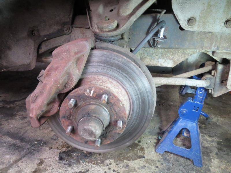

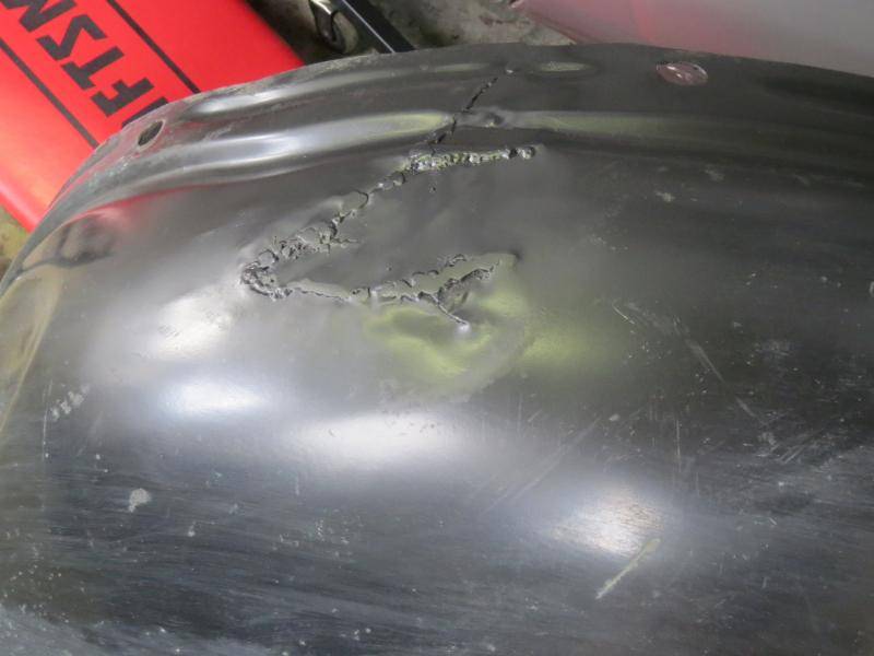

Spent some time today, continuing the love. I ordered brake hoses for the car and for those of you looking they're not easy to find for the front discs on a '67 Imp. Easier to find and within a quarter of an inch in length are those found on '66/'70 Phord broncos. Only had to wait one day from the local auto parts counter. Also welded up the one inner fender and began installing it but it appears that it'll require a little more tweaking because it put the kink back into the dogleg of the fender. Nothing is ever easy!

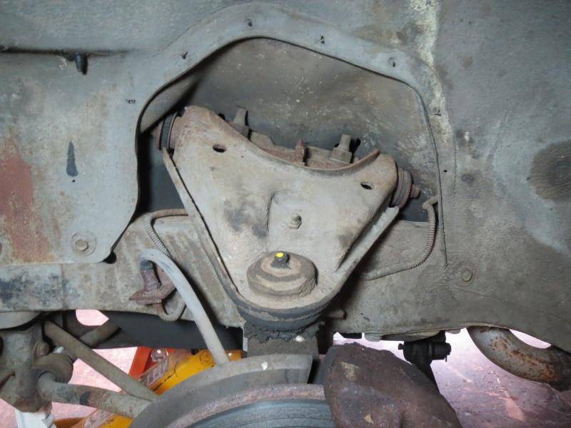

Matt, I don't like the looks of that. The kink in both lines are too sharp, That bracket even may be upside down.
Re-route the steel brake line so that it comes down from on top and the the flex brake line is under the bracket.
Thanks for the input Stan. The picture makes it look a little worse then it is. That's how it was originally and I never removed that bracket. In fact the new hoses are 1/4" longer. Here's a before shot.

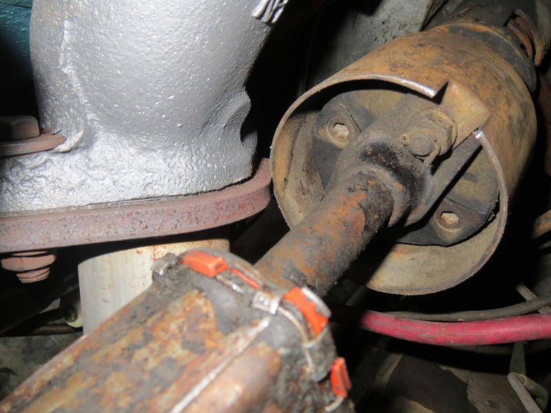

I have some encouraging news from the weekend, no game changers as far as Carlisle is concerned but I'm excited. First what I thought was a vacuum leak turned out to be coming from my power steering pump so that's a load off my mind. Even better but not confirmed is that the more the engine is run, the less the rear main is leaking. In fact, I had it running for a solid 20 minutes yesterday and it hardly dripped. It was suggested that I need to get it out for a drive and put a load on it before determining what the next step will be. With that in mind I finished putting the front brakes back together, bleed them, replumbed the carb with oem style steel lines from Innline Tube, retorqued the intake and put the wheels back on. It was nice to see it back on all fours. I then went to take it for a spin and found that somehow the exhaust flange is now rubbing hard on the heat shield over the joint on the steering column:BangHead:
