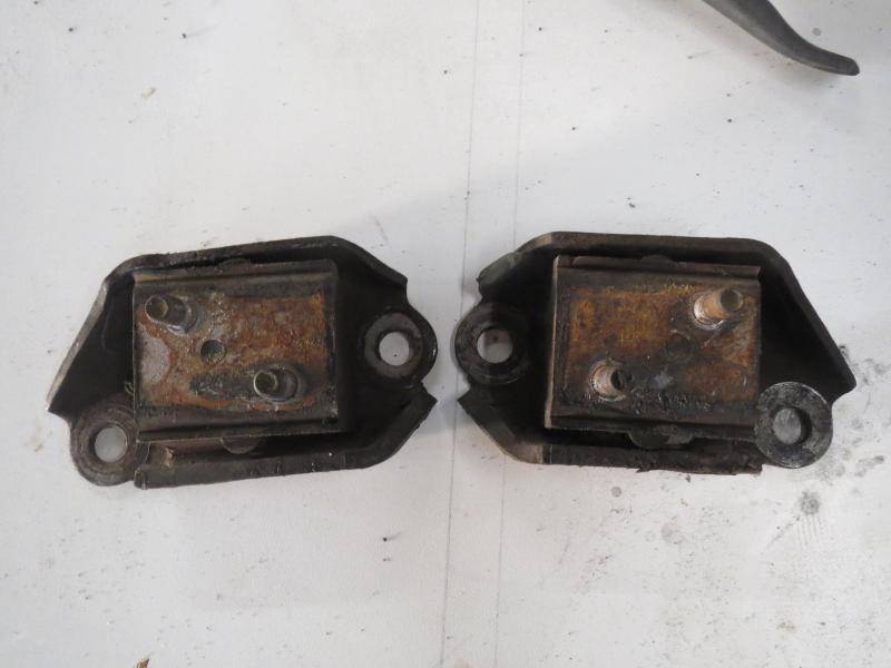

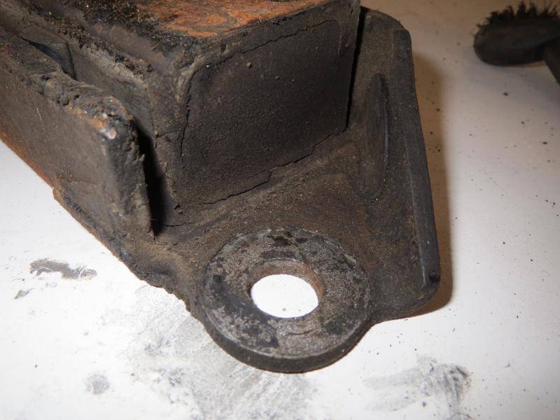

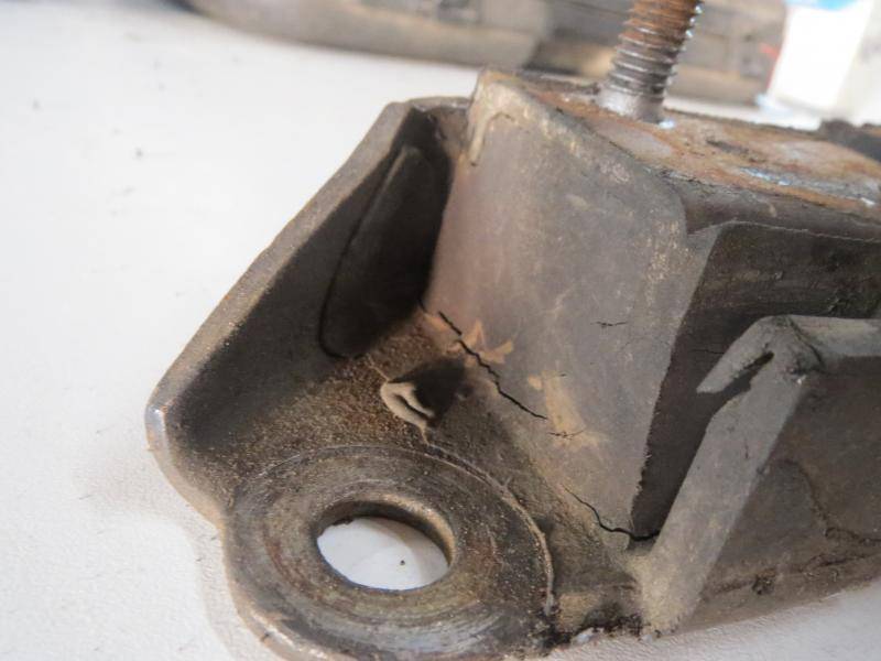

You're right Hemitheus, the season will be here before we know it and I have a couple of things that need to get done before it gets here. Most importantly the torsion bar isolators and the rebuild of the rear suspension. I took the time yesterday and removed the isolators and it went very smoothly. I had them out in less than two hours. I expected to see the driver's side in worse shape than it is as that side of the crossmember was sagging but they both are very soft and too flexible. I'll send them off this week and hope for a quick turn around.
