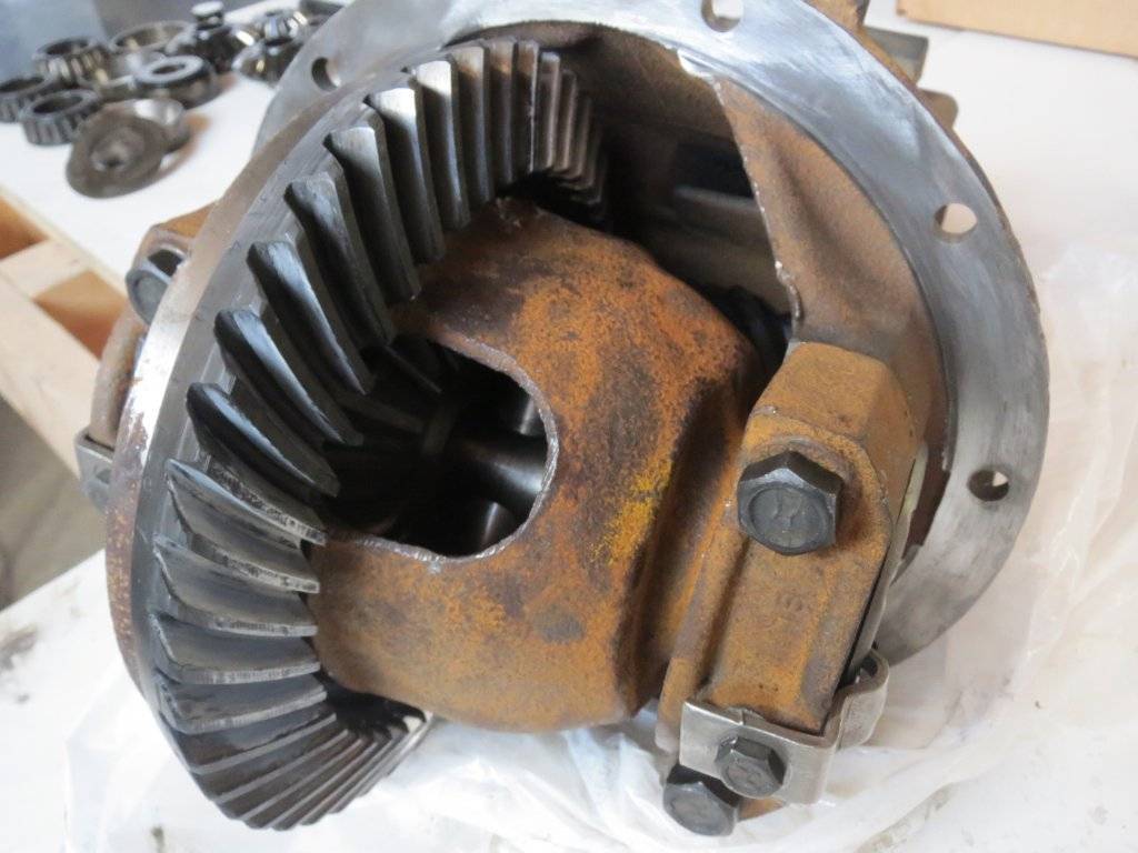

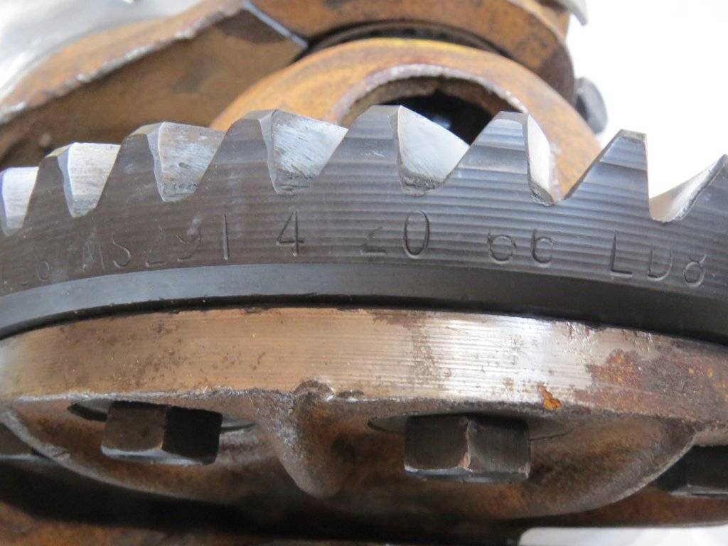

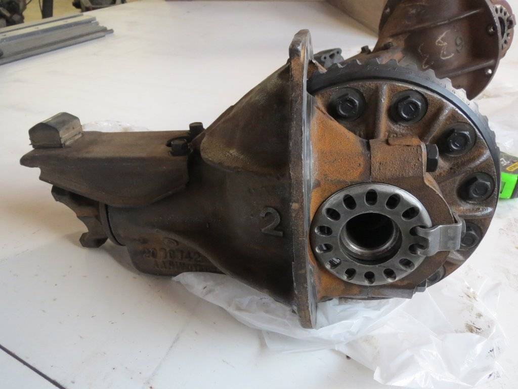

Here are the the worn out parts that were replaced. Turns out one of the bearings races had been spinning and the whole assembly was worn to the point that the spider gears had multiple wear patterns and that carrier couldn't even be reused. Luckily the rebuilder had replacement parts on hand and it's now good as new.
Didn't you say you had a sure grip for it?
I thought I did for a minute but the 489 3.23 SG that I have is a fine spline pinion so it just wasn't in the cards. I had that one gone through too and it'll end up in the vert shortly. The rear yoke is potentially Imperial only and is the coarse spline.
