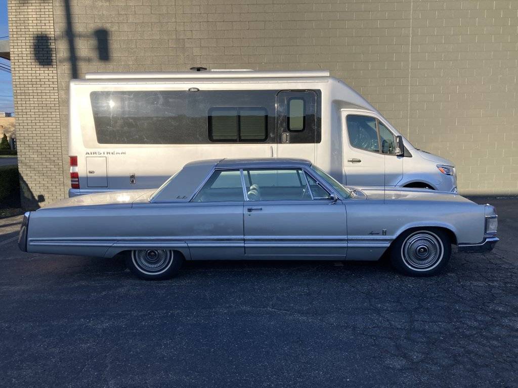

My new `67 Imperial Crown Coupe!

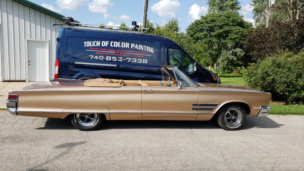

I installed that exact same setup on Jezebelle, (69 300), that I removed from a 69 300 parts car. Without the vacuum reservoir the engine has to be running to release the trunk latch.
And you really only get one pop after you turn the car off but it’s a very satisfying one.:D

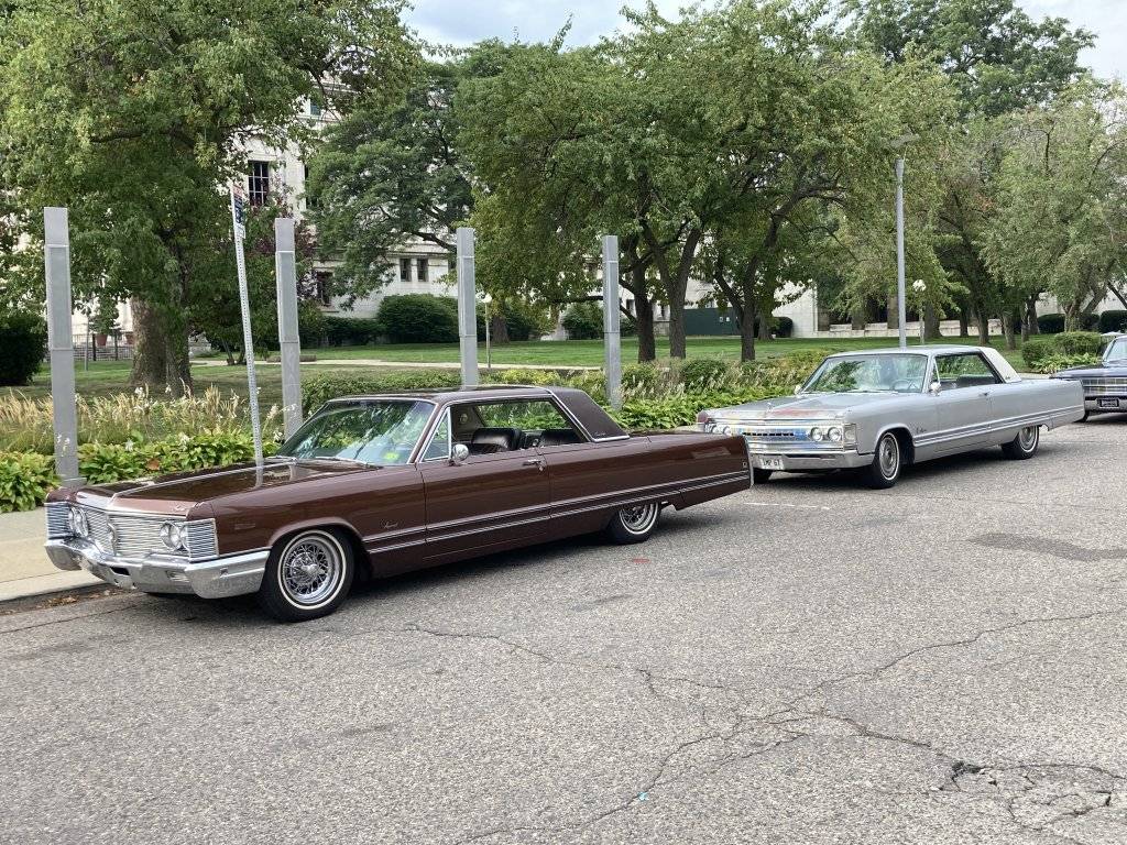

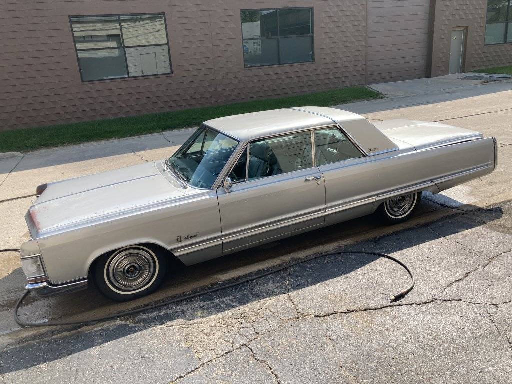

I finally got Imp #1 out of winter storage this year not 2 weeks ago as I have missed having it around and driving it. A friend tied in with the Detroit Historical Museum announced a companion show to this years Concours D’Elegance which was at the DIA across Woodward for its first time in Detroit proper. I thought it would be fun to have an Imperial there instead of the Challenger and I was not wrong. It was in great company with a friends beautiful ‘68. First off was a good cleaning and some detail work inside and out.(yes hose;)
We had a great day at both the Concours and the Historical Museum almost in the heart of downtown Detroit. :thumbsup:
