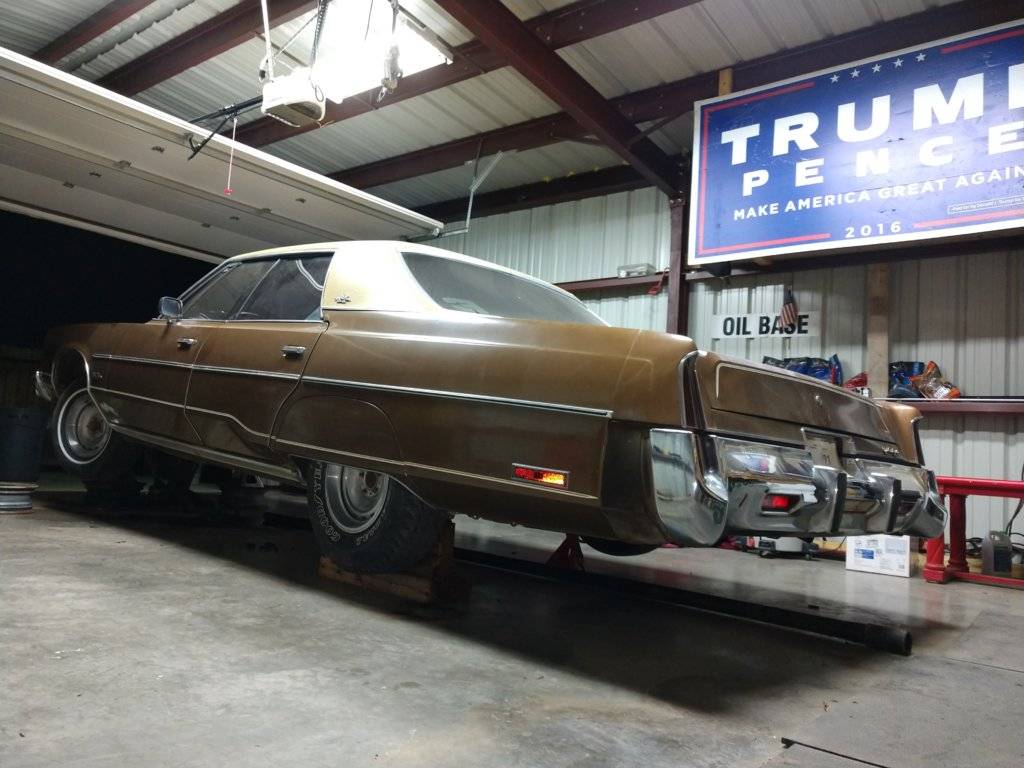

Picked this car up here in Texas on a trade deal. I'm guessing I have $800 in it I plan on driving it alot next Summer. I'm planning on swapping intake for a Eddie aluminum and swapping dis for hei. Also considering purchasing the Fitech system and installing it on the 440. I am the third owner I tracked down the pervious owner and he bought it in the early 90s. Only put a couple thousand miles on it when he had it. Any input would be appreciated thanks in advance .

Thank you is there any way I can clean out the tank? The front breaks are dragging jacked car up and can not roll the tires breaks dragging.

Replace the front brake hoses. The brake hose is collapsing and not releasing the brake fluid back into the master cylinder. I would replace the front calipers too if it was mine. I assume you planned on new pads and rotors.

The gas tank, if it is full of debris, will have to come out of the car to be cleaned. I would suggest running most of the fuel out of the car and removing the fuel tank sending unit. If the fuel pickup tube is badly rusted and the sock on the end of the tube is full of crud, that will be a good indicator as to the condition of the tank. You can also disconnect the fuel line to the carb and hook a piece of rubber fuel line into a capture container while cranking over the engine (Pull the coil wire so it does not start). If the fuel obtained in the container is discolored and smells bad, you probably are going to have tank issues.

You are going to need to rebuild both front calipers, replace the hoses as mentioned in the previous posts. In addition, I would suggest replacing or rebuilding the rear brake cylinders. As this car had a lengthy "rest" they are most likely rusted up. Be sure to also replace the rear brake hose. Carefully check the master cylinder for leakage also, any sign of leakage replace it as well. If your are going to do all of this, it would be a really good time to upgrade to DOT 5 brake fluid. This fluid eliminates most of the issues relating to corrosion in the braking system so you are not back in the same place four or five years down the road. DOT 5 works best when all of the brake system components are "new".
You will need to Mic and turn the front rotors if there is enough left of them. Wheel bearings will need to be inspected and packed if reused. Do not bother with the cheap Chinese bearing races that come in most new rotors, buy good ones from TRW. They are well worth the extra cost.
On a car that sat for this long, you should consider replacing all of the rubber fuel lines as they were not designed for today's oxygenated fuels which degrade the rubber in the hoses and cause leakage. There is also a high likely hood that the radiator and heater hoses are rotten as well.
Another item to check is your timing chain. Unhook the coil wire and turn the engine to TDC. Take off the distributor cap. Have a helper with a breaker bar and socket on the harmonic balancer nut rock the crankshaft forward and back. If there is more than 10-12 degrees of free play before the distributor rotor starts to move, the timing chain needs to be replaced. Doing this now will save you a lot of expensive grief later.
