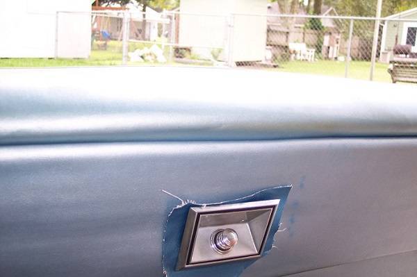

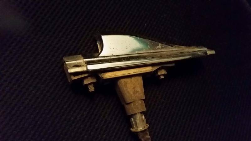

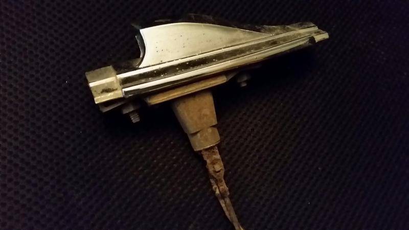

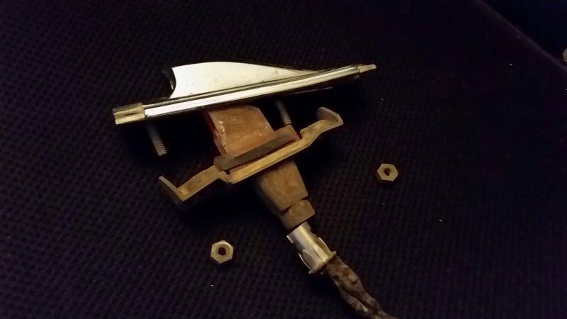

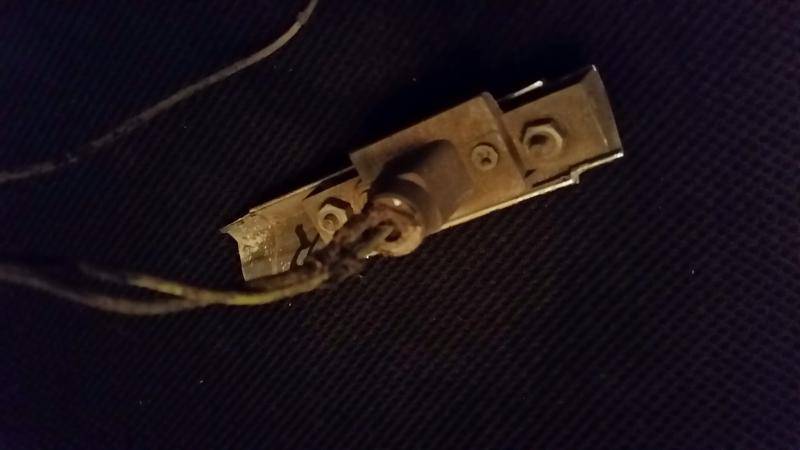

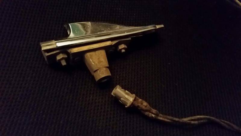

Regarding your fender/hood mount turn signals, here's an exploded view of one of mine. Not sure if '65 Chrysler is the same as my '66 Plymouth. I was able to save both of mine using some WD40, heat, and patience (oh, and vice grips). The lens on mine has a metal insert that has threads poking out of the plastic to which the socket threads onto. The small bulbs are still available online (#330).
![IMG_20140315_113633_949.jpg](/mopar-forum/proxy.php?image=https%3A%2F%2Flh6.googleusercontent.com%2F-5glI4ZUgVnU%2FUyShFYPUIvI%2FAAAAAAAAMI0%2Fa7BHINmpcvQ%2Fs800%2FIMG_20140315_113633_949.jpg&hash=d6dbe9c146b5b5cfdfba210308401b55)
