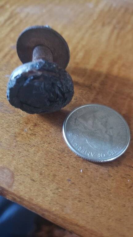

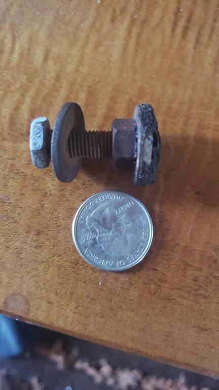

I found this just laying in my driveway under the engine!..wtf..can anybody tell me what this is, where it might be from?...the rubber is completely shot to hell.
Looks like it was some kind of bump-stop. I agree with the others, it doesn't look like a factory piece to me. Possibly an old universal replacement part.
