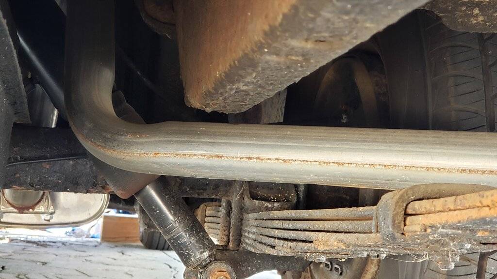

This is the right leaf spring. It is VERY different visually than the left one. To my eye, it's looks damaged or collapsed.
It does look funky.
They need to be replaced regardless. Weather they have 20 thousand or 200 thousand at 50 years old they and the rest of your suspension need to be replaced.

So I bounce tested the car. It's ridiculous:..I can push the entire rear end down about an inch with no force. If I rock it up and down, tbe car bounces (I'm not kidding) at least 6 inches. I feel prettt stupid, because I just assumed you know , old car..that's how they were......ooof.
I think the KYB's seem the best option .
Thanks again!
If the car will bounce 6", the air shocks have probably raised the rear end up enough to take most of the tension off the rear springs. This is not a good thing as now most of the rear vehicle weight is now on the frame cross member which is not designed for that purpose. Left that way the cross member will fail at some future date.
Dave
This is right leaf spring. It is VERY different visually than the right one. To my eye, it's looks damaged or collapsed.
Looks like the top leaf is broken under the pad mount for the rear end. You might also want to remove the clamps on that side and check the condition of the center bolt. A broken center bolt will cause the leaves to shift and not align properly. Most of the time if a center bolt has failed, the car will not track straight. Check the wheel base on both sides to see if they are both the same. (Center hub front to center hub rear) Most 440 equipped 300's had a 7 leaf spring set, not 6.
