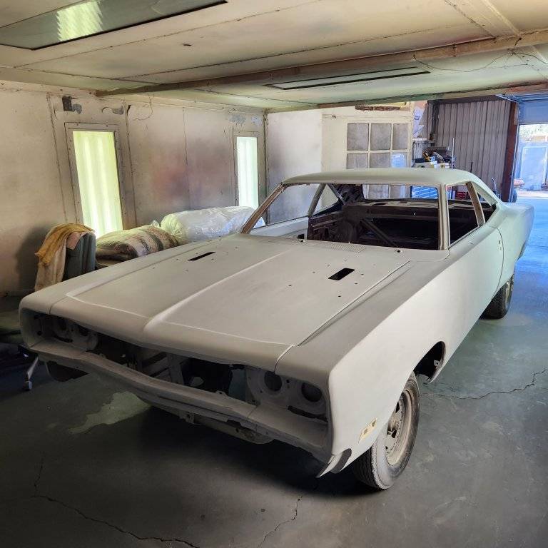

New project is a 69 Super Bee. Bodywork mostly done with a few spots to rework. Then all the prep and paint. Going to be the newer Mopar Octane red.

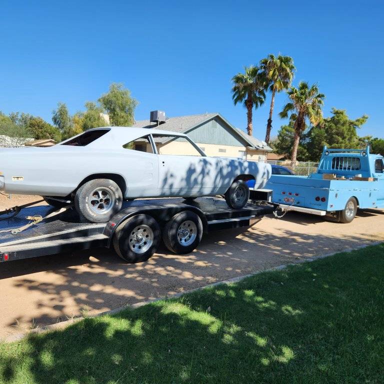

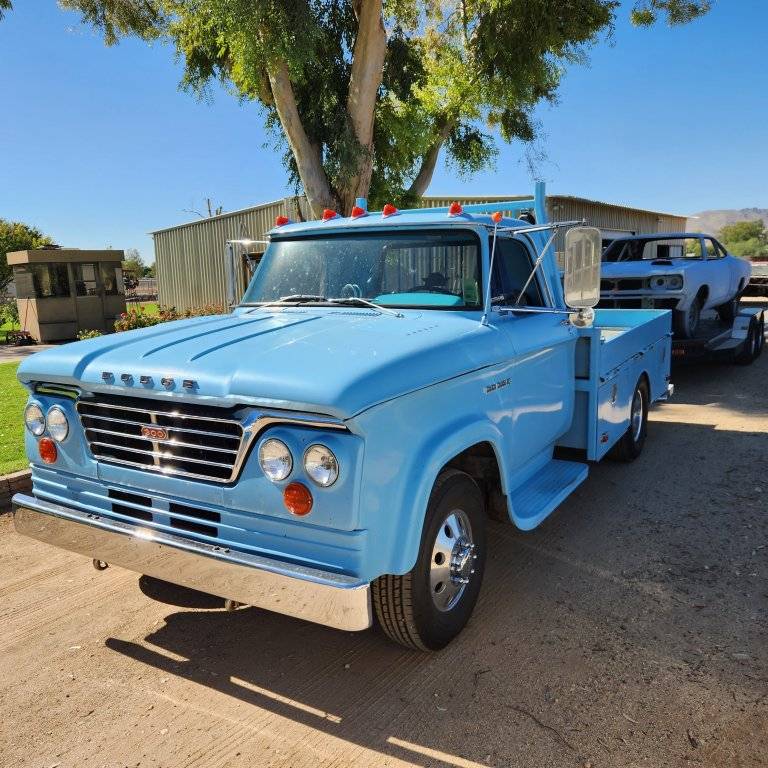

No that belongs to my buddy and the Bee is for one of his customers. The truck is affectionately known as the "Tun ner"
I'm not a fan of those grays but all the manufacturers offer them and you see a lot of them so I guess I'm in the minority.
Made some progress over the last few days. Fixed a couple minor imperfections, caulked some seams and the drip rails. Now it's in the booth ready for final primer.
