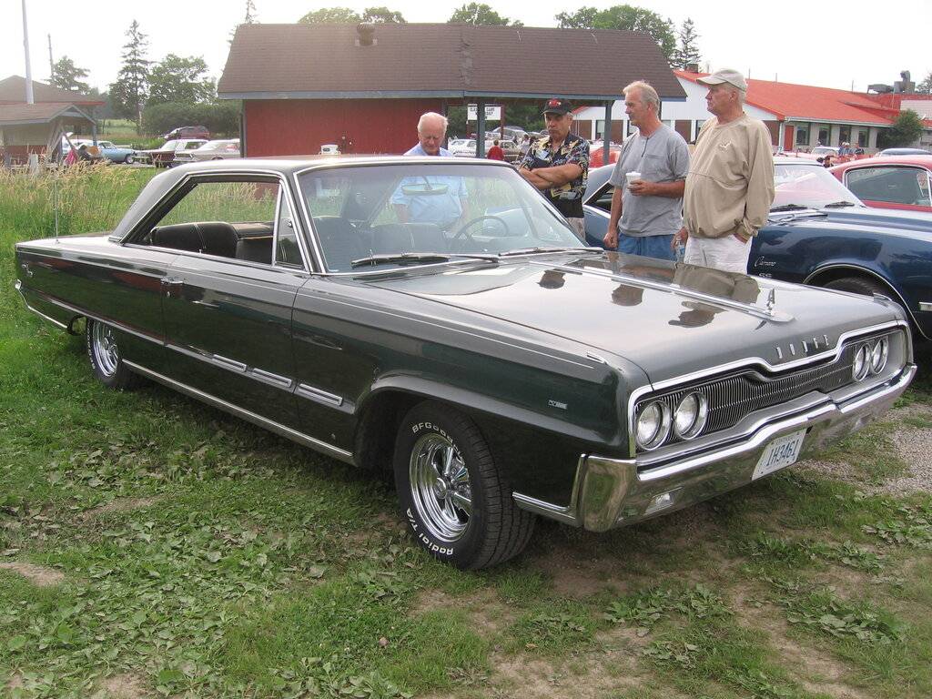

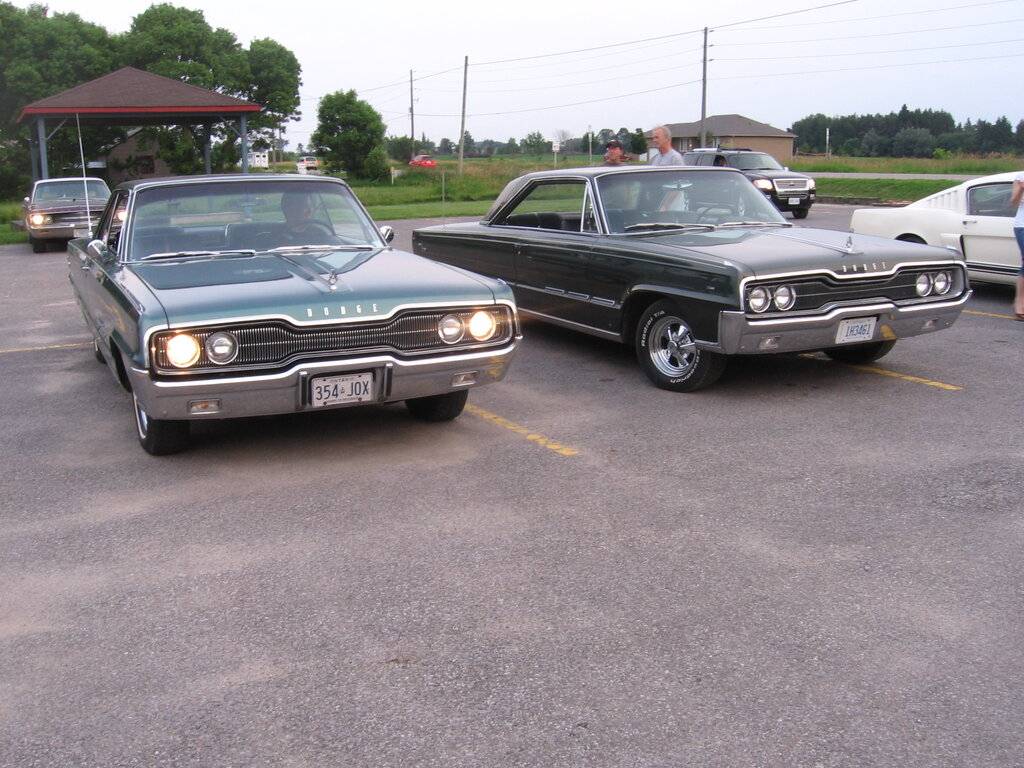

Its the norm up here in Canada..You know how long it took to finish my car and i did store many parts over the 12 years before final assembly,LOL!! Just a few pics that afre only the tip of the iceberg.

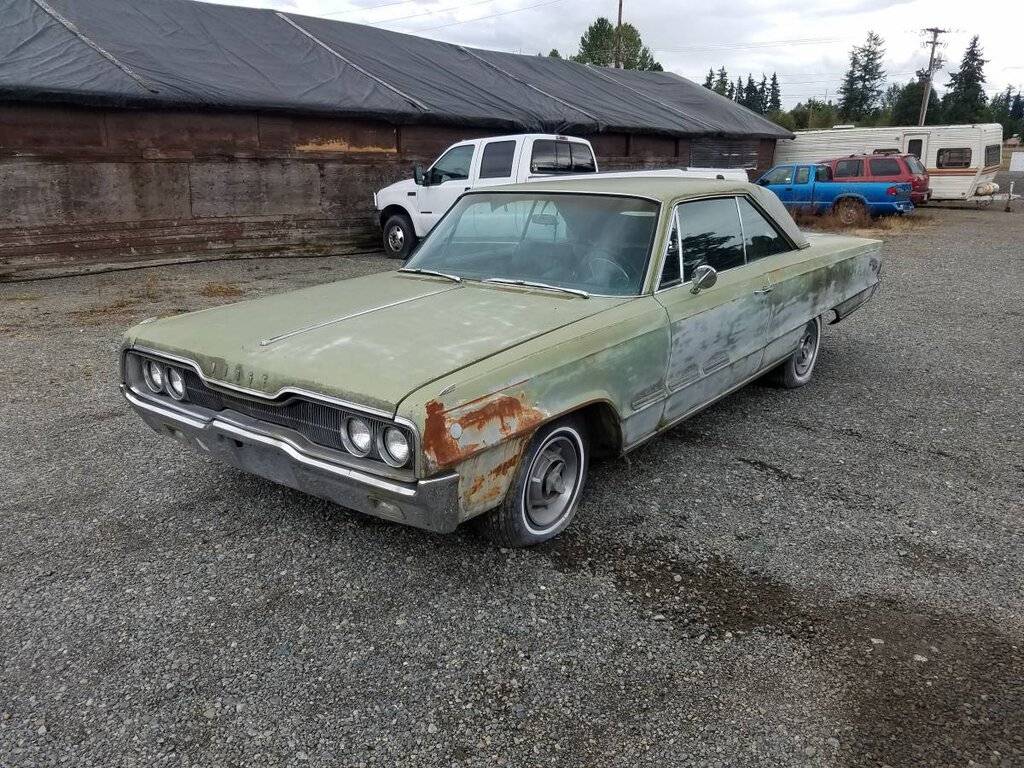

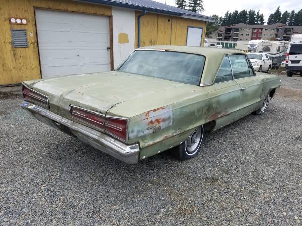

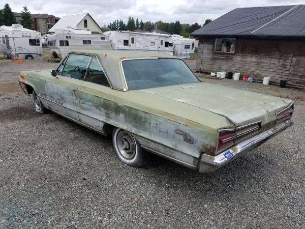

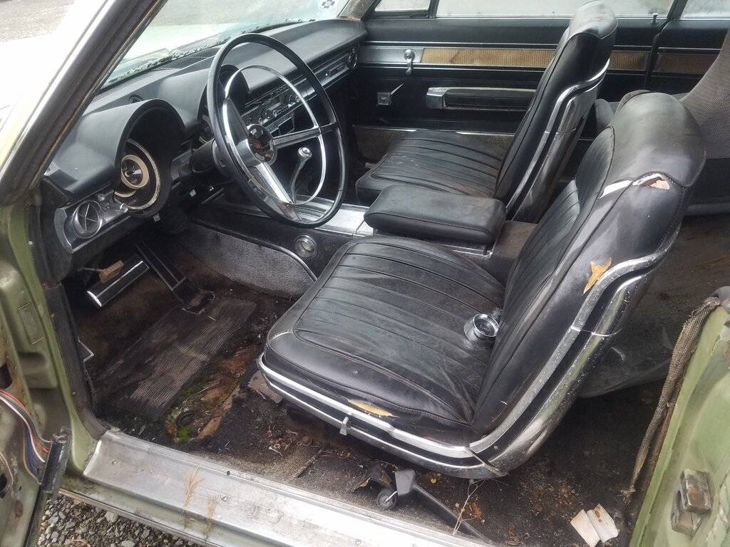

With the help of my main enabler, @boostedvan, I've secured a complete, solid Washington state car, a Monaco 500 in Seattle. (Wasn't I just there?) I have to wait a few weeks to arrange for transport, but I've got that all sorted out so when it's a go, I should have my car shortly after.
Too bad this car doesn't have a title, it's fairly complete, and it's exactly like the brochure ad that hooked me on the car I got in July '18, that has a white and black interior.
Pictures from the Craigslist ad.
Not having a title scared off anyone who looked at the car, which is good for me. It has parts for the 4 speed car, and a bunch of spares for the Monaco 500. I hate to cut up a good car, but unless it's better than what I have, and the one in storage has good quarters, this one will give it's life to at least two projects, and hopefully help others out with their needs.
Some pictures from the seller.

Hmmm... an AC equipped 4 speed car perhaps? You've got everything tk do it but the Fury AC dash (fairly easy to find)...
I ditch the air usually, but I'm keeping it with the Monaco 500 I already have. I'm sure I'll have the windows down in the 4 speed when I drive the car.

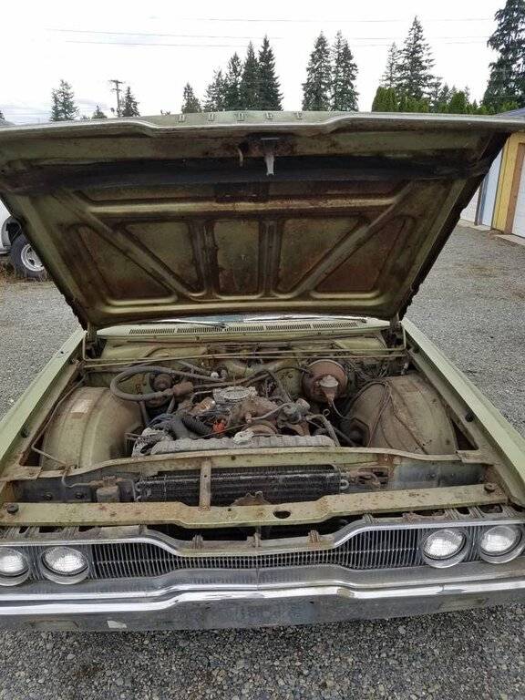

Just a couple of parts that aren't correct that I've noticed so far.
Radiator - it's got a 2898058 from a '68 C body 383 Auto. Needs a 2852959.
Carb - it's got a Carter 4131s, correct for '66 but for an Auto as well. I've already spoken to @Dana about the carb.
I'll crawl under the car later today and take the starter off to see the build date on the engine, and figure out that part of the equation. @Ripinator has an engine if needed.
