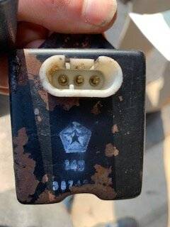

I need this part that is mounted on the passenger side of the firewall next to the ballister resistor. Does anyone know what is called?
Is there some operational problem associated with the item?
Just curious,
CBODY67
Is this part needed for car to run? The old one leaked
"Leaked" as in the potting compound sealing the circuit board leaked out? In that case, the "leak" probably will not affect its function in the short term, I suspect.

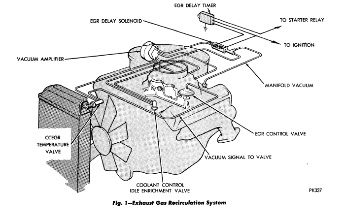

If the item is the EGR timer, it relates to the emission system. Don't specifically recall what its specific function might be, but if the EGR system is inoperative, for whatever reason, then its function would be minimized, I suspect. Might find more information on what it might do in the Chrysler MasterTech videos at www.mymopar.com, in the "What's New for 1978" sort of video course or one related to 1978 (or similar) emissions system upgrades.

Specific function is to prevent EGR from engaging during first ~35 seconds after start up if I'm not mistaken.
So the thermal vacuum switch (which opens after the coolant reaches a certain temperature) that runs the EGR vacuum was deleted? EGR is normally closed at base idle anyway. One more trick to get the emissions levels produced "to pass".

From my FSM:

The simple way is to remove the vacuum hose from the EGR valve and block the hose with a tight screw inside
The EGR valve will not open even if the controller still works
Put the hose back on and it all looks stock
