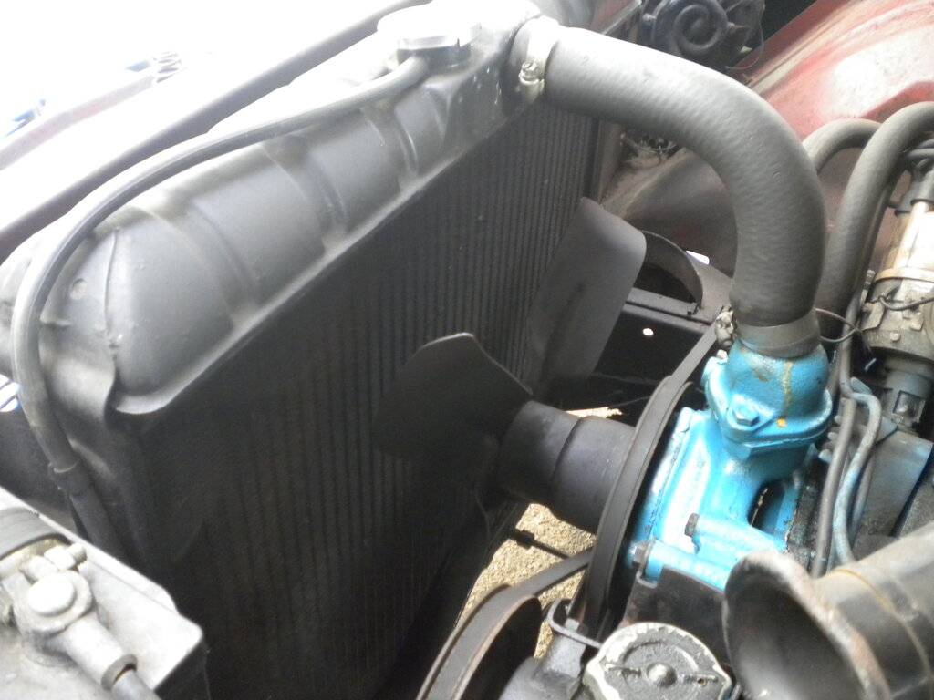

Next, from personal experience, the electric fans don't cut it. I'd use a plain old OEM fan with the HD fan clutch (I can't remember the part #) Would your car have a fan shroud? I'd also use a 160 degree thermostat. I know... I know... I get exactly how it works, I just have had better luck keeping the temps down when I start the cooling cycle a little earlier.
Next on the cooling side, does your car have ALL the assorted rubber "splash" shields in place? They serve a purpose of keeping the air channeled through the radiator at speed.

I don't have all the parts for the correct airflow. I only have the hood to radiator seal. I would need a shroud. My car did not. Come with it for it's year and the electric fan was already there. I do have the original mechanical fan, but no clutch. It's a straight bolt on.

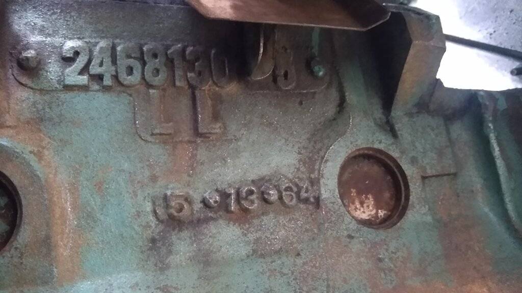

I found the other day when I was cleaning my starter and driver's side of the block... This is the original motor from 1964. So I'm really keen on keeping it clean and running right

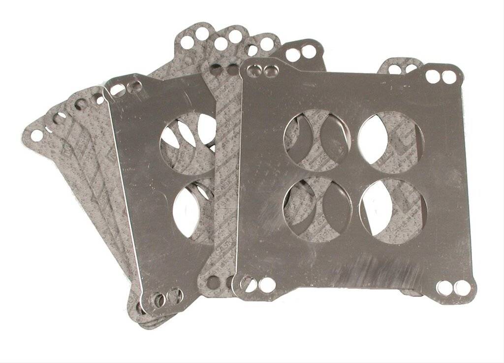

Thanks. I didn't think to check eBay. I bought a this one and one made from gasket material on Amazon. I'll see which one I like better and send back the other.
So I have a few options to go through and hopefully one of them will fix the issue. I think the heat shield and the intake pan that blocks the heat tunnels will be a massive help. From there.... I'll work on the cooling system.

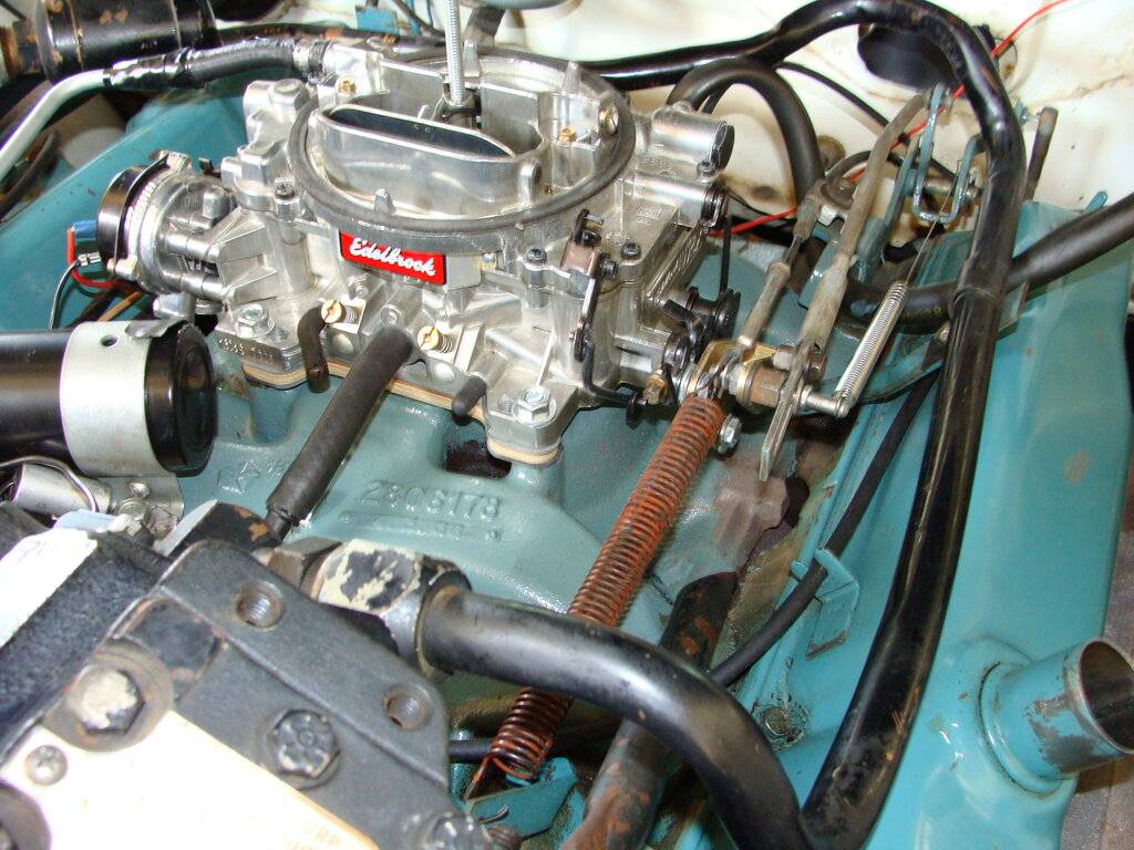

One other thing to consider: If the spacer you use is too thick, it will mess up the geometry of your choke linkage that runs from the well in the manifold to the lever that actuates the choke butterfly.
I was able to use the stock linage since I have an
electric choke

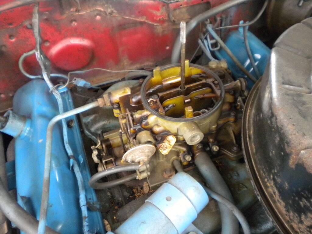

Yes. That avoids the problem, but he sez he wants to keep his AFB. . .
I'm trying like hell to keep the originality of the car, but new technology competing with 55 year old technology is challenging to say the least. I'll keep playing around with different setups, but if all else fails... Yeah, the Eddie carb will be sitting on my manifold.
I know what I'm doing definitely won't hurt the car, it's only a dry and warm weather driver now. But at some point, if nothing else works, I'll have to consider modern options. It's kind of embarrassing to pull into a parking lot for a night show, and stall out. Hard start...stall...hard start...etc
The 1/4" spacer should be fine. I had the CoolCarb plate on it which was closer to 1/2" and like you said... totally screwed up the choke linkage.

I have the new 1/8" carb gasket from Edlebrock, I'll be installing that next week as well as the Fel-pro pan that blocks the heat tubes.
