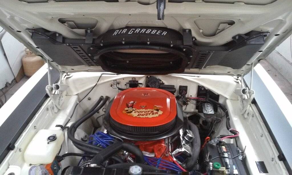

they made a insulation blanket that go's under the intake manifold to help insulate the carb you can see it under the intake. works great they use to come from the factory with them but they were rapped in aluminium and there ugly when they got oil on them so people throw them out but they worked to stop the heat getting to the carb

they made a insulation blanket that go's under the intake manifold to help insulate the carb you can see it under the intake. works great they use to come from the factory with them but they were rapped in aluminium and there ugly when they got oil on them so people throw them out but they worked to stop the heat getting to the carb View attachment 383949
The insulation pad is also there to help quiet engine noise. The valley pan amplifies the lifter noise, so the pad helps.
Main purpose of the pad was to reduce noise. Heat riser passage is above the insulation pad so it's value for controlling heat is questionable.
good comment.
I remember gingerly removing these, cleaning them then re-installing since they weren't available from the dealerships even back in the 80's when I could still pull wrenches full time.
