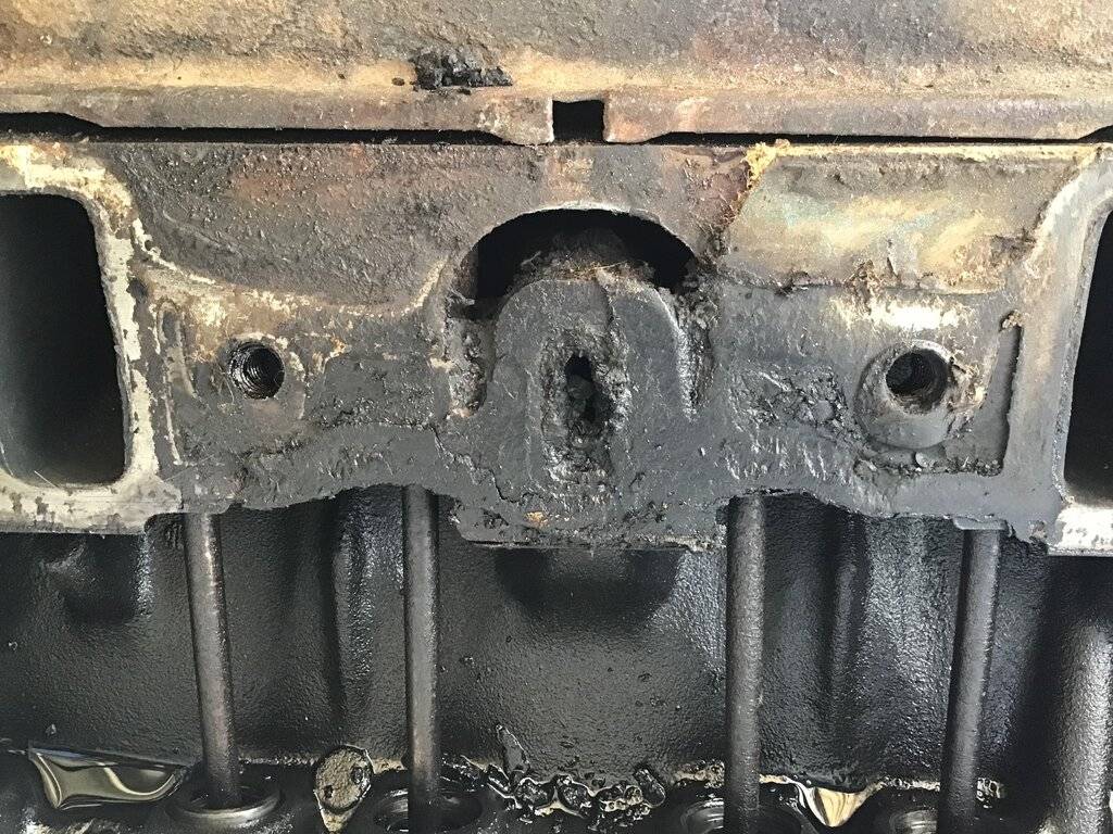

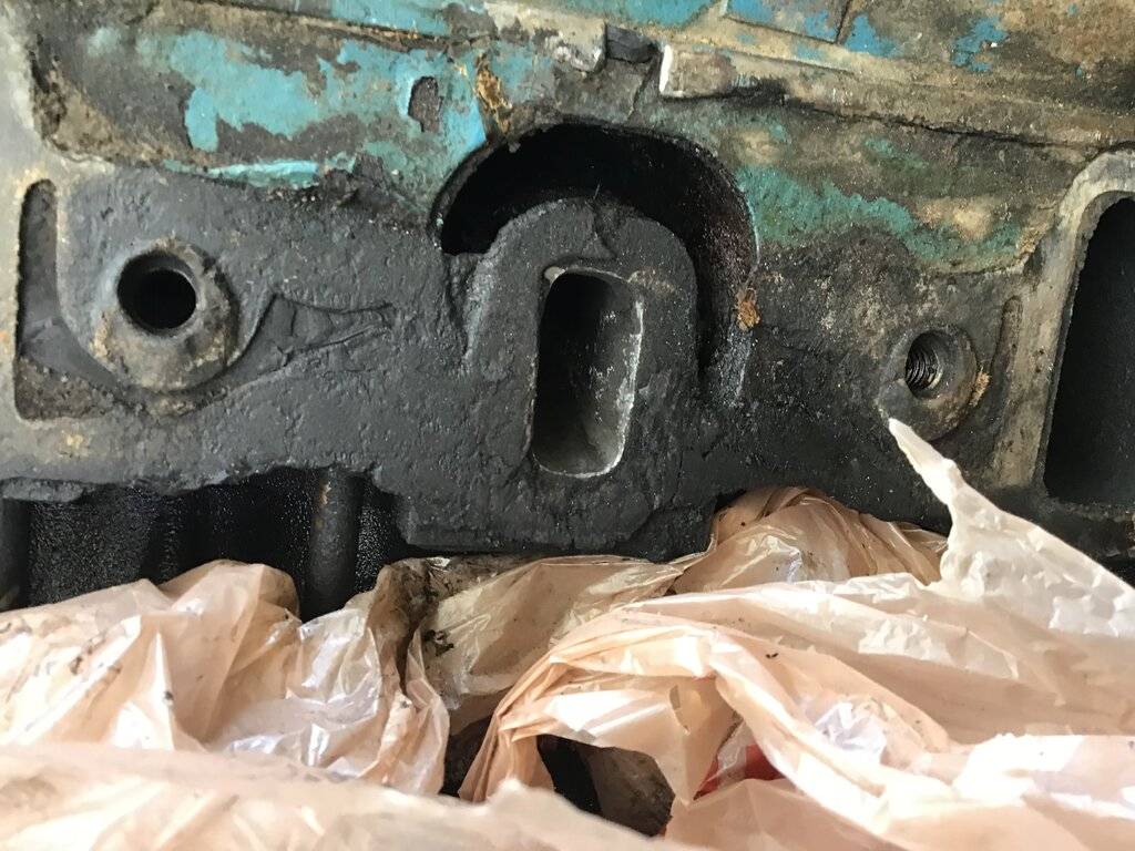

Back in the 1970s, the local dealer had sold many 273 2bbl Belvederes to some elderly ladies. A nice car that met their needs. The only problem was that they only drove them short distances in-town, which meant they usually stayed low-speed most of the time, which also meant short trips where the automatic choke seldom would get fully "off". The result? Coked-up exhaust heat passages as shown. The fix, at that time, was to remove the intake manifold and chissel the accumulation out so the heat crossover would flow hot exhaust again, which also meant the choke would open again. Never had that issue with a B/RB engines as they usually ran hotter, so no similar issues.
