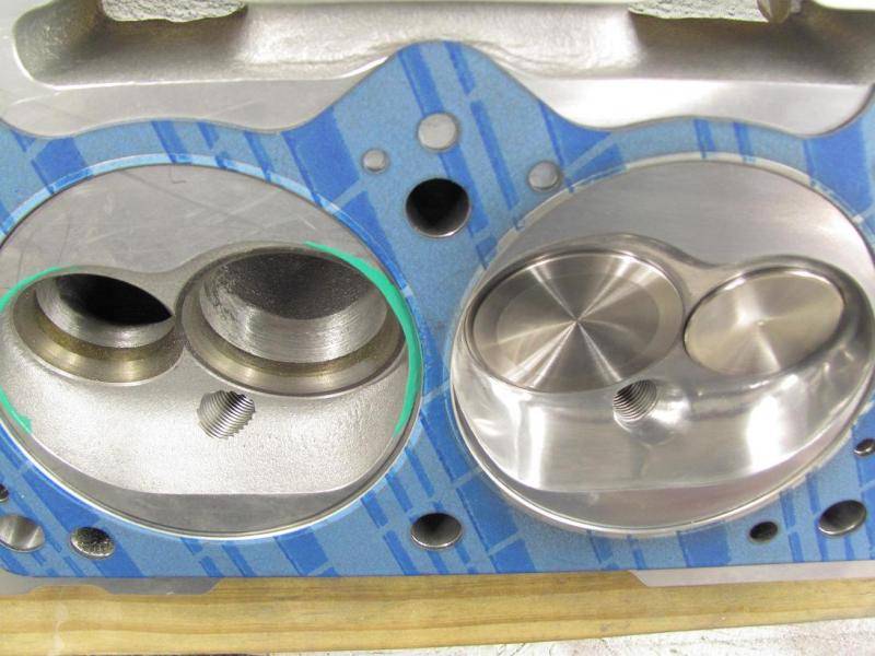

Here's the last project that I have been doing after work, deshrouding sparkplug holes and valves, polishing chambers, and porting the exhaust on a new set of aluminum Mopar LA heads... The chamber finish work on these is really hard on your fingers... 6 hours of hand sanding with 400 and polishing with compound per head after the die grinder work was already done.

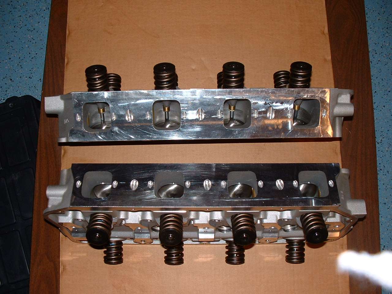

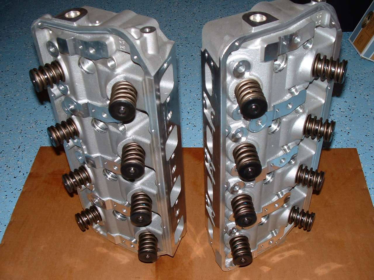

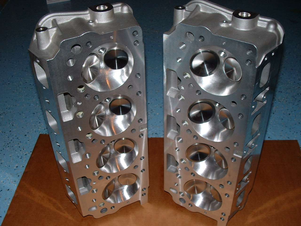

this winter I gonne rebuild the engine. Put it all apart and check everything and switch to a flat tapped camshaft from Ray Bartons, new heads, improved heads from Indy. In addition to that I will do a couple other things: new torque converter ( I think the old one didnt survive this summer) check the transmission, new and bigger fuel lines, msd ignition etc.
This the text from the ebay auction. I think they will go much better then my Edelbrock Alu Heads. I hope. :)
BRAND NEW HIGH FLOW ALUMINUM 426 HEMI HEADS. THESE ARE EXTREMELY HIGH QUALITY CASTINGS AND HAVE TOP NOTCH MACHINE WORK. HIGH FLOW VALVE JOB AND VALVES. BIG INTAKE VALVE 2.40 !!!! WITH STOCK 1.94 EXHAUST, BUT STILL HAVE LIGHT WEIGHT 5/16 STOCK HEMI VALVE STEMS!!! FULLY ASSEMBLED FOR FLAT TAPPET CAMS UP TO .640 LIFT. VITON SEALS. THESE ARE INDY / CANFIELD DESIGN. WATER HEADS FOR STREET / STRIP. NICE THICK DECK AND PORTS. THESE ARE RATED AT 450 CFM INTAKE AT HIGH LIFT. THE 2.4 INTAKE VALVE AND INCREASED INTAKE AND EXHAUST PORT VOLUME WILL WAKE ANY HEMI AND WILL REALLY WAKE UP A STROKER!!!!COMPATIBLE WITH ALL STOCK HEMI INTAKES, EXHAUST, ROCKERS, STANDS, BLOCKS AND GASKETS. THESE LOOK SIMILAR TO STOCK EXTERNALLY!! SEE MY OTHER AUCTION FOR ROCKERS. THESE HEADS ARE BRAND NEW AND PERFECT. FLAT RATE SHIPPING $70 ANYWHERE IN THE USA - DO YOU HAVE QUESTIONS ABOUT HEMI ENGINES? I HAVE ANSWERS. THANKS
Intake Port Volume on these big valve heads= 266 cc's
Stock Mopar Hemi aluminum= only 185 cc's
The extra port volume is needed to get the flow numbers up at all engine speeds & valve lift. By comparison a small block Mopar has 170cc intake runners & a small block Ford has 200cc intake runners.
