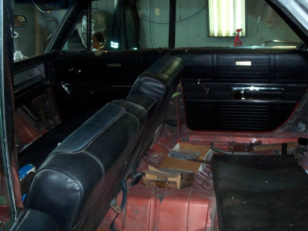

With some help from my Brudder Crazy Don, we pulled the front seat out to replace the broken seat frame studs
I actually scored a working power bench assembly a few years back and that will be installed before the seat goes back into the car.
Amazingly the seat itself is in great shape,just needs a good cleaning.

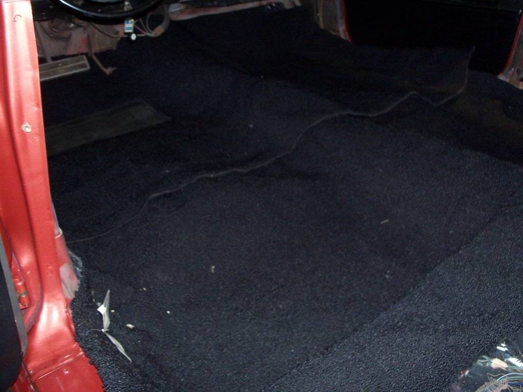

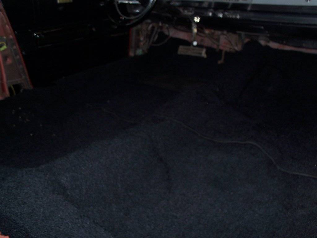

I bought this carpet set maybe ten years ago???
It was nice to put in the car!! (Ya I tested it when I bought it,but not the same feeling,eh? LOL)
For now I will let it settle in place.
The final install will include seat belt holes,some trimming,and remove the gas pedal bracket to get the front carpet up where it should be.

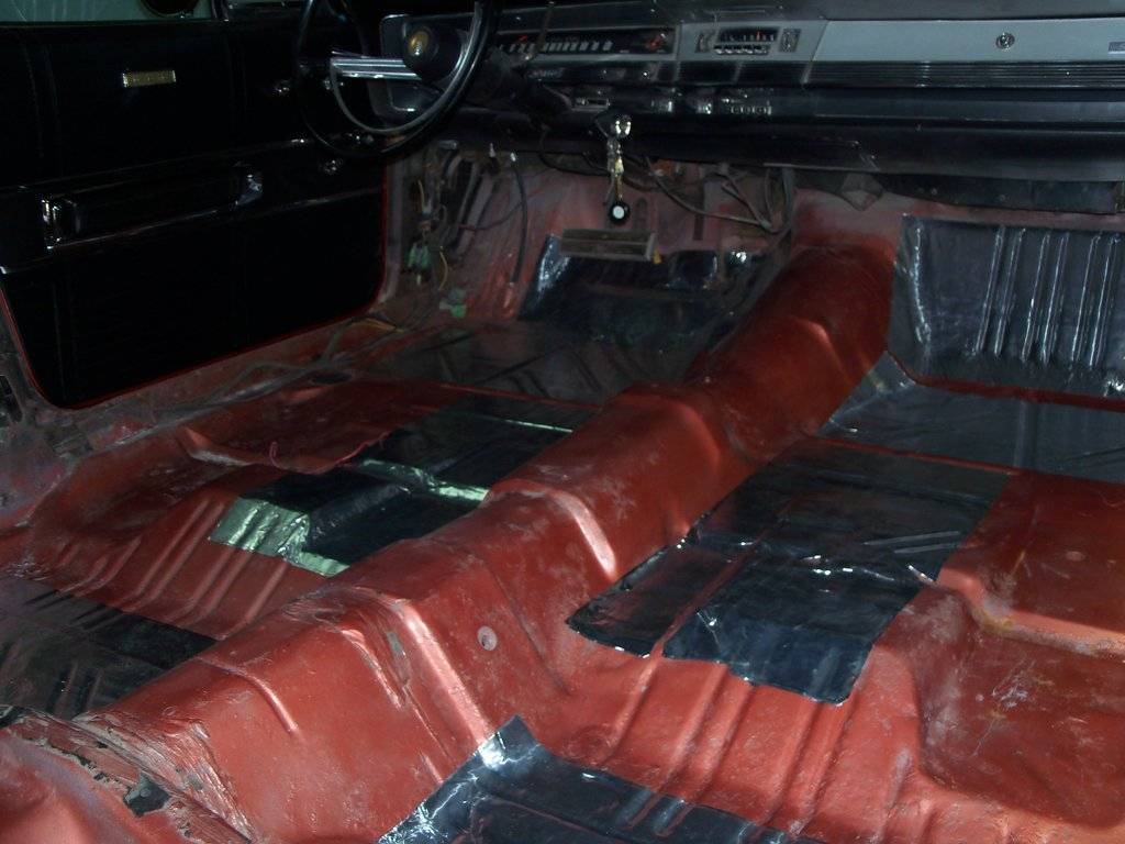

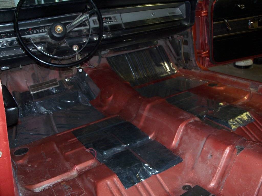

View attachment 137202 Cleaned/prepped the floors and then installed the Boom mats.
I've seen that Dynamat stuff at shows and they want a boatload of $$$ for it. Other than the shiny foil I don't see much difference between it and Iceshield rubber roofing underlay and you can do several cars for the price of one Dynamat job.

One of the perks of my job of 17 years is I get stuff/parts at staff cost. So the Boom Mat was cheap since the warehouse was clearing it out and since stopped carrying it.

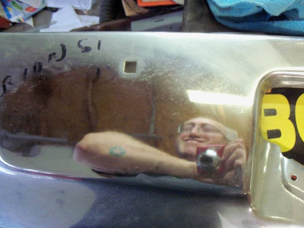

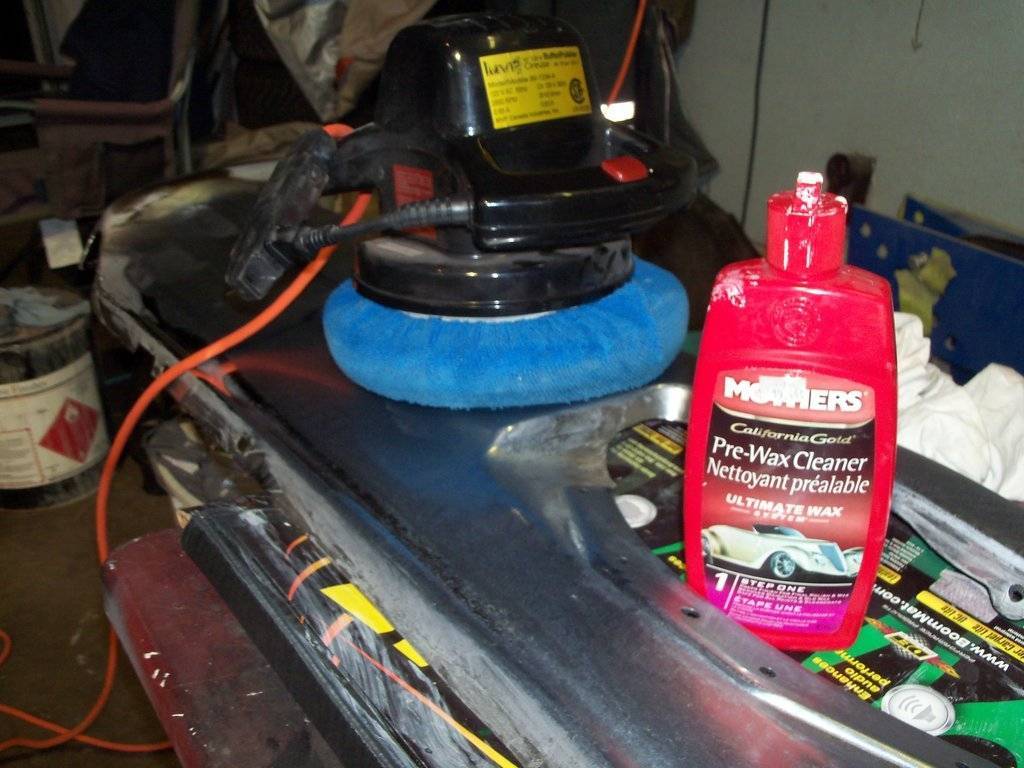

Using gun wash and old rag,I wiped down the chrome.
Found an old orbital polisher and pad and used a pre-wax cleaner to get rid of the residue over spray and permanent marker.
After that I used a chrome polish and buffed with a wool drill bit attachment.
Good as new!

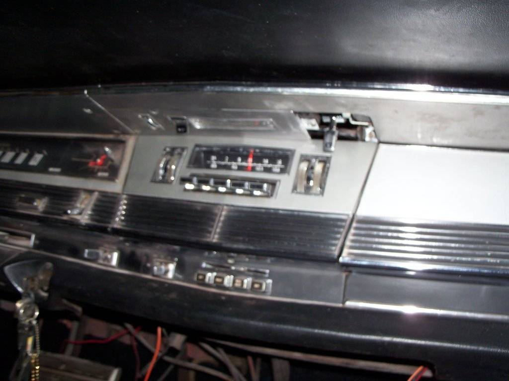

Installed the rare Reverb system today,along with the working used AM/FM thumbwheel radio. Since I was in the dash,I installed my NOS radio face plate,fader button,and map light.
The NOS totes are getting lighter!!
