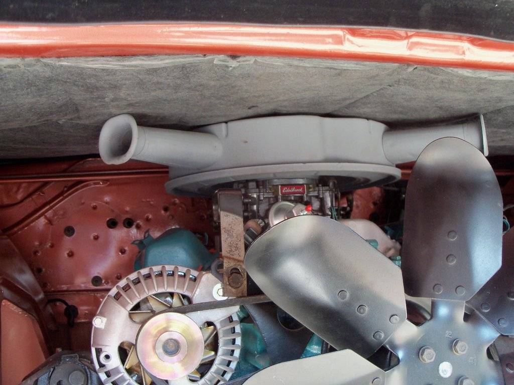

pulled the cast iron 4bbll intake and mocked up the carb,intake and air cleaner.
Yeah a wee bit tight with millimeters to spare!!
