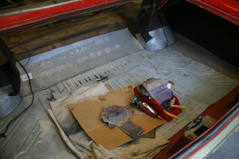

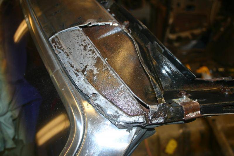

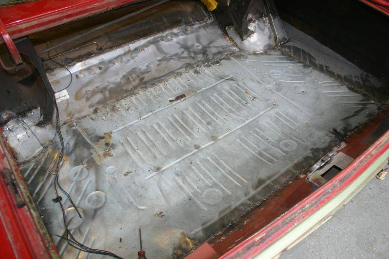

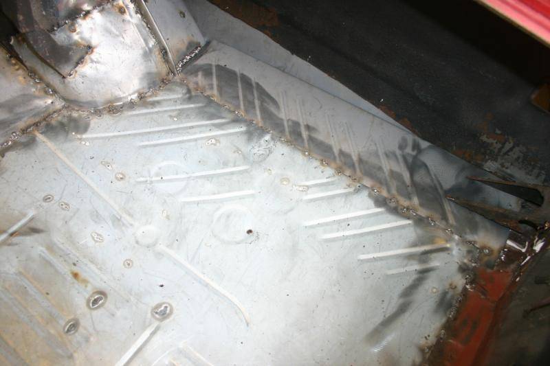

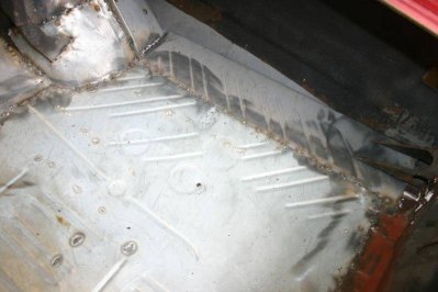

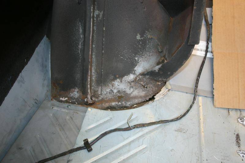

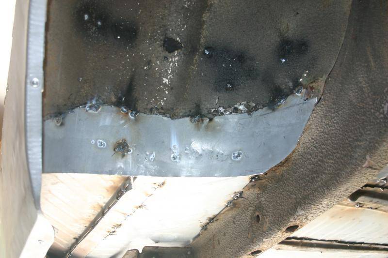

Getting the new trunk floor fab'd in. There are some small holes in the interior floor that we will use a product called Marine Tex on. That is a 2 part epoxy that is really strong. There is a bad rusted place where the rear convertible top support meets up with the pass inner fender. That is going to need some metal replacement. IMG_6255.jpgIMG_6261.jpgIMG_6262.jpgIMG_6263.jpg

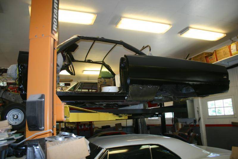

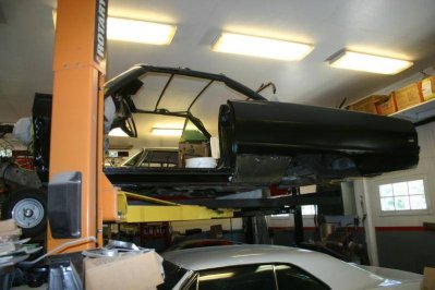

Just about done with the trunk pan and extensions. Moving onto some issues with the metal around the convertible top and the trunk lip and quarter patches. We are going to chemically strip what paint is left (the front fenders, doors, hood and trunk have been chemically dipped). MikeIMG_6272.jpgIMG_6273.jpgIMG_6274.jpgIMG_6277.jpgIMG_6278.jpg

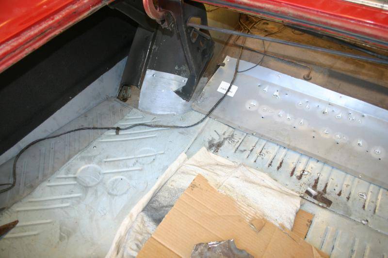

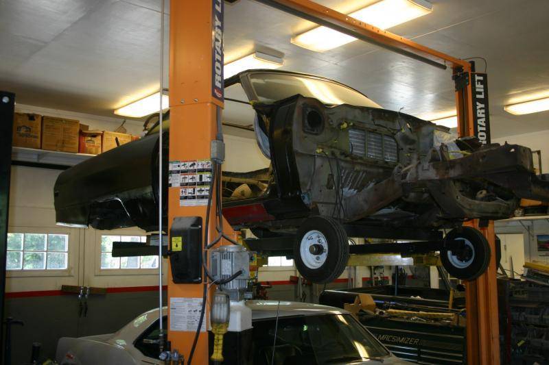

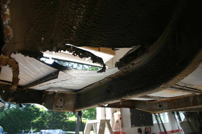

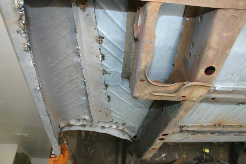

I have been tied up on some other projects (I am including a picture of a '63 Ford Fairlane we have been working on; the frame was done by another guy, we have been working on the body) but am now back on the '69 Fury. Got the floor patches welded in and the trunk floor and extensions fitted. Going to blast up underneath and in the trunk before welding in the trunk.
Great work on the floor pans and the trunk! Did you made the floor pans yourself or did you bought them? If you bought them, can you tell me where please!?
Look back on page 3 of this thread. The name of the ebay vendor is there. Everything fit good except the trunk extensions. those are made to fit many Chry/Ply/Dodge models and we had to modify them pretty good. However, they were better than having nothing.

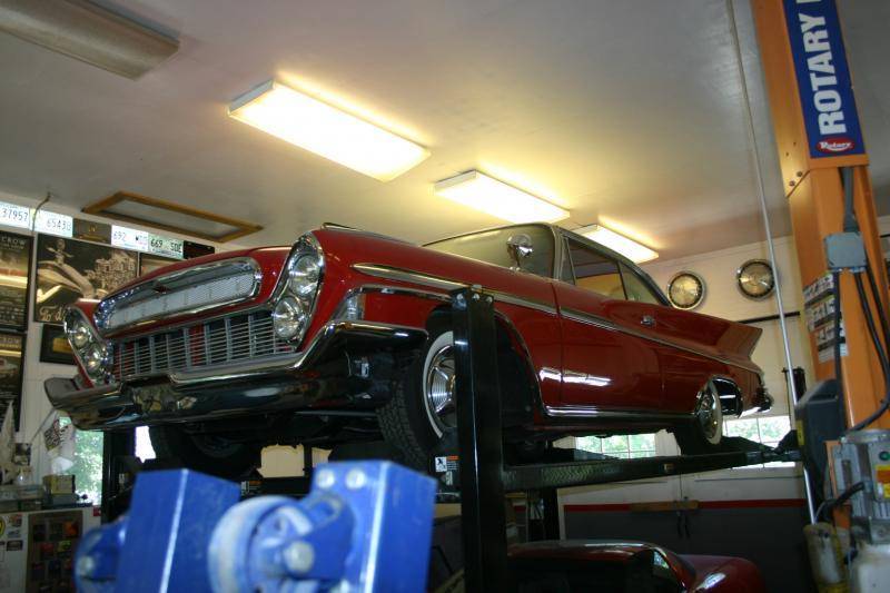

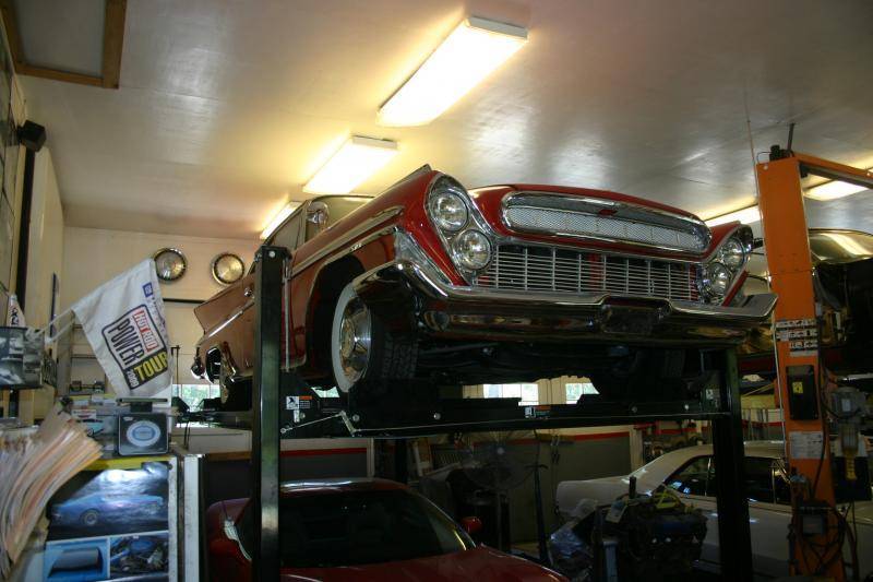

It has been sometimes since I reported on any progress on the '69 Fury III convertible that we have been working on. That is mainly because I have done very little to it. I can report that we got the entire car primed except for the firewall and front frame rails. this was in early June. We have been working on twoIMG_6578.jpgIMG_6577.jpgIMG_6579.jpgIMG_6580.jpgIMG_6567.jpg 1977 Ford Broncos and that has taken up much of our time. I also helped a friend sell his really nice '79 dodge Lil Red Express p/u (remember those?) Here is a picture or two of the Fury. We will get back on it pretty strong but it is gong to be a number of weeks before that happens. Also is a picture of a 1961 Desoto that we restored some years ago. I have a problem with a transmission leak and will post that as a different thread to get some ideas on this nagging problem.
