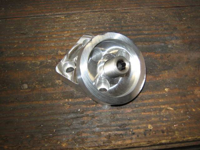

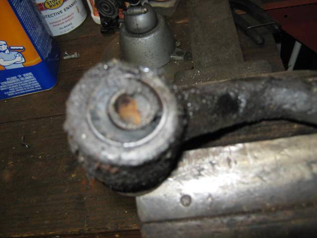

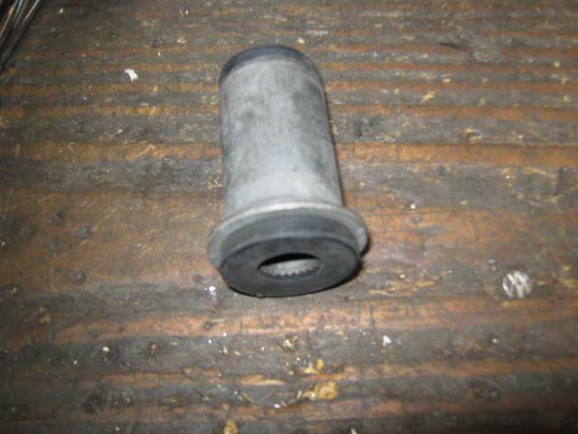

My plan for today was to replace the bushing in the idler arm and replace the canister oil filter with a spin on filter adapter. Getting the tapered joint out of the idler that is part of the drag link turned out to be a bigger chore than expected. I finally got it out and found that the ball assembly in the tapered fitting was shot so I had to order a new drag link which hopefully will be here in a week or so. Removing the old bushing from the idler was no fun either, but got it out and installed the new bushing. I will finish the install on the the spin on oil filter adapter tomorrow.
filter and bushing 001.jpgfilter and bushing 002.jpgfilter and bushing 003.jpgfilter and bushing 004.jpgfilter and bushing 005.jpgfilter and bushing 006.jpgfilter and bushing 007.jpg

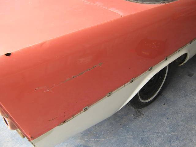

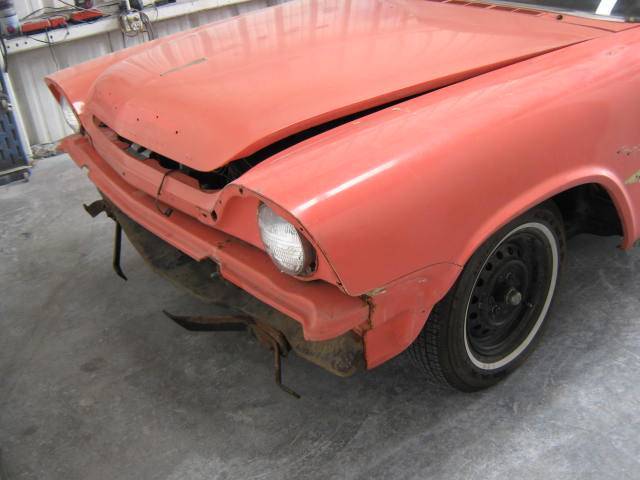

Car is now at the body shop and all the trim parts are removed for polishing or chrome plating. Next step is to strip the car to bare metal and fix the rusted area at the leading edge of the left side rear wheel well. The rest of the car is rust free, but lots of small dings to take care of.
body shop 003.jpgbody shop 004.jpgbody shop 005.jpgbody shop 006.jpgbody shop 007.jpgbody shop 008.jpg

Don't blame you for repainting it, but I'd also consider it leaving as is with partial repaint if rust repairs in visible Areas are necessary, having the dings pushed/pulled out with the smart repair techniques that usually don't crack the paint.
I'm not criticizing for repainting just saying it's nice enough and would great as is with small dings fixed like you said cm23uoc
The pictures make the car's paint look better than it is. The replacement left front fender has cracks all through the paint. I hear what you are saying, but as they say "to each his own".
[QUOTE=baker53;163417] I hear what you are saying, but as they say "to each his own".[/QUOTE]
I agree. While I can appreciate a nice original survivor, (it's only original once), there comes a time when you need to move beyond the original "patina" and make the car as nice as can be. In the case of your De Soto, a fresh finish is the right thing to do.
