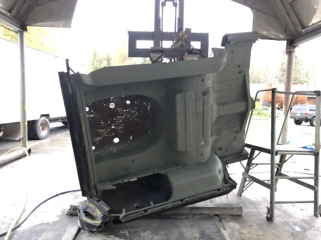

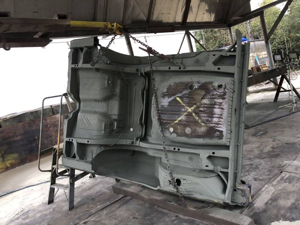

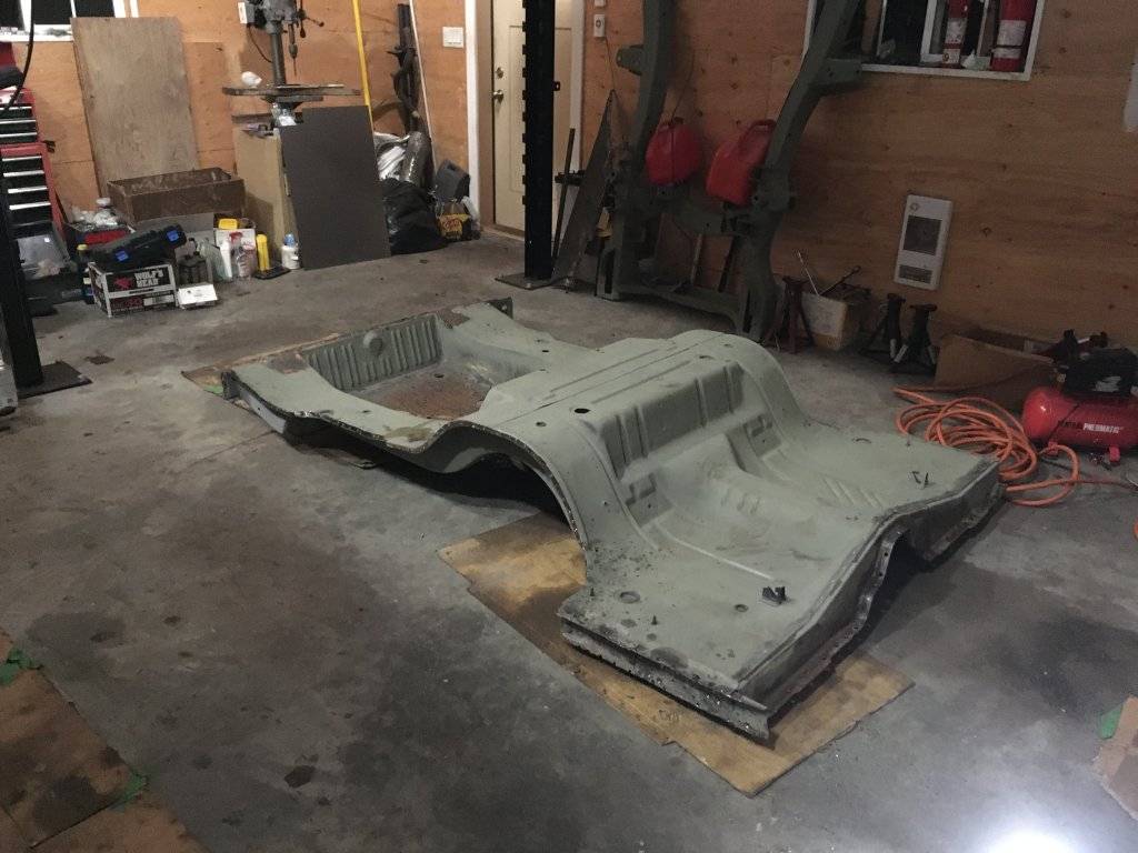

Sandblasting went well. Footwell was a collender but I knew that going in. I think I can patch the chamfers using Blue's metal and the flat section is as easy as a bead roller pass. Minor bleed throughs on the stub to patch but that's fine.
Next step is to put the car on blocks, drop the rear end and start drilling spot welds.
I wanted to do it cleanly as one piece, as it was welded together at the factory, but the floor seems to be welded in between the rocker stampings. I'm thinking it's best to cut the original floor 2"-3" from the rocker flange to avoid messing with the only intact structural element of the car and to place the hard weld far away enough from the rocker flange to not create a stress riser.
I think I'm also going to add some torque boxes to the back because why the hell not. That's something these cars should've left the factory with and they knew it. I'm too poor for serious hustle right now but some day I won't be, might as well ready it now.
If anyone has any experience or advice about what I'm doing here, I'd very much appreciate hearing it. It's baby's first backhalf here and I'd prefer not to learn things the hard way on Grandpa's prized Polara.

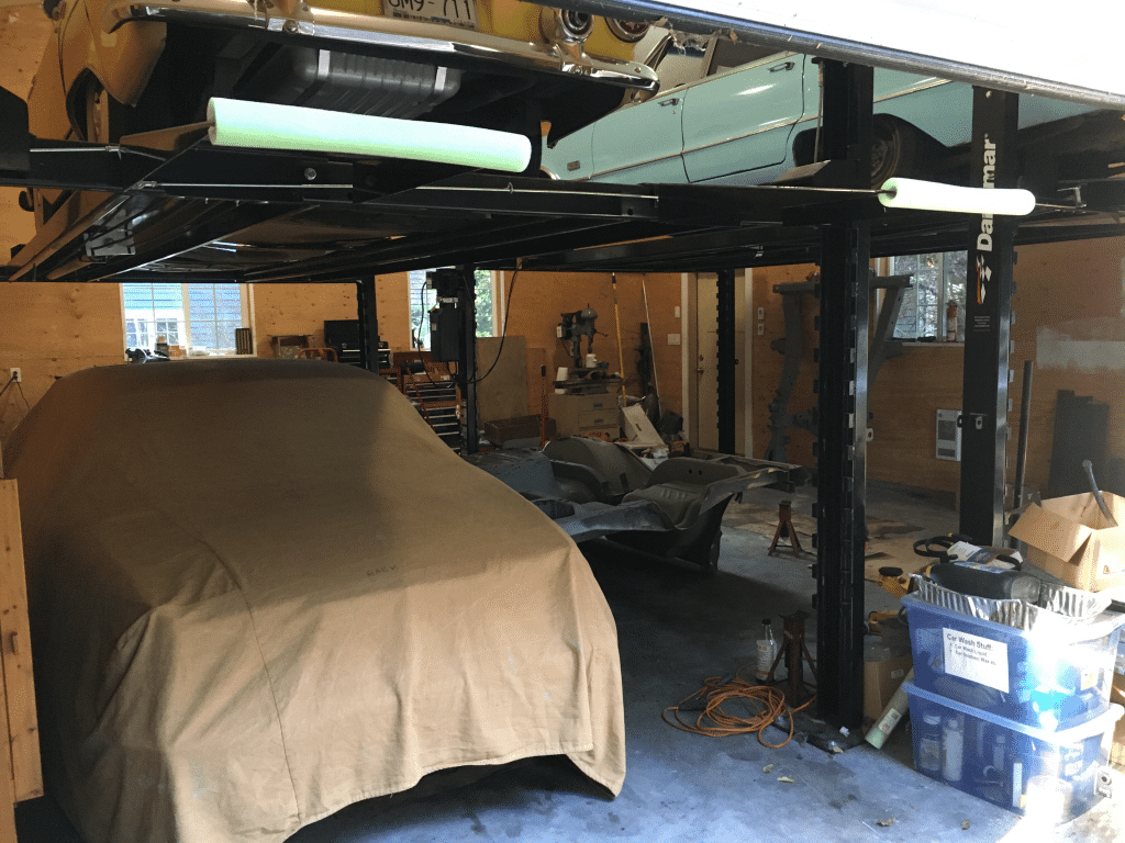

On today's episode: Getting 4.5 cars in a 2 car garage!
5 if you include the DeSoto parts and the spare motors.

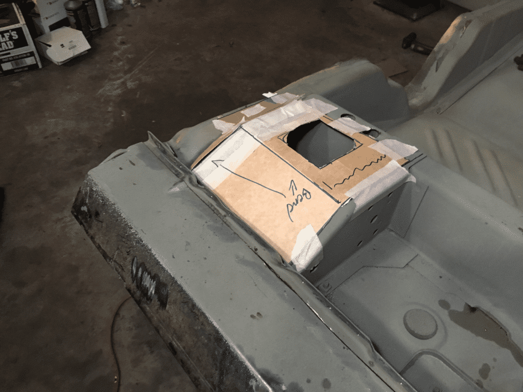

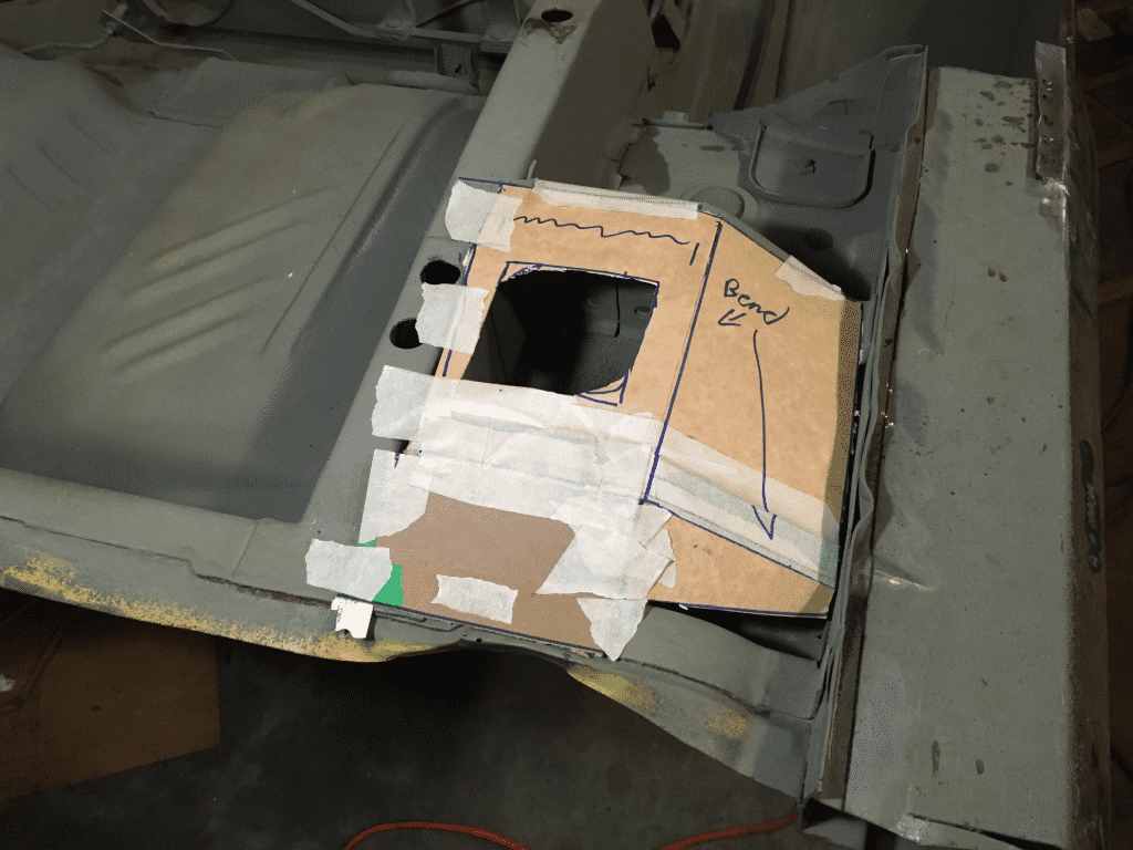

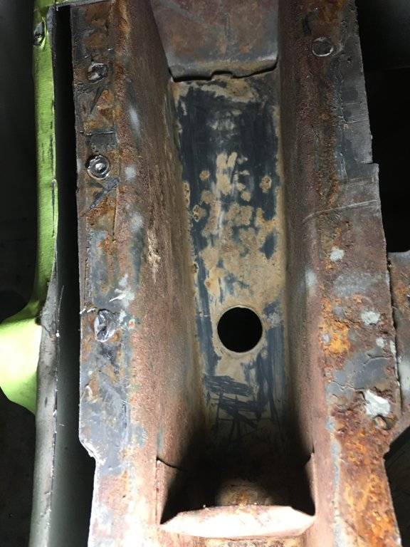

Got bored of drilling spot welds and mocked up a torque box instead. There's one available but I don't like it very much, this seems better.
I think i'm also just going to cut off this fender and the LH inner fender like a caveman and get this thing in as close to one piece as possible. My dreams of a concourse ready job are pretty well out the window now.

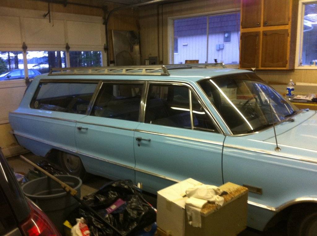

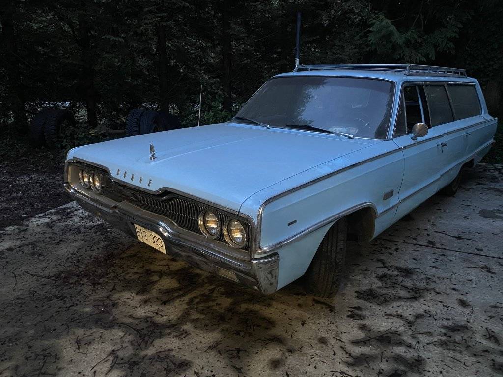

Howdy.
My grandfather's going into a home now, which means the mantle of the old family '66 Polara is now passed on to me.
I keep my Jaguar in concourse shape, and I built my '48 F3 from the ground up, but i've never touched a mopar before, and I'd like to get the lowdown on these cars.
It's in fairly good shape. It's got the 383 B motor and a torqueflite of some description. The motor was rebuilt in 2003, but that's the extent of what i know about it. It's been decently cared for but never really babied.
I'll be going up to the estate pretty soon to inspect the car for roadworthyness and will hopefully be able to simply drive it home. What are the common failiure points or things to look out for on these things? (equivalent to the notorious teapot holleys on a '55 thunderbird, for example). It's a road trip from Port Hardy at the northern tip of Vancouver island down to Vancouver itself, a run of about 500 kilometers through very isolated forest road, so the threshold for acceptable failure is rather low.

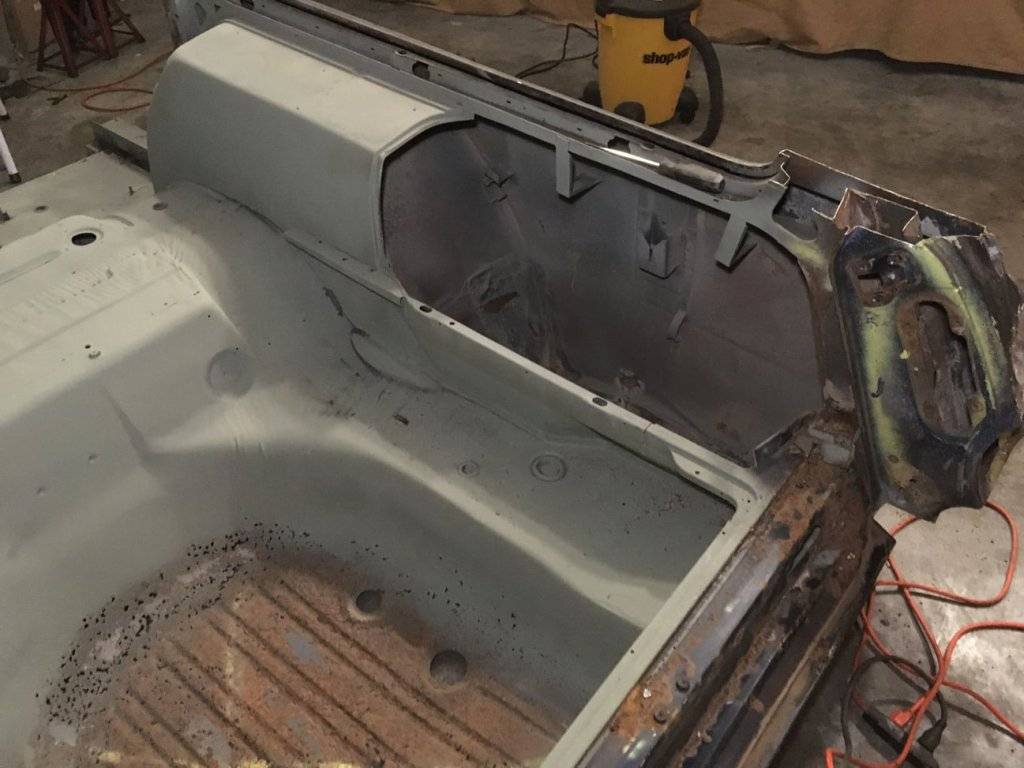

I discovered that the inner quarter simply cannot be removed. To free it in one piece is to remove the entire car from around it. Not sure what condition the panel is inside of Blue, at best I'll be using this one as a patch panel.

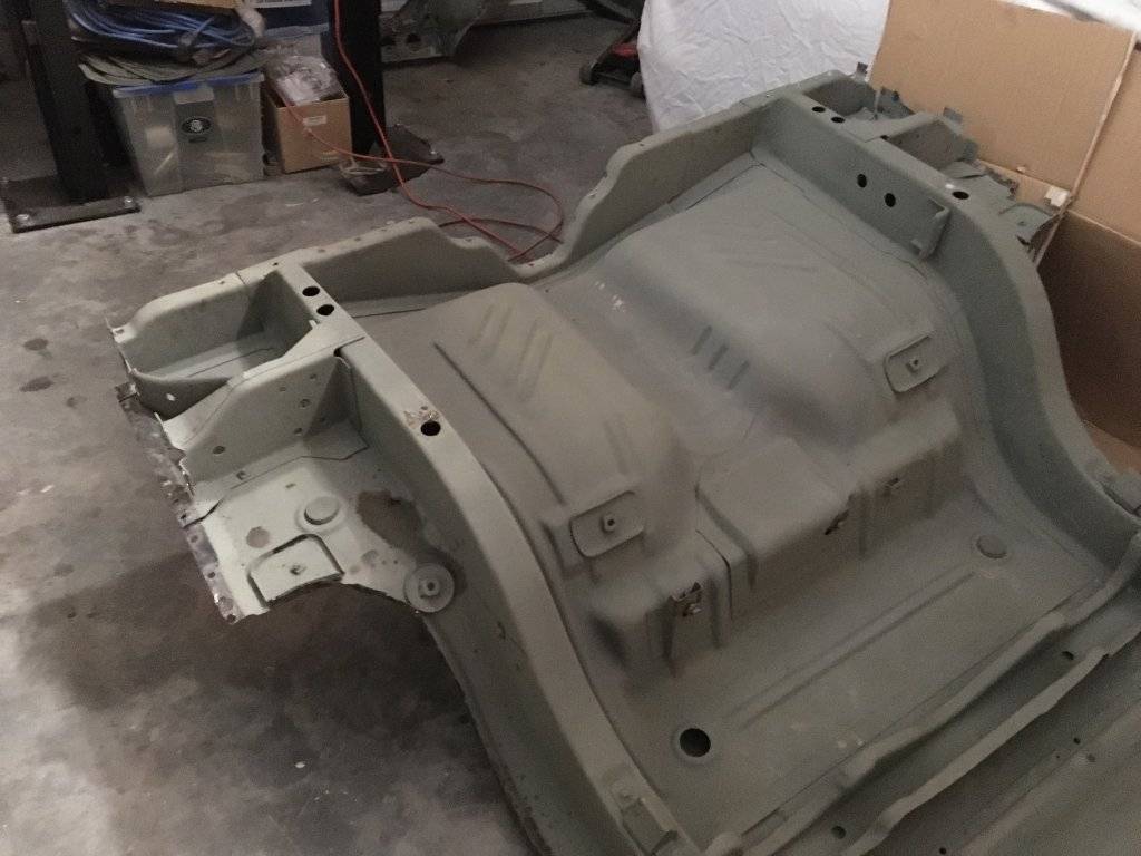

Otherwise got it stripped down, and happily my plan of inserting the floor chunk as one piece is entirely viable. Though I really should've worn a mask when cutting, as im' now coughing up metal/grinder dust and a bit of blood. Gave myself Moparsthelioma I guess. Oops.
Next step is to make up the torque boxes, as fitting them now is much easier than fabbing them upside down under the car. After that it's time to start cutting Blue up. Though I'm not sure when the next chance is, I have to strip the entire interior from the car and the rains start tomorrow. Going to rain 100mm over the weekend with no sunny window to shuffle the cars around.

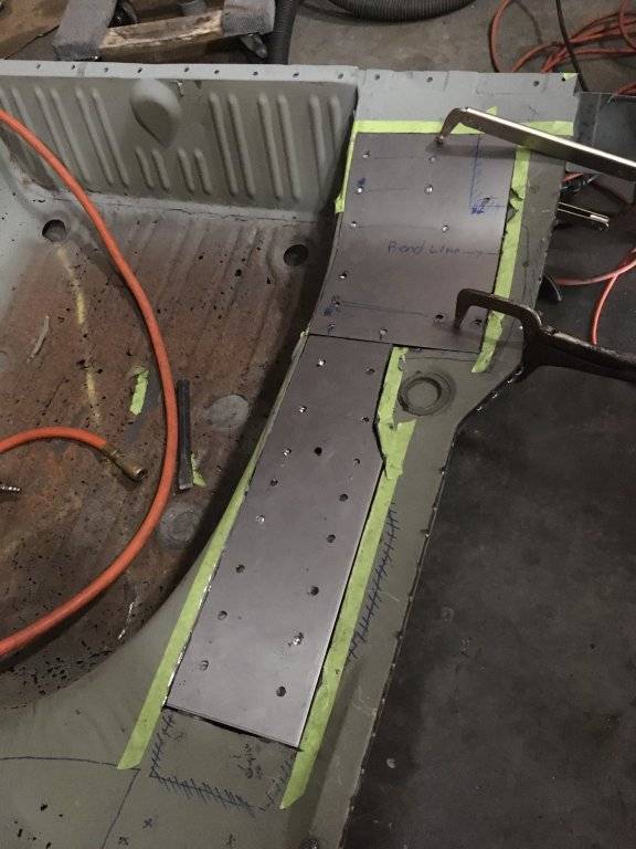

Getting good at making patches too. Running my 1940's drill with Bing Crosby on the radio felt right.
I have to get proper gas for the welder though. With fluxcore even the most perfect welds are full of cavities. Which is fine on thick stuff but if you want to grind them down on sheet metal it's garbage.

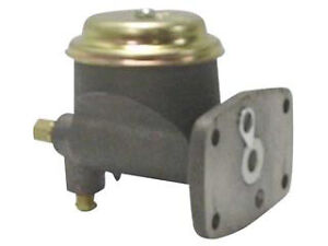

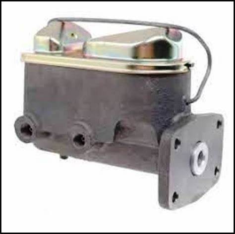

I'm ordering parts for the rebuild. Can I bolt the 67 and up dual master on my '66 power booster? The bolt pattern looks the same but I don't have both in hand to compare. I've had enough wheel cylinders fail on me that single pots terrify me.
Sure can, just make sure it's the correct drum or disc master cylinder. I do this to all my cars, no fun having it go out in you in traffic.
Perfect, thanks.

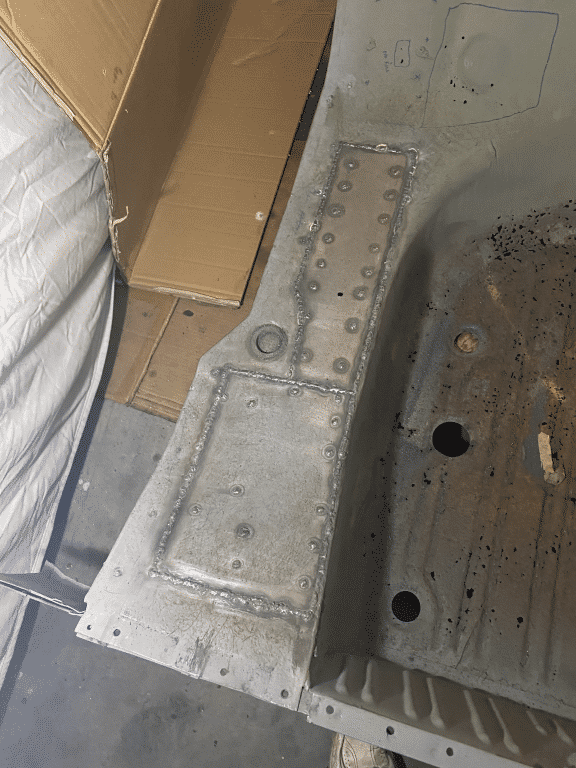

Got the patch knitted in last week. About as well as fluxcore will allow. Even the most perfect welds with perfect penetration are full of cavitation when you grind them down. Fun. Also cut and fitted the torque boxes, but I can't burn those in until the floor is actually in the car so those will wait their turn.

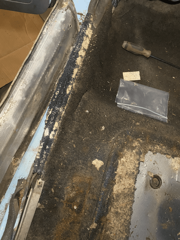

She crusty. The white stuff is all pounds and pounds of mould. I think the carpet is going away. And the insulation. And whatever else isn't metal.

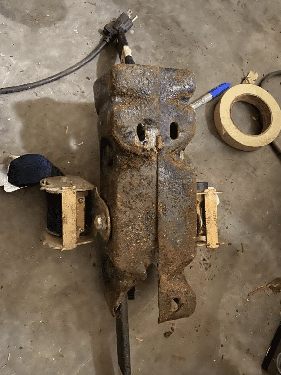

Seatbelt hardware was a placebo. Passenger side bracket is half gone, when i backed the bolt off, the welded gusset on the body dropped to the floor and shattered like glass. Nice.
