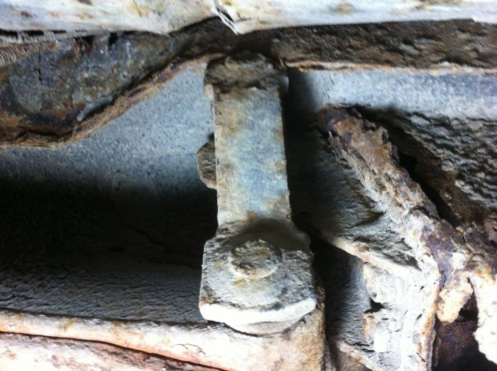

On topic however, i've had some time to think about what to do about Big Blue. The front stub is junk, but that's an easy fix. But the rear stub is not great.
I've realized how and why it failed. What's weird is that from the rear seat forward, the body is mint, no issues whatsoever. But from the rear seat backhead rearward, it's a disaster. This is really peculiar behavior, with every weld on every structural gusset failing.
My grandfather had a big motorhome style gravel skirt on the rear of the car for ages, with which he drove every crummy dirt backroad in BC, including Yellowknife in the dead of winter. I suspect what happened was that this caused a turbulant air to form in that big pocket, which swirled dust, dirt and all sorts of crud around, and it could only settle on top of those gussets, such as the open flange pocket that supports the leaf springs. It's also worth noting that that skirt was taken off the car in the 90's, so I suspect it had been driven around in this condition for at least 15 years. As stubborn a car as my grandfather, that's for sure.
I've been seriously studying the frame, and I've come to the conclusion that the gussets can be replaced, and that the primary rails themselves are still very solid. But that the spring hangers in the rear are beyond repair. The springs are all done, driveshaft needs repair/replacing, exhaust system is done etc. And the front stub needs replacing entirely.
