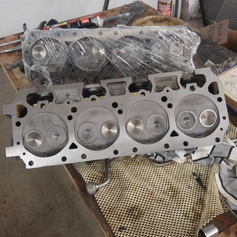

So I did the tear down of the 440 today and found a few interesting things.
There was an extra connecting rod nut sitting in the pan, usually if I put an engine together and drop a rather important fastener such as this I search for it until it's found. This leads me to believe it was done on the assembly line, most likely on a Friday afternoon.
The engine came apart really easily, didn't even need a pri-bar to lift the heads off the block. The head gaskets are marked with the Pentastar so I will assume they are original (who goes to the dealership for head gaskets? lol)
Another by-product of these Lean Burn engines, wore out exhaust valves. Heads going into the rebuilders for a re-fresh.
Also the cam bearings had some nasty nicks and gouges, again a sing of a lazy uncaring engine builder. They didn't take the time to insert the cam with the care it requires.
