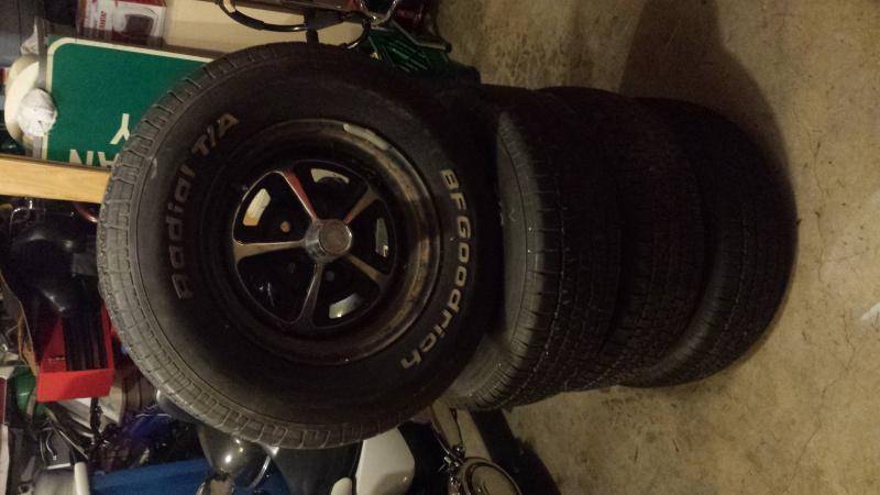

Picked up these tonight for a couple hundred bucks!! Wheels need cleaning but tires are almost new!
See if you can determine how old the tires are.

I'll look when I get home to see if there is a date on them. Can anyone walk me through the process of taking the skirts off to change the tires?
the skirts have a lever arm that pushed up in there on the back side. reach in at the bottom of the skirt, and there is an iron bar there. that is the lever mechanism. pull out the bar a bit, then down, and the skirt will let go.
to get to the back wheels on or off you have to lift the rear body up some so the shocks/suspension drops. waaaay easier.

Part of the lever protrudes down past the bottom surface of the skirt. At that point push up and in towards the wheel and that should unlatch the skirt. There are alignment pins on the skirt that line up with holes in the quarter. If it's like my Imp you'll lower the rear of the skirt first and they should come right off.
