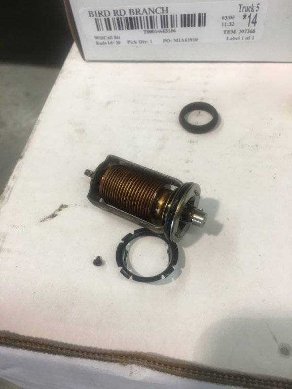

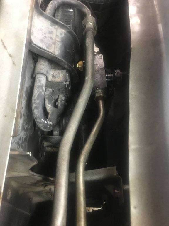

Thanks! That’s what I was thinking.It's broken. There's your answer. Toss it.

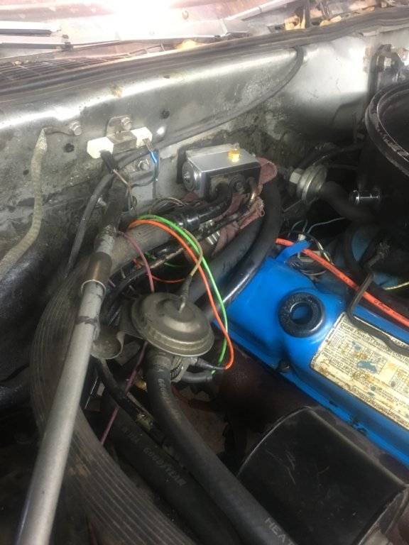

I don't have an EPR. If you're worried about evaporater freeze-up, install a thermostatic switch on the firewall. Drill a hole and stick the probe in. Put the switch in line with the power wire going to the compressor clutch.
And I keep telling you that You Suck, Bob.I have them in both of my manual A/C compressors.....no problems. 38 degrees at center vent with R134A.

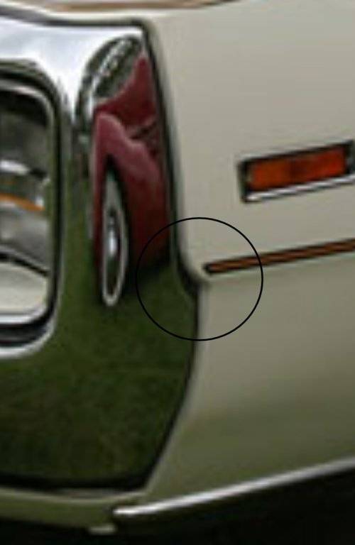

I'm with Stan on this one. I tried over and over to get the it straightened out with no luck. By the time you get the left and right ends where they are supposed to be, you've stuffed the middle up into grill! I tried bending, jacking, loosening, tightening and tons of swearing. All to no end. Almost screwed up the center a couple times.Insert Don Quixote GIF here...
I, sir, will take that as a personal challenge!!!
Gave up. Good luck and keep us posted if you figure out a way to do it![]()
Yep.,.Chrysler always couldn't make the bumper to the drawings.
The Manager of Bumper Design position must have had a high turnover.
