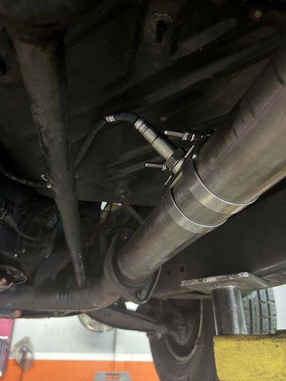

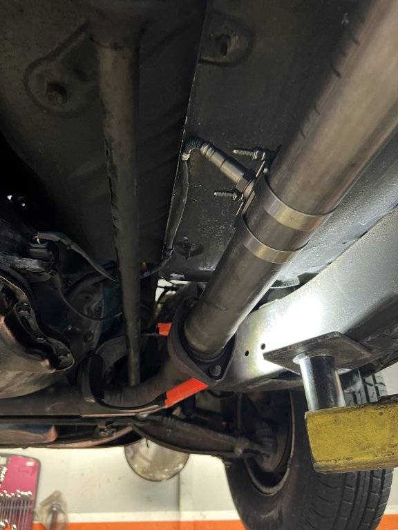

Didn’t like the way the O2 sensor was hitting the old catalytic converter heat shield. So I removed the heat shield to give it a bit more room. May rotate it a bit down for more clearance but still keep at least 10 degree angle (up per instructions).
Here it is after…. I also added a clip to hold the wire away from the torsion bar.
Here’s the before… to tight an angle at the O2 sensor where it met the old heat shield now gone along with the catalytic converter (it was gone before I got it).

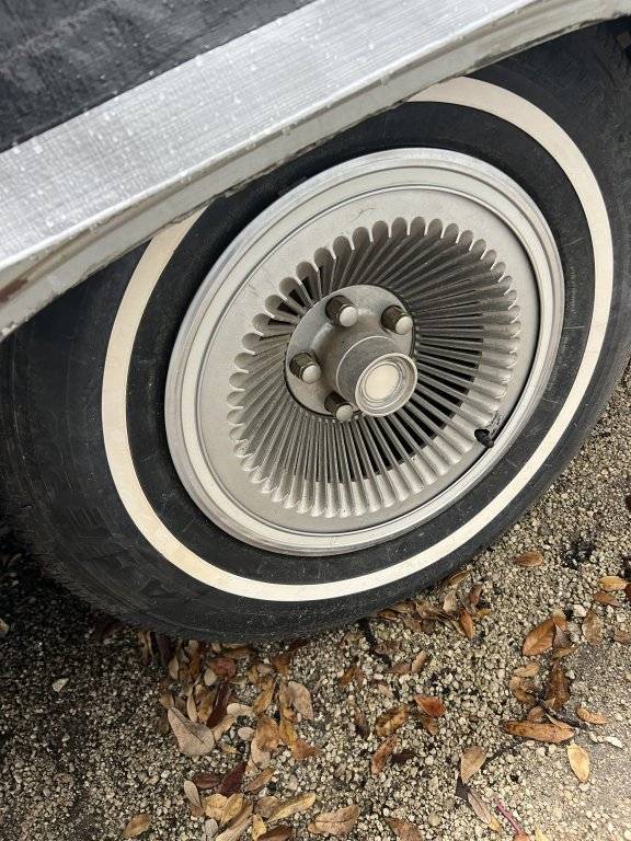

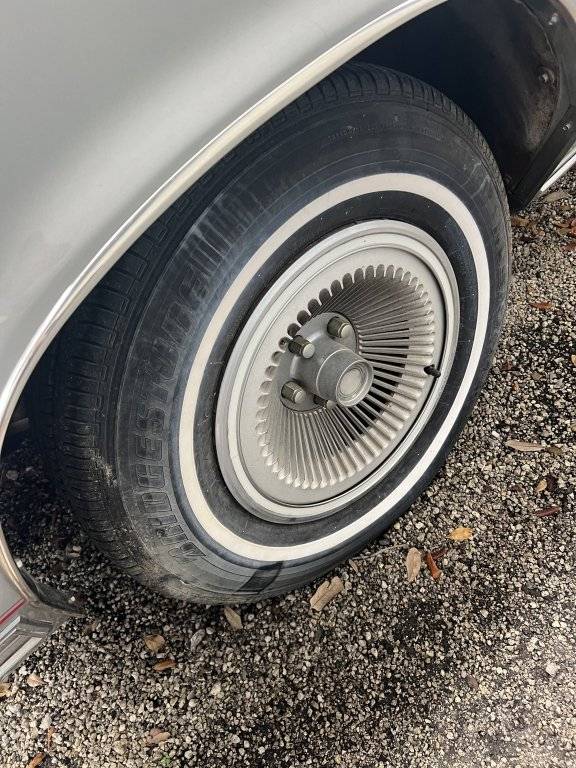

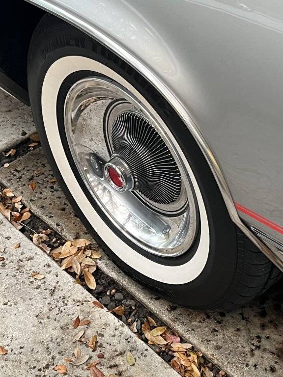

Time to polish the wheels and whiten the white walls.
Mothers for the wheels and Bleach White for the whitewalls.
If you look closely, you can see the reflection of my roadrunner in the wheel.
Even whitened that little strip in the front bumper. Took several passes with some fine steel wool (grade 00) and more bleach white. Took a while but I’m happy with the results.

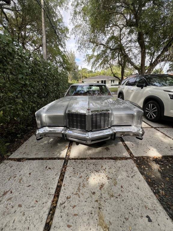

Well, I did it again. I bought this car for Christmas in 2017. And on December 20th of 2024,………… I bought another one.
Dan Scully, fellow member and hell of a decent guy, sold me his 78 Salon in the same color combo as mine (obviously).
We had been back and fourth (for literally years) and came to agreement in 5 minutes the moment I was ready.
Hell of a lot of good parts, some of which I’ve already transferred.

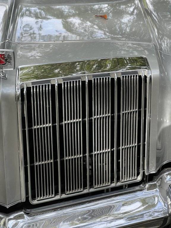

Case in point: the grille. Being a low mileage car (60k) and having lived in the desert it was the first thing I swapped.

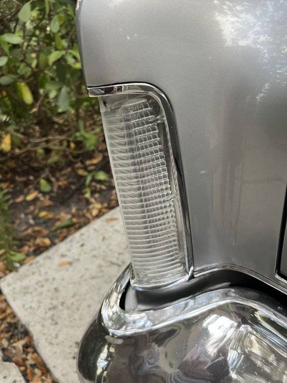

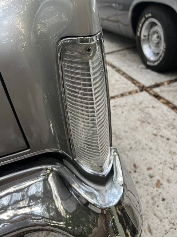

I also changed out the corner turn signal lenses that Dan kindly removed and put in the trunk when he got the car.
Yes…. I polished and repainted it. I wouldn’t be me if I didn’t. I’ve got a fan base to live up to.

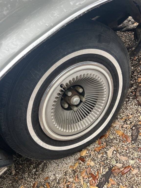

These will include: these cool Salon Only Wheels:
Here’s a detail shot of the cornering light lenses…. Which are perfect. After I cleaned and polished them…..
