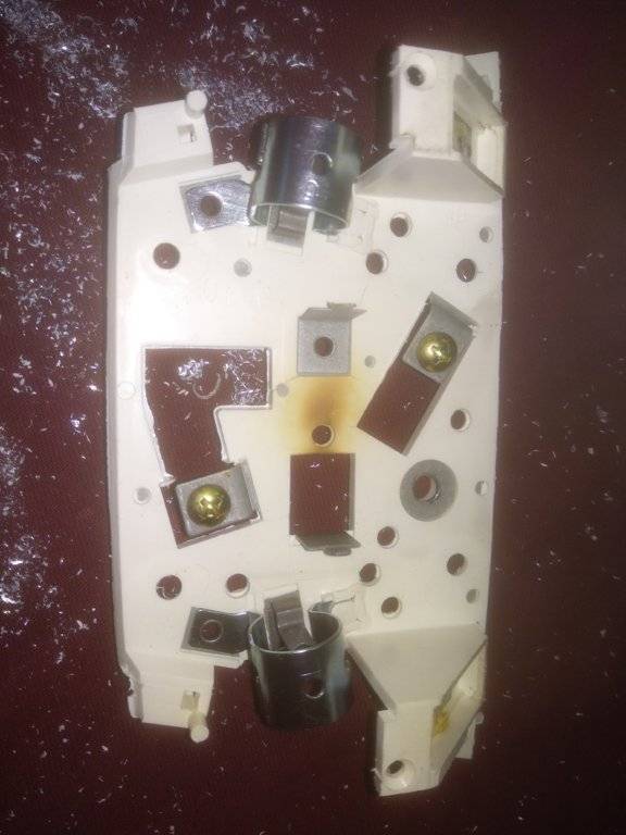

As I suspected, yours is different. Need to see both sides please.OK, Jav. What's going on here. Do I have to drill out the rivets to get at the terminals?

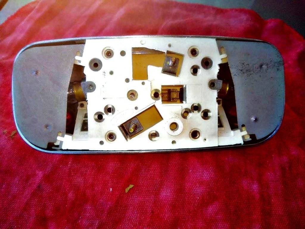

Ok .... give me a minute.Another weight savings on the 78's, lol.

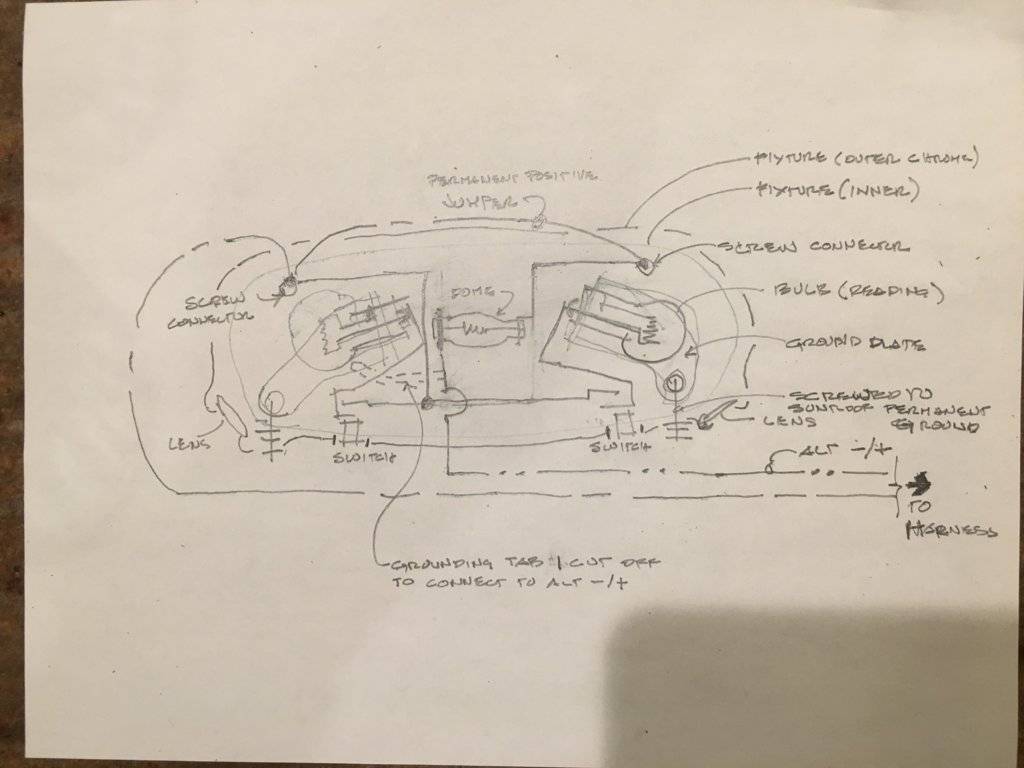

Jav, I drilled out the rivets. I see how to handle the hookups now. Gotta find View attachment 241967 3 wire M & F plugs now.
What did you do with the switches???Another weight savings on the 78's, lol.
