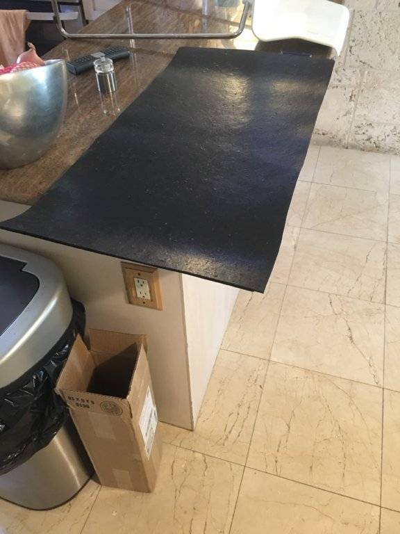

Two sheets of masticated rubber from Detroit Muscle..... next little project.

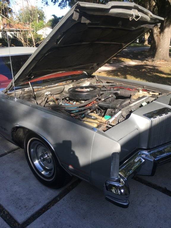

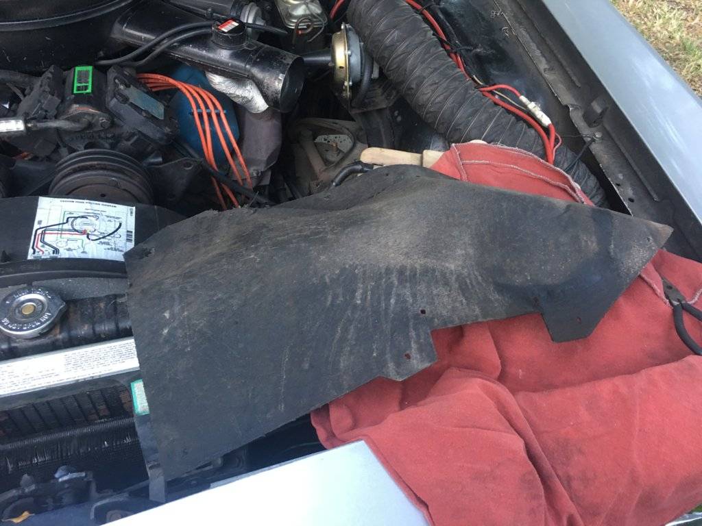

Been meaning to replace the splash shields over the front suspension in the engine compartment.
First step... wash car.... while the engine cools enough to get the old splash shields out.

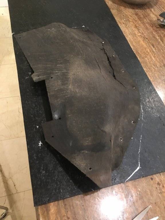

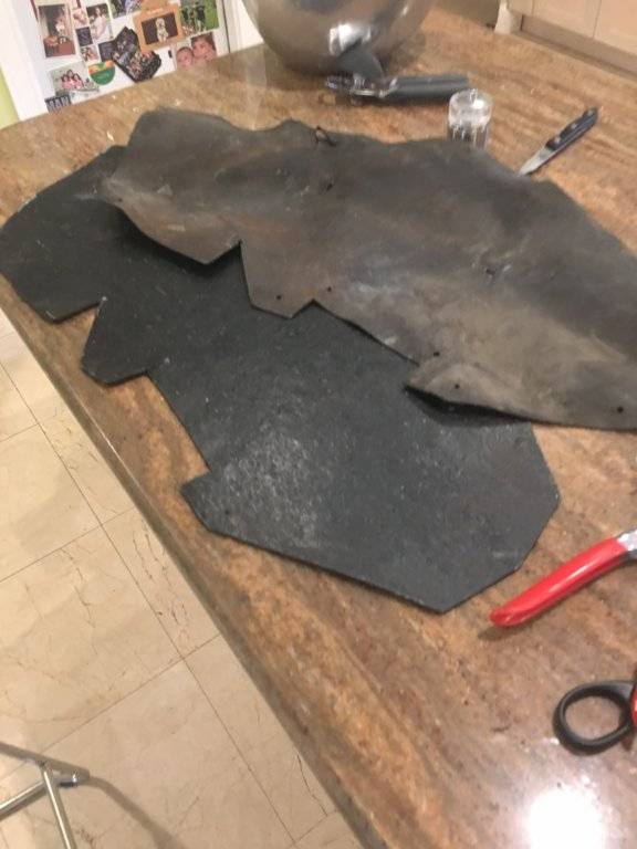

Starting with the passenger side, I used a silver paint pen to mark the edges of the shape. I started with some craft scissors but got hold of my wife’s poultry shears which worked better. (Please don’t tell her) The masticated rubber I bought was 1/8” thick and about twice as thick as the original. I cut the holes with a punch using the old shield as a guide for spacing.

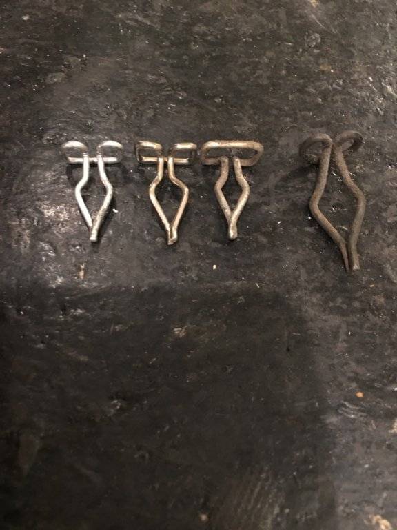

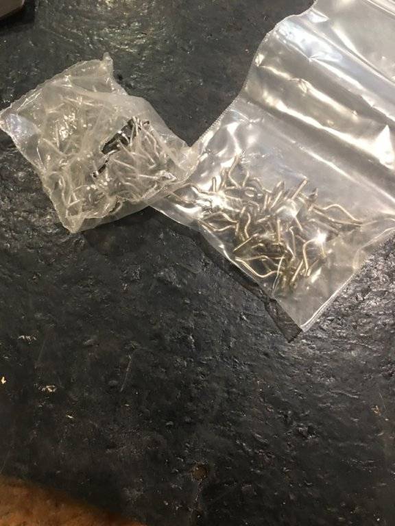

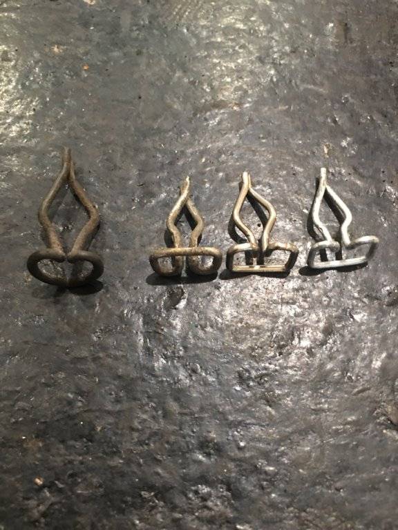

I had a bunch of new, old and chromed clips to choose from due to my “never throw out a good clip” fervor since I was 18. I also had some from a previous set of shields I installed in my 73 T&C.
Left to right, bigger round head clips go along the bottom holes (4), OEM original, aftermarket chrome, replacement galvanized.
Same but reversed. Chrome ones are thicker wire and have a little bit longer shank. Going with those..... because they are also shiny.

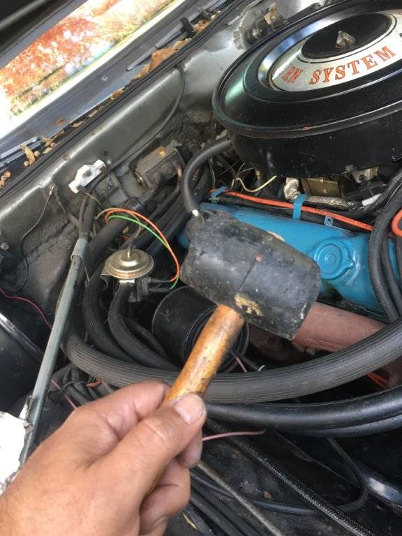

Little rubber mallet as much to tap as to push the clips back in.
Passenger side done.

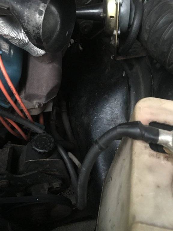

Pull the the driver side next

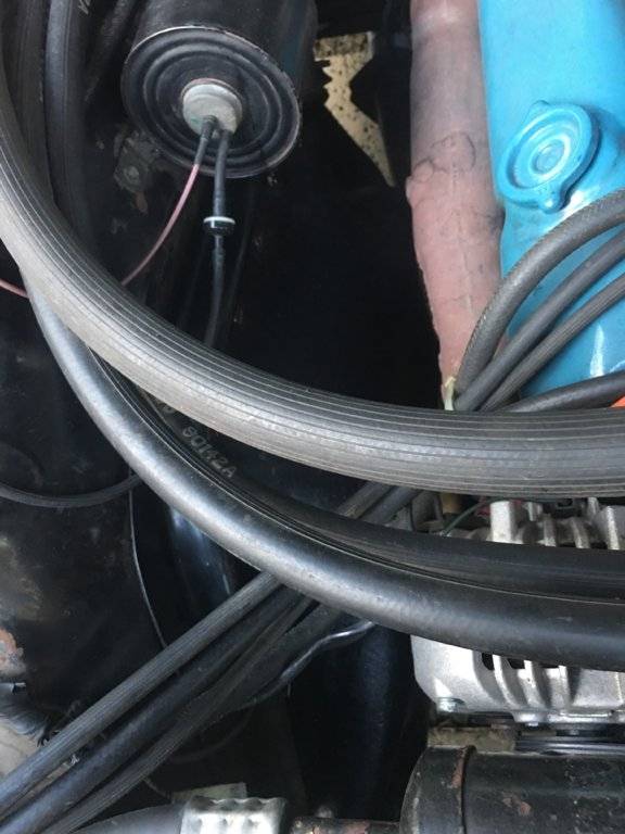

As suspected, driver side is different. Also, it was well cooked and stiff as a cracker.
Repeat and install. Installation of the drivers side was much harder due to brake lines and wire for the sensor, starter cables and power steering hoses.

2 sheets of masticated rubber;18”x36” $36.00
