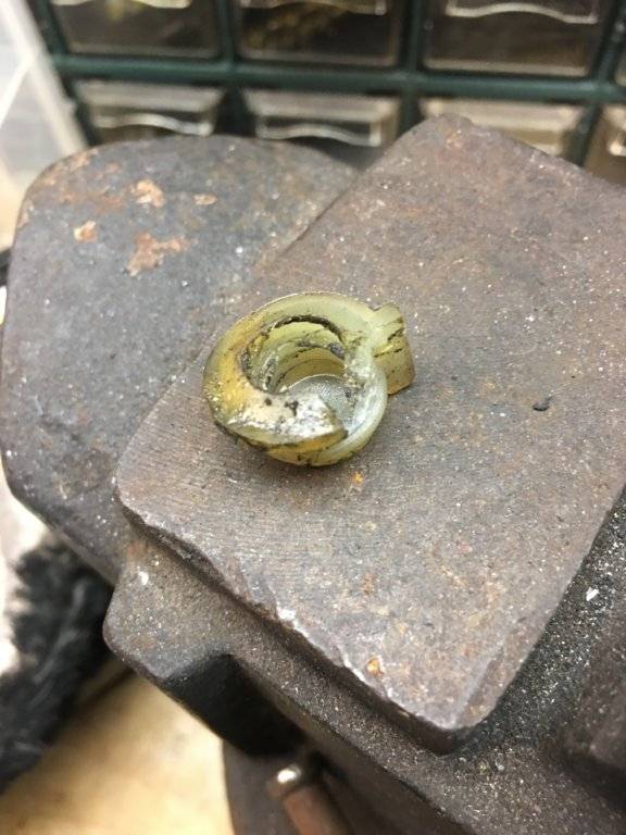

I was driving in the rain on Friday when the passenger side wiper stopped. The bushing on the drivers side of the connecting arm broke.
My fault!
When I replaced them a year ago or so, the passenger side wiper would hang up occasionally on the trim when I shut them off. The trim was sitting just proud of the glass and I let it go for too long. I would manually return the passenger side blade to the rest position when it got stuck... but only when I remembered or noticed it.
To resolve the issue of the trim.....
I removed the trim and very gently straightened the trim very slightly and only in the area it would hang up. The idea being that once reinstalled the trim would sit tight to the glass... and it worked.
These bushings are good at handling sudden low levels of shock load but terrible for constant load. Being semi solids, they yield and eventuality fail under constant compressive or shear loads.
By getting the passenger side wiper stuck on the trim, the bushing was left in constant load and eventually sheared as can be seen in the picture above. These were good quality new OEM bushings that were still very flexible.
Likewise when I reset the blades, I set them just as per the FSM. I also checked the blades in the rest position to make sure the arms weren’t under any tension.
Hopefully, second time’s the charm.

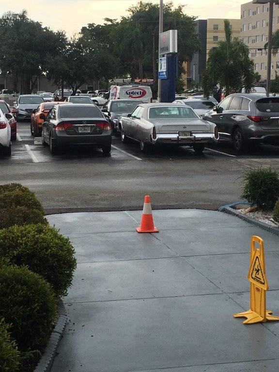

Took the New Yorker out today in the rain.... why you ask?? To test the wipers of course.
God... are cars today boring or what?
Also took some clients out for lunch in it....crossing myself that nothing would break or otherwise malfunction to embarrass me.
Nothing did and a great time was had by all.

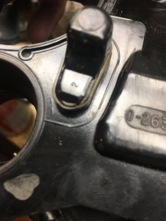

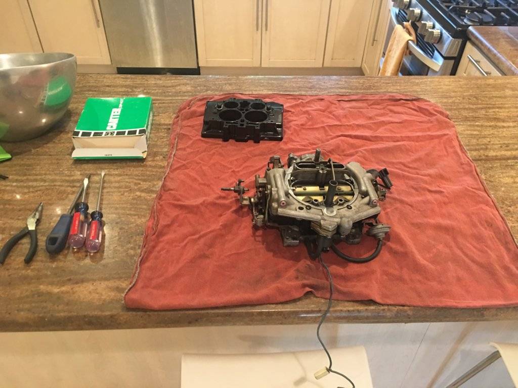

The NYB has been running kind of shitty at start up and during transition to operating temp. So, with no hurricane to prepare for, I decided to look into some minor issues with the NYB.
Cold start up was sure, though it ran rough for the first 3 seconds or so. Traced it to a minor crack at the phenolic base on the Thermoquad that seeped fuel overnight and drained the bowl on the right side. It took three seconds to fill the bowl and set things to right in the carb.... but I needed to do it.
You can just make them out in this picture.... not much but enough.
Patient wife allowed me to work in air conditioned comfort....
All better now.
