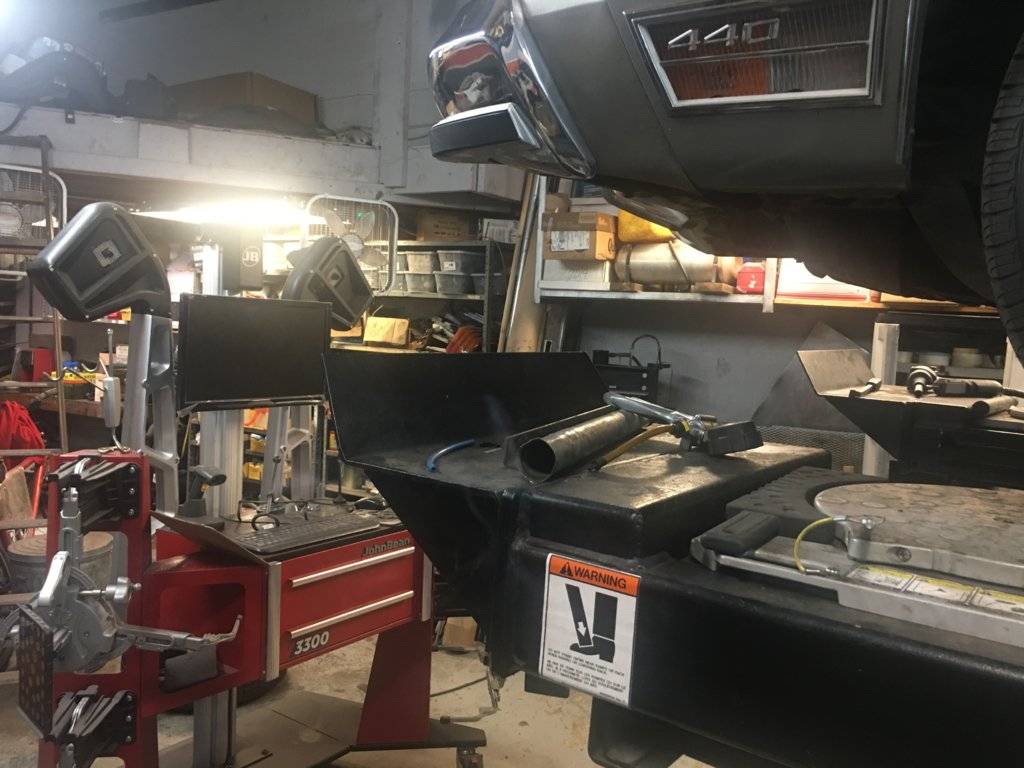

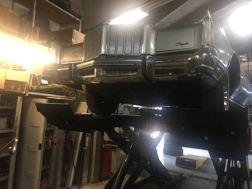

I took the car in for an alignment check. It was wearing the inner sides of the tread.
Needs new upper and lower control arm bushings. Ball joints are still good and look like they were replaced just prior to my stewardship. I had done the tie rod ends about 6 months prior.
So it should be good.
Going to rebuild the front brakes I think. Will start with a good bleed first. Right side is engaging harder and pulling. Worse after a bit of highway like the last time I saw Commando1. Last long trip
Here she is up on the rack.

wow!!!! Do you know how to use it??? Let us know.B.B
No... not yet but it doesn’t look too hard or bad. We set the alignment per the the FSM so it should be fine. Very precise machine.
I’ll put up some pictures of the front end and how she sits when I get her down. We’re centering the steering wheel now while we wait for calipers and lines.

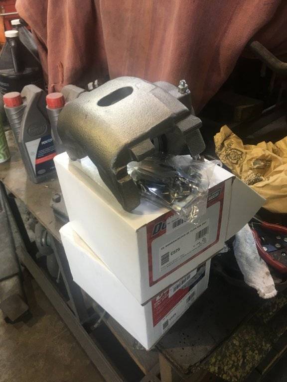

The calipers which came -packed were perfect also.
Looking to change calipers and rubber brake lines now. So thanks!
Finished front end on Thursday. Today was brakes and calipers.
she rides like you’re in a cloud. All the little squeaks and groans are now gone too.

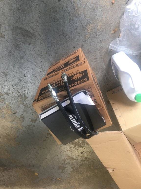

new front brake hoses
new calipers

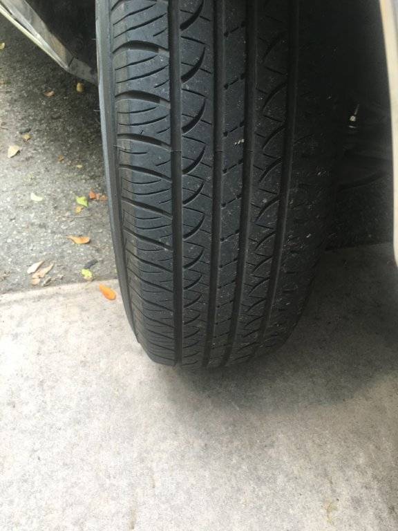

front suspension showing inner wear on tires. Camber and toe in now holding as set. May replace the front tires sooner than later. They are relatively cheap.

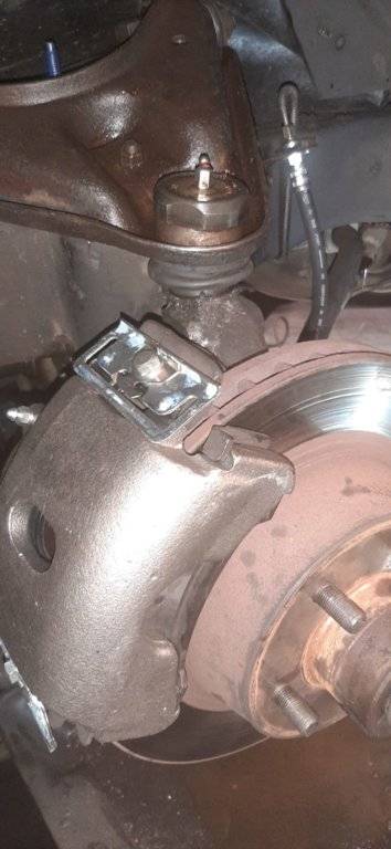

Front brakes with new upper and lower ball joints. Said I wasn’t going to do it but I had it all apart and “what the hell”!

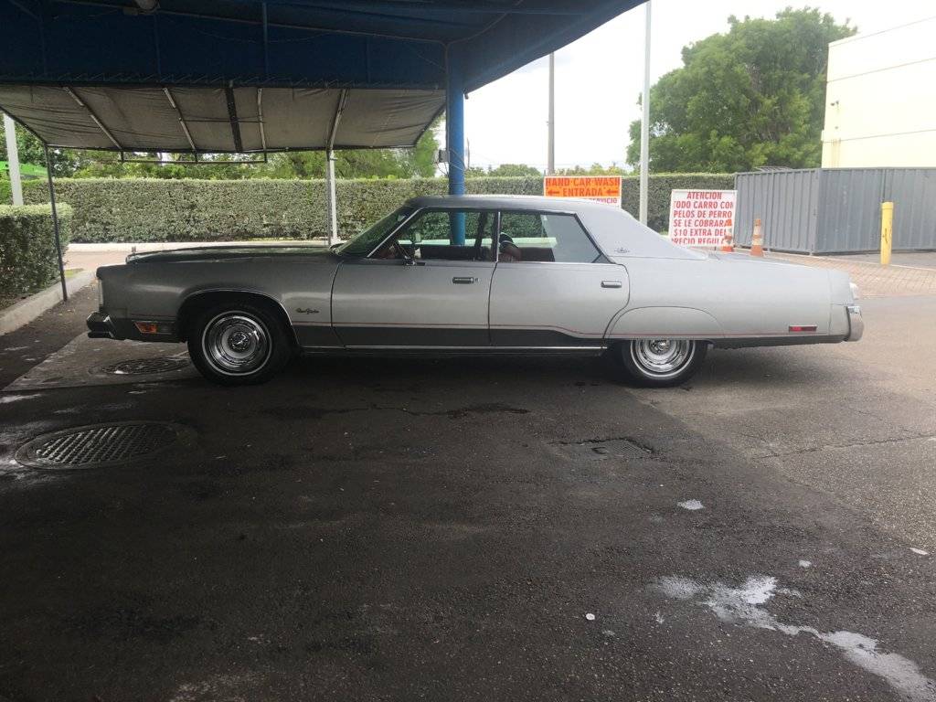

Here she sits now with the new front suspension and having taken out the replacement front Windsheild out of the trunk..... finally.
Little proud at the front but even.

Run her for a few weeks, she may settle a touch more. She's looking good, and now I don't feel so bad about how many weeks I hauled that dash pad around :lol:
