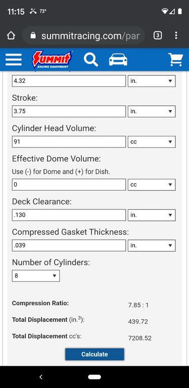

You don't believe me, huh?need to do some math to see what the CR would be.
I'll take a guess. Piston is down in the hole .120-140, chamber volume is on the low side maybe 90cc, high side 92 cc, you had a composite gasket on there.You don't believe me, huh?
Truthfully, it's best you don't...
Seriously, I'll be interested in what you come up with for numbers.
Hence the using of the raised dome is required here.You will never get crisp throttle response out of a engine with compression that low. It will always feel lazy. IMHO
Or deck the block. Need to know the measured compression height of the current pistons. Then come up at least .060-070 that should put it about 9:1Hence the using of the raised dome is required here.
I don't like decking the block because then you have to shave the intake manifold.Or deck the block
Yes, it starts to make bastard parts. If the deck is at the factory spec I would leave it alone, if it is above factory spec and/or crooked it could come into spec and be proper.I don't like decking the block because then you have to shave the intake manifold.

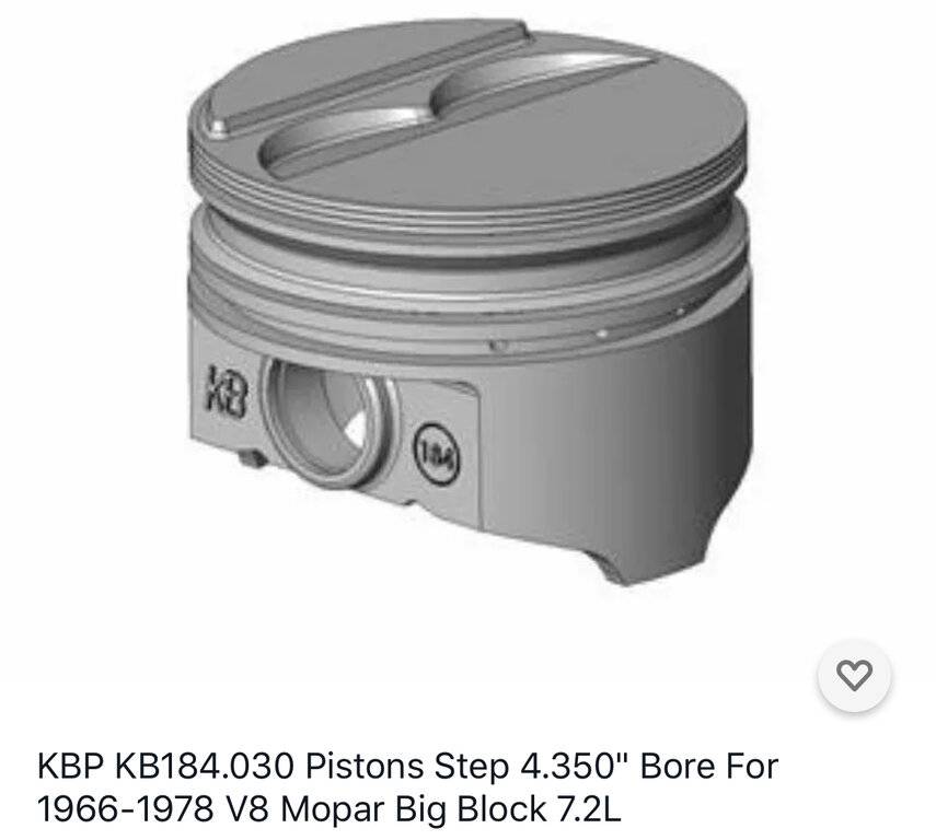

A step head hypereutectic piston would help kill off that dead area across from the spark plugs on a big block and raise the compression without breaking the bank.

Something like the KB 237, has over 2.0" compression height, so it acts like a six pack piston height in the bore wise. That should put you in the ~9:1 range.I was looking at that but the ones I was looking at stated that the heads would need machining to allow them.
I’m looking to get a little over 9/1 CR. Nothing too crazy. The agree that 7.8/1 sucks.

That’s what I’m looking at. Waiting on the block to see if we end up at .30 over to order them.Something like the KB 237, has over 2.0" compression height, so it acts like a six pack piston height in the bore wise. That should put you in the ~9:1 range.
