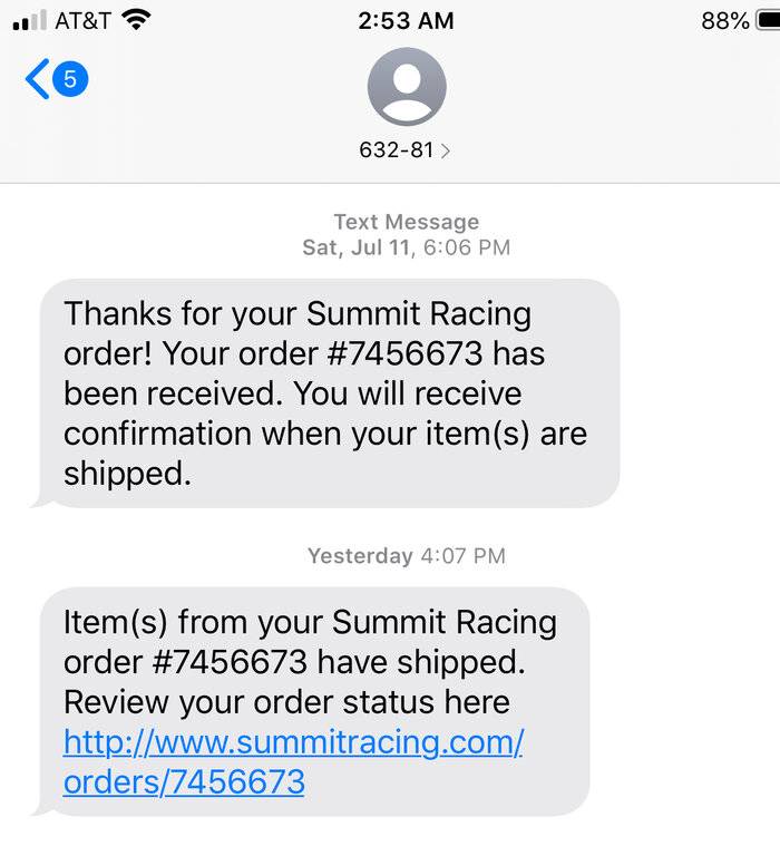

Just got word from summit that my order has been shipped.
Link not working...
It a damned picture of their text to me the day after I told Summit I might cancel the order.Link not working...![]()
