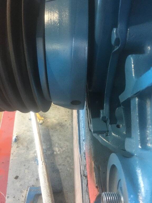

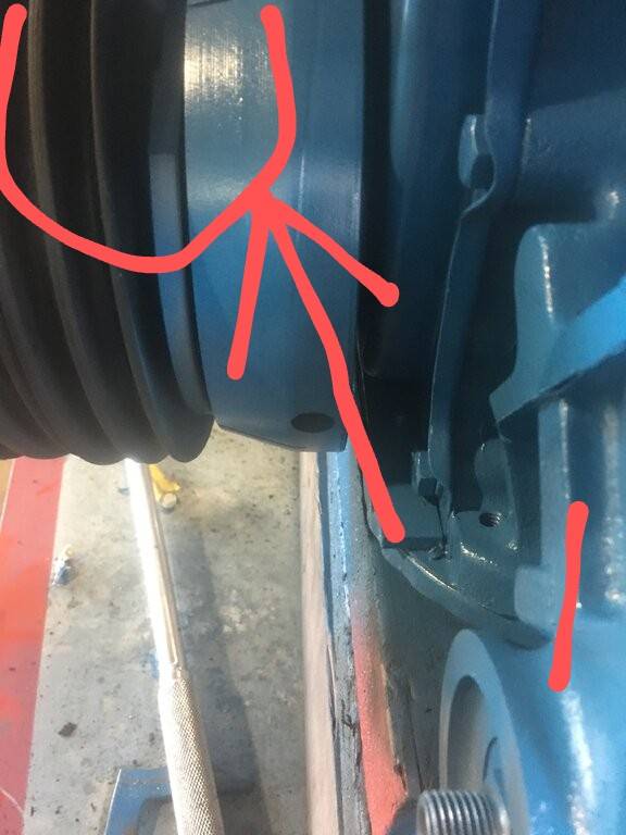

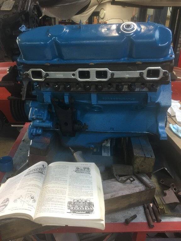

Wait, wait, wait, your car originally had cast crank and external balance. Unless the crank has changed it should still be external balance. I'm not going to question your builder, but the dampener should be the thin one if internally balanced. If this was all changed and/or it is internally balanced now the stock converter will have a large weight on it which will unbalance the engine. You will have to make sure your ducks are lined up. Internally balanced or externally balanced, if you did not knock the weight off you may have a mismatch of parts. You can easily remove the weight from stock converter by cutting the tack welds flush not into converter obviously.
Line flexplate up with converter bolts while off the engine then a splash of paint on the bottom spoke of the flexplate onto the converter and they will be marked for reassembly.
ok.
Will confirm with builder....
But it is still a cast crank and, as to balance, it was the pistons and rods that were balanced to equalize them I believe. I specifically asked about the. Balance on the crank and he told me he left it alone adding “ to balance the crank I would have had to make Swiss cheese out of it”
Balancing a cast crank is not what he did. Still has original harmonic balancer on the front.
Not sure what you mean by “the thin one” but I can guess as to the idea of different types having different thicknesses for balancing through material removal. Just don’t know the dimensions to be able to tell which is which.
Torque converter still has the large “butterfly” weight still on it. It is larger than the typical two smaller ones welded to the edge on earlier models from what I’ve read. It is mounted closer to the center that the typical two weights on the edges. (Closer to the center would have less rotational speed and therefore less centripetal force.. hence it would need to be bigger)
The previous posts confirm that the torque converter only fits in one rotational position relative to the crank so.... if no weight was added or removed from the crank’s internal stock counterweights......The original balance should still remain and the original matching torque converter will complete the balance.
It did not make sense to me that the torque converter would be so out of balance as to require such a heavy weight tack welded to it. But if it was meant to balance the rear end of the crank shaft....then it makes perfect sense.
I will confirm specifically the crank’s balance with my builder but I’m pretty sure it is as it was originally.
Therefore, it should be a bolt up and drive thing like HYWYCRZR mentioned.
thanks.
Sounds like he balanced the pistons on the rods to all equal each other, very good. If it is still the original cast crank and harmonic balancer, just leave the weight on the torque converter.
Stock cast crank dampener should be 1.25-1.5" thick at the outer ring thin one from a forged crank pre 73 engine is about 1" thick. That's what I meant by thin dampener.
You should be good.

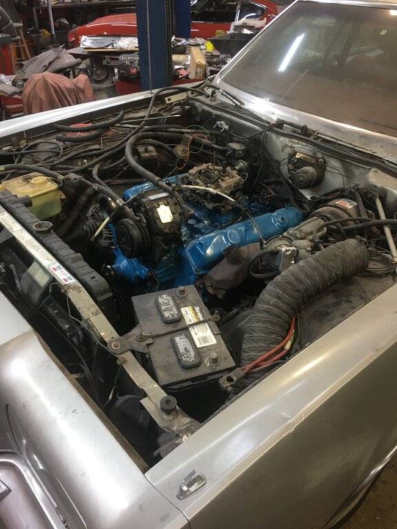

Engine in.....

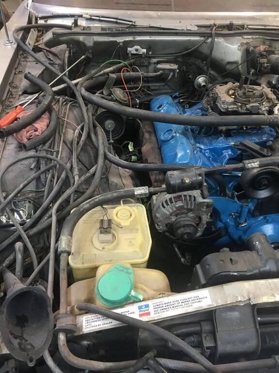

ordered new heater hoses as the old ones were a little cooked.
I changed trans filter, did band adjustment per FSM (a first for me), change selector shaft seal, new rear seal and installed new bushings on shift rods. Tranny was more than a little weepy. Oil was filthy. Drained the lines and cooler was cleaned out with the radiator. So I should be good.
And yes.... I put the Thermoquad back in.
should be firing it up next week to break it in..... hopefully.
Only one mishap... after the engine was set on its mounts in the bay, they went to drop the lift to loosen the engine from the lift and dropped the arm in the fender... ouch.
Ivan came to me with it and asked what to do. I told him to fix it and paint it.... and the rest of the car. More scope than expected. But to be honest, the paint was gone anyway.
now looking for the window fuzzies. Only pulling some of trim...... probably all! By now you guys know me pretty well.

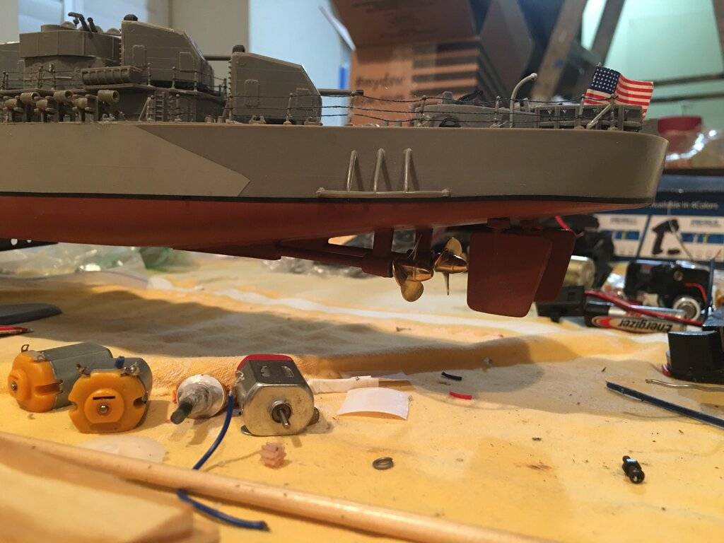

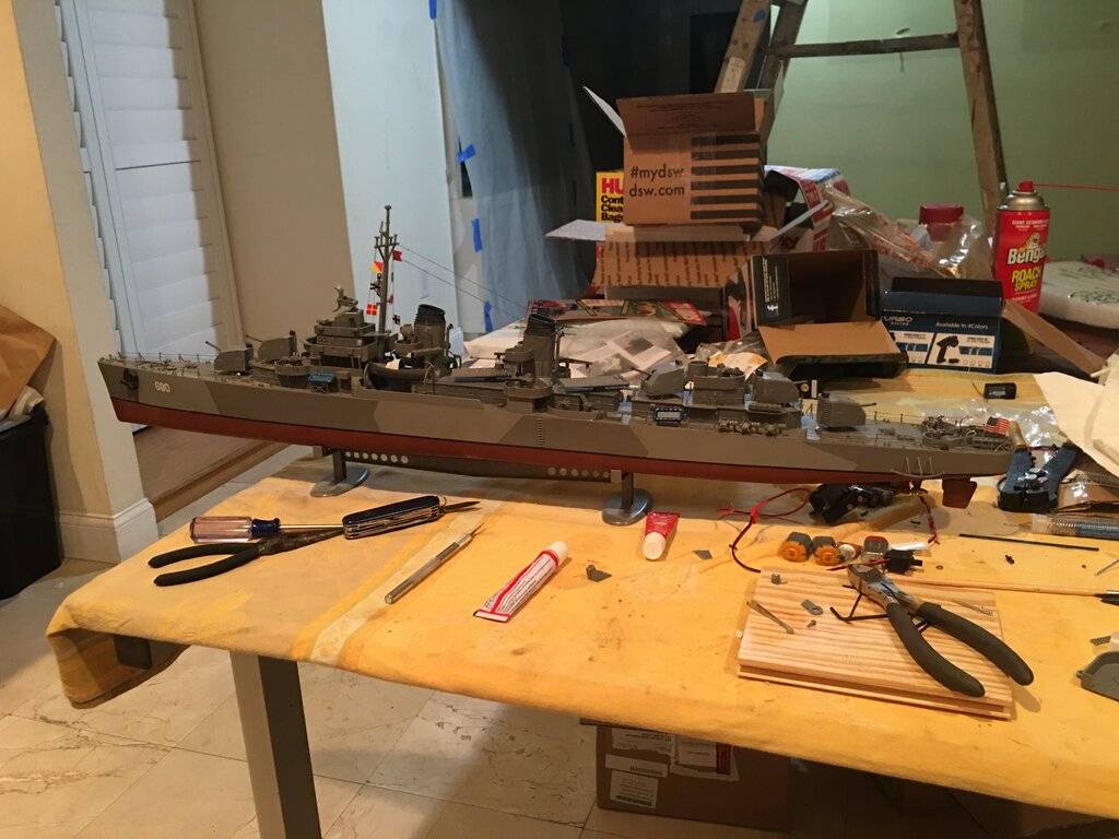

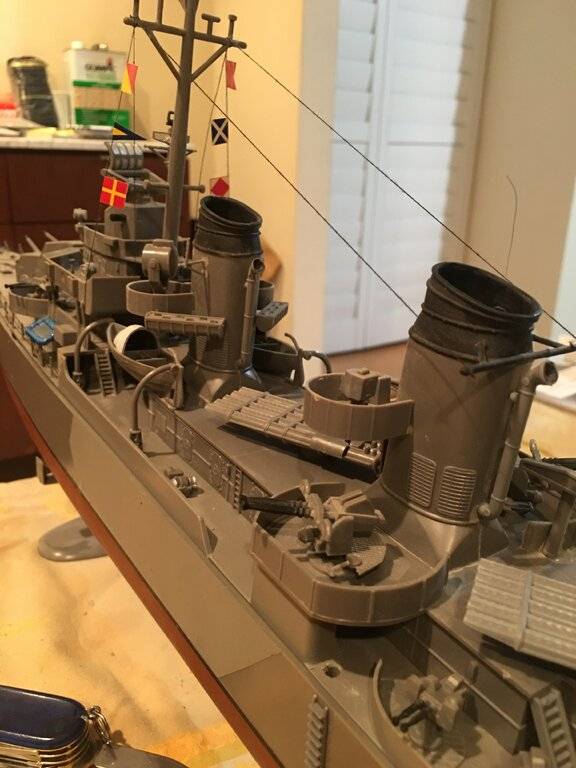

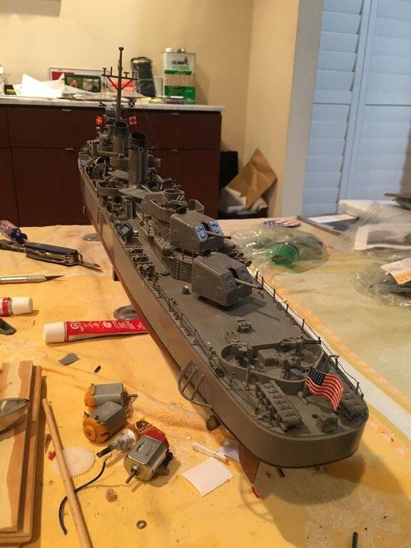

meantime.... as I wait in the now empty house for contractors to show up, I’ve recommissioned an old girl that was up on my shelf back to fully operational battle ready status..... I give you the USS MELVIN, DD 680, Fletcher Class Destroyer
Upgraded new engines and controls installed and working. New brass props with correct 3 blades, and right and left rotation. Turning 5” guns, torpedo launchers and radar. New aluminum reinforced rudder posts and linkage. New Shafts and packing and all missing guns trim and rigging replaced. Buoyancy enhancing foam compartments.... in case of attack by Jap ducks. Or German Uboat snapping turtles.
Next stop... the lake.
