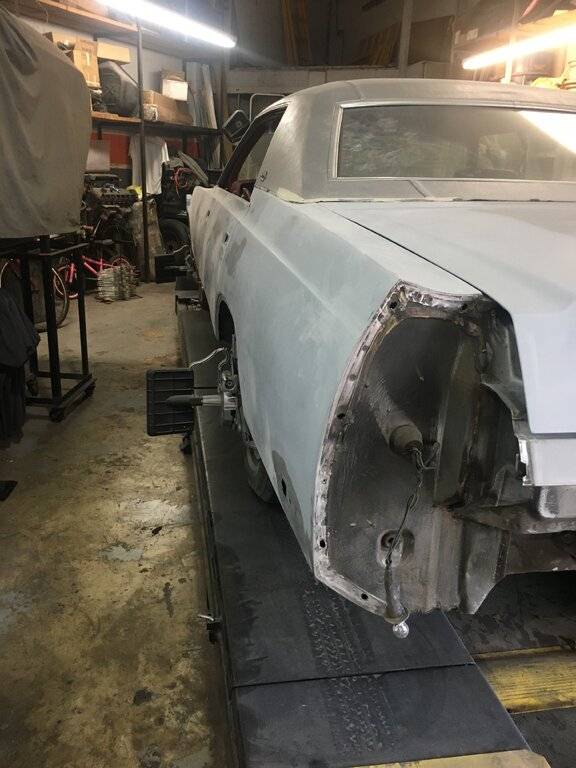

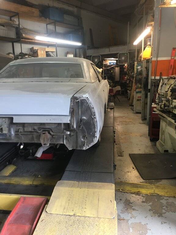

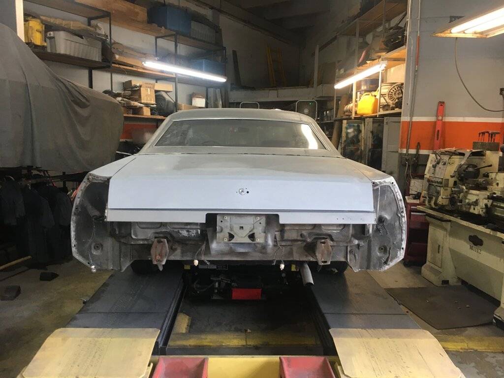

Also alignment check.... camber off but all joints still look good. Adjustment made.

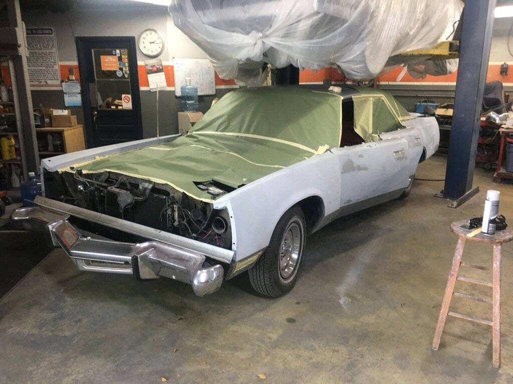

Car got pulled off the line waiting for another so we put time to good use.
All lines look and feel straight.

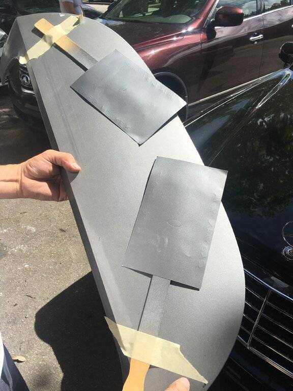

color is correct RA2 but metal flake concentration match took a few tries. Metallics are a *****. The bottom one is spot on.

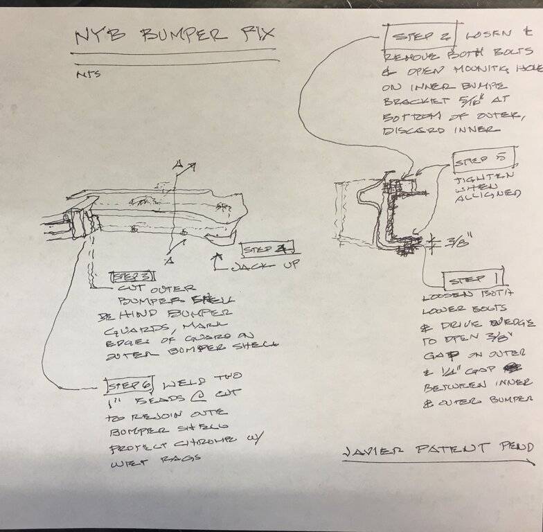

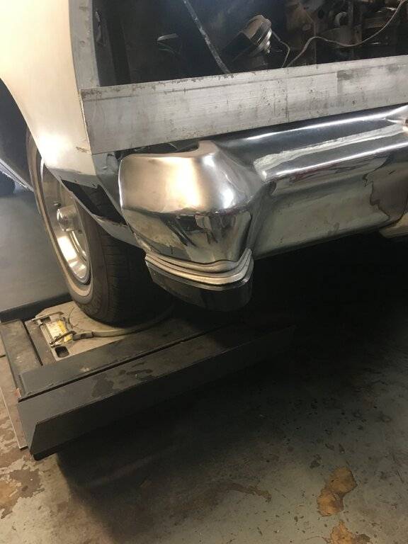

I think I figured it out...... more to come.

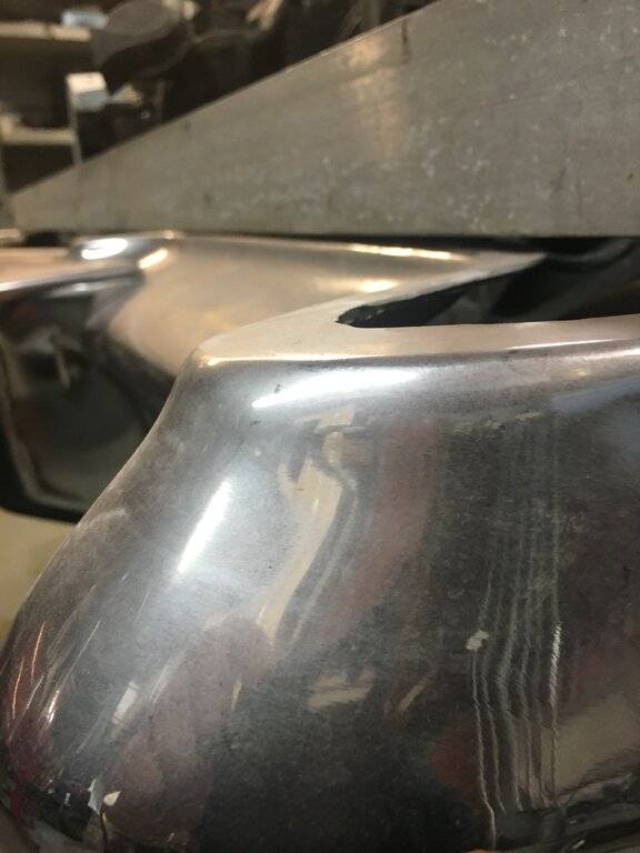

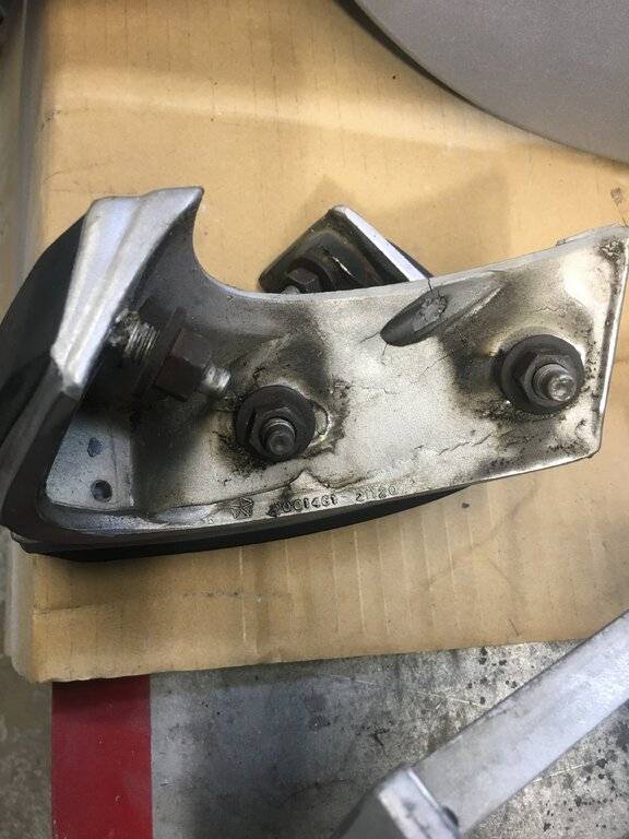

This is how far we need to “bend” it.
About 1/4” at the ends. Both side about the same to get it all to line up a bit better than factory.

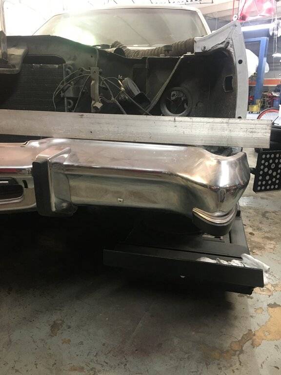

Frontal view shows it very clearly by laying a 3x3 steel angle across the top of the bumper.
Bumper fun continues.... drawings
sorry for the typos.... was in a bit of a hurry today and wanted to give this to Ivan.

decided to do this with the shell back on as it was difficult to pull the front shell off with the bumper on and remaining studs in place.
Try doing it by yourself... :eek:
Been there.... Done THAT!!! Yankee ingenuity... Lowered the car when it was on my lift to the point where it just touched my Blue Point roll cart, that I strategically placed under the bumper, unbolted it and raised the lift. Done... Reverse to put it back on. Royal pain getting it off and on the cart though!!!! But I managed. Be careful putting the "rubber" filler pieces on. They are the biggest pain of the job!
