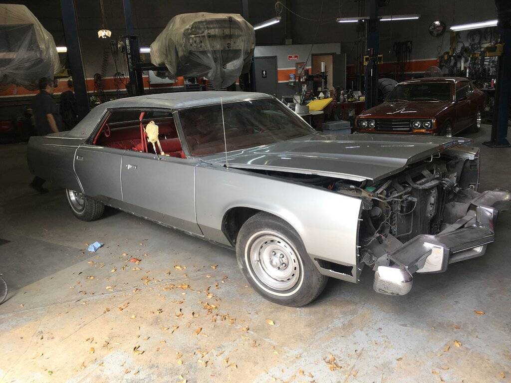

Paint update

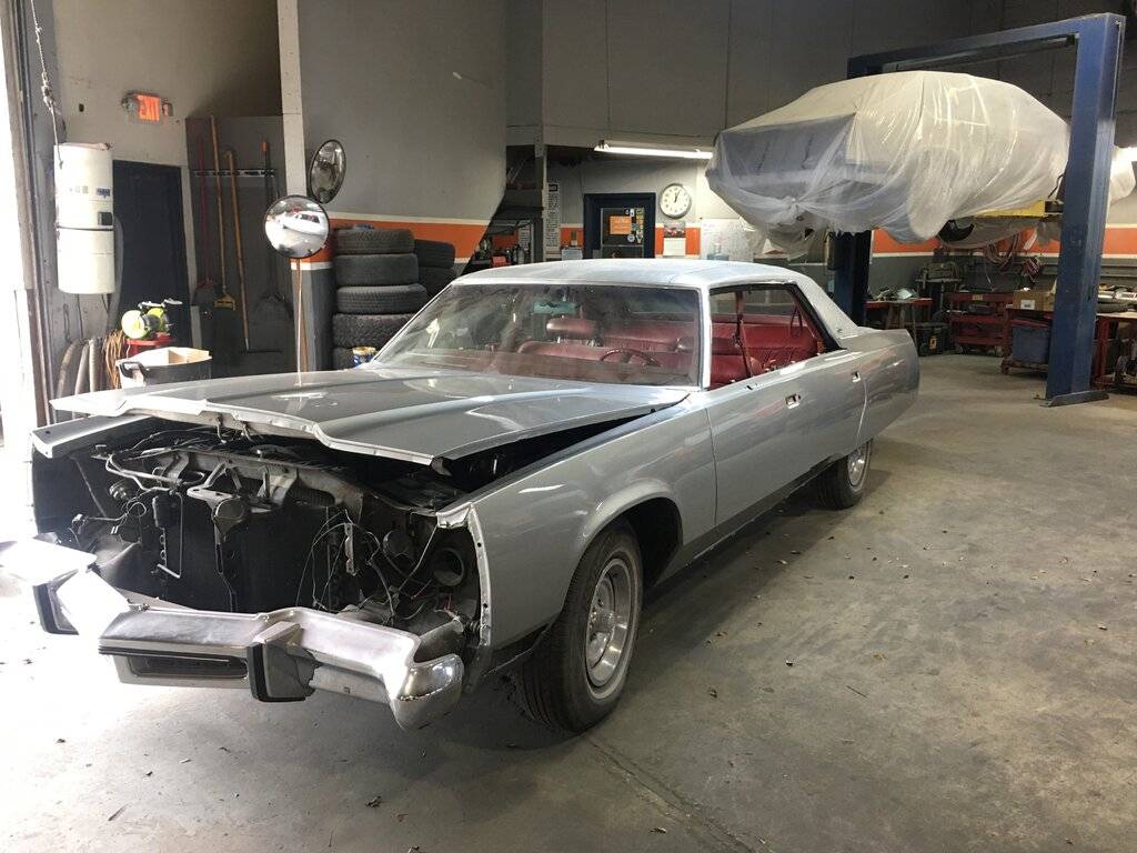

3/4 view passenger side. Had to invent holder/hanger for rear view mirror. I cheated and got lazy but just had to about taking dash apart for it’s removal.

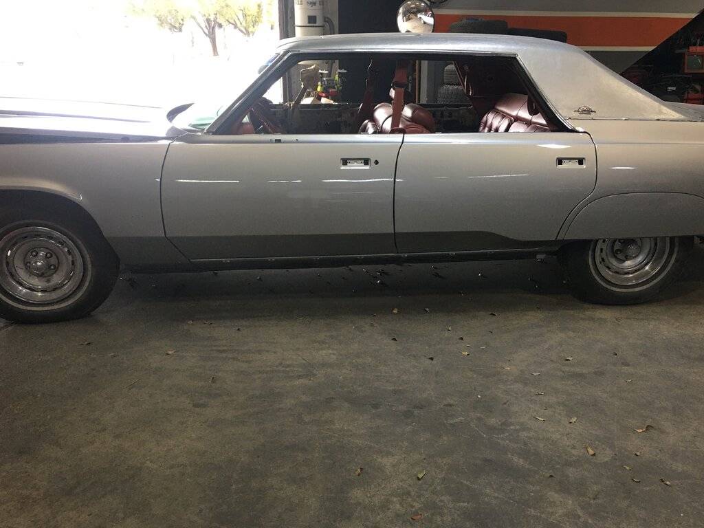

3/4 view drivers side..... ain’t she purty!

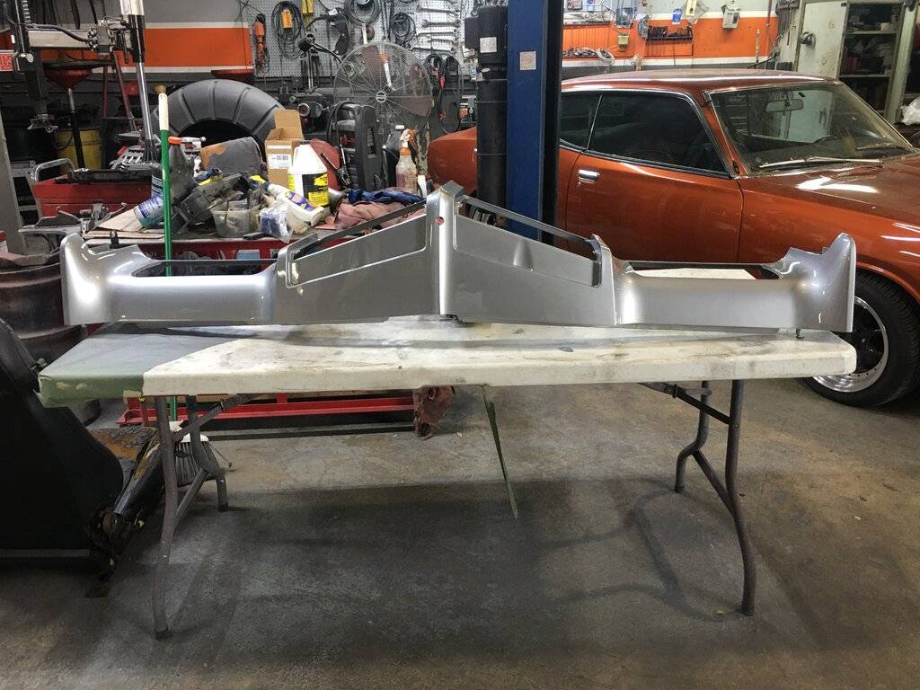

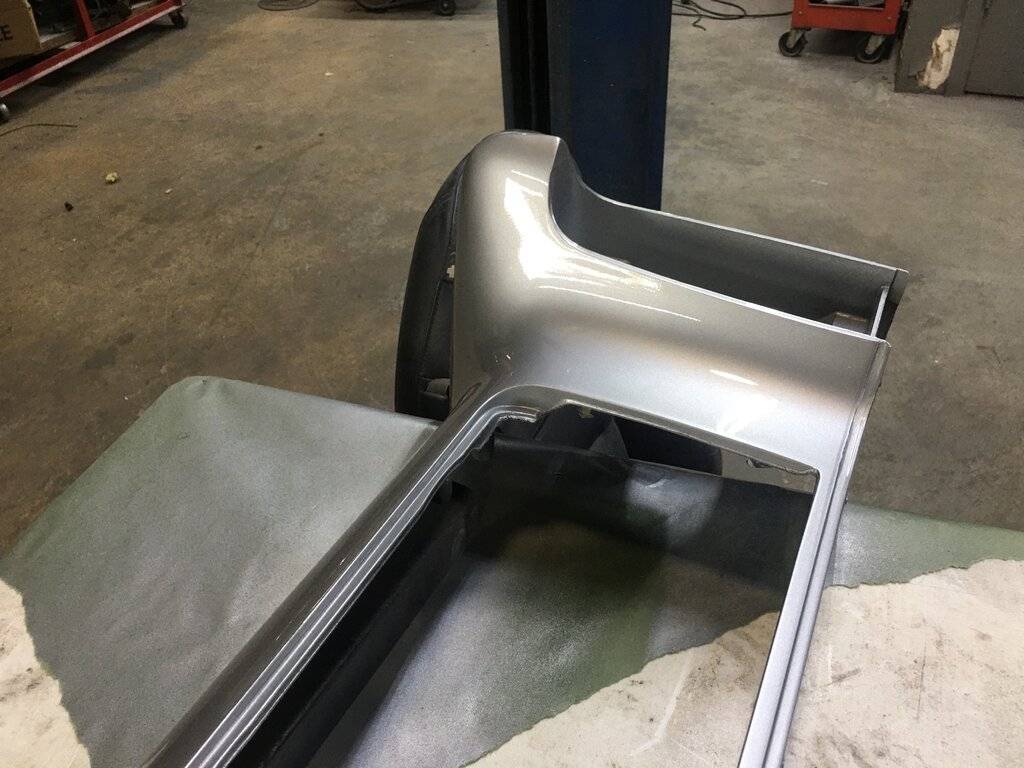

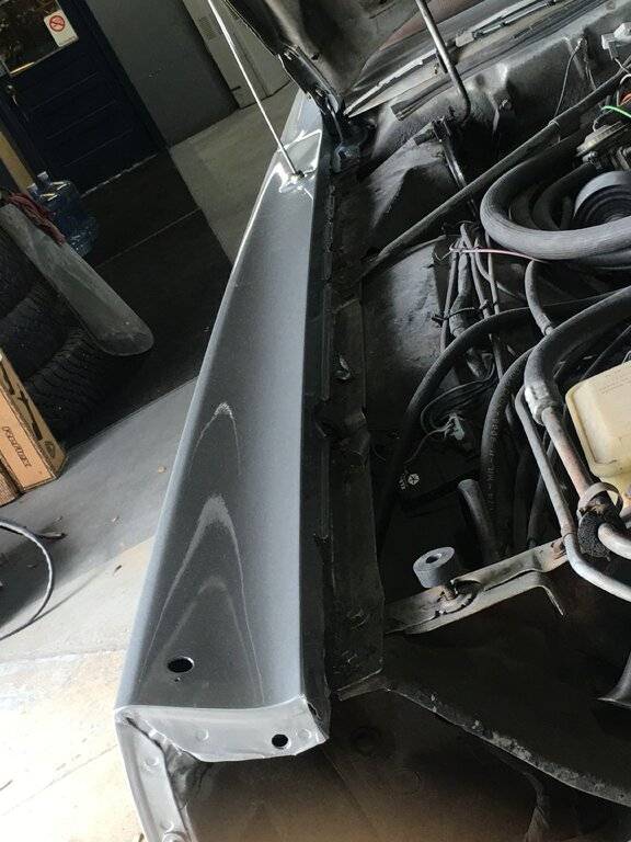

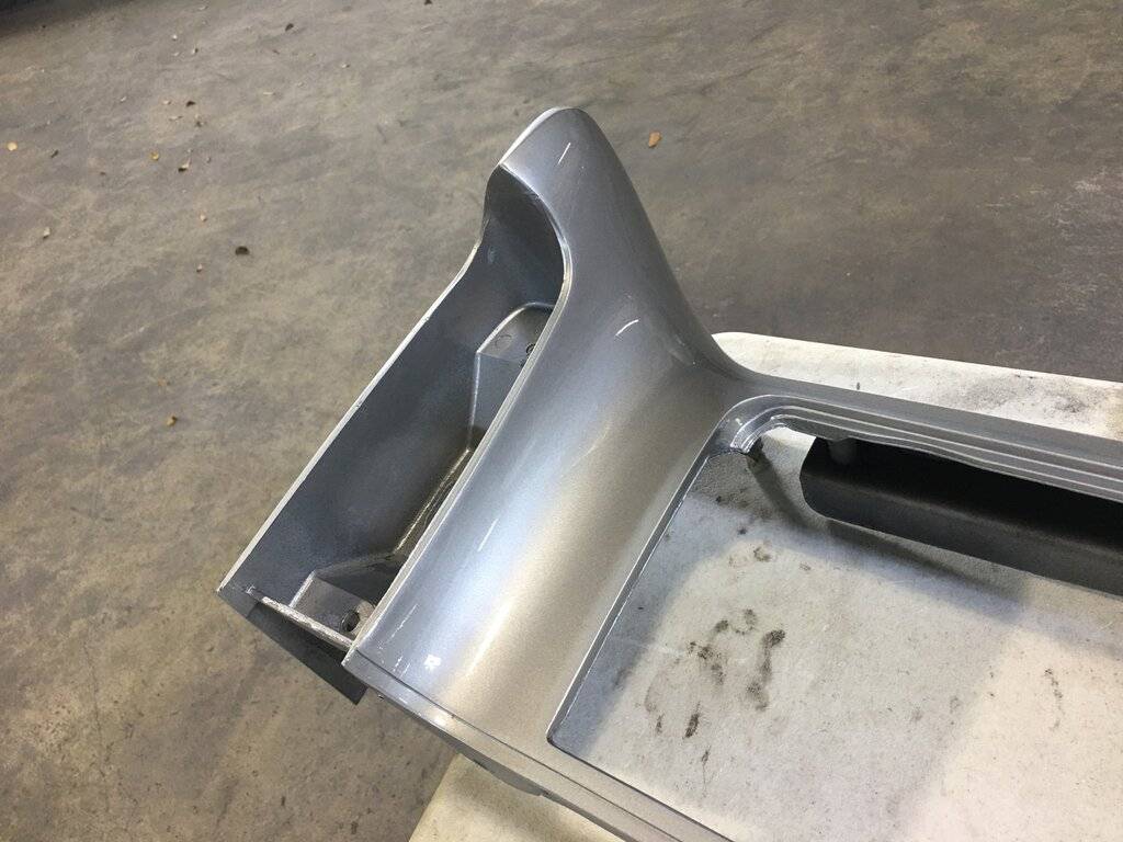

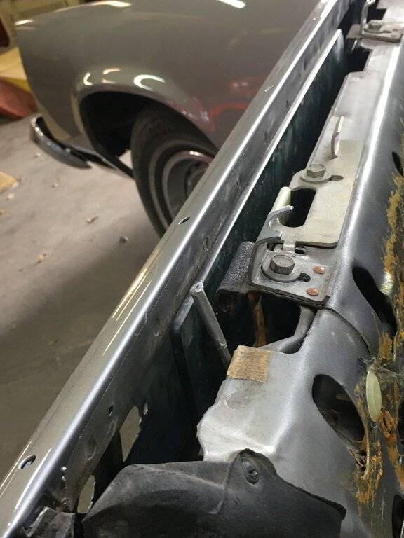

Front cap, top view. Blackout parts not cut in yet... still pending.

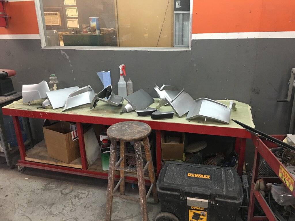

Filler pieces and front corner bumper guards.

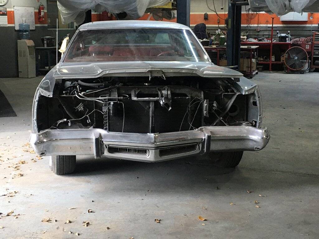

Head on view from front where we were very careful to mask off the guts from overspray. I hate overspray, nothing makes a good paint job look crappy like visible overspray.

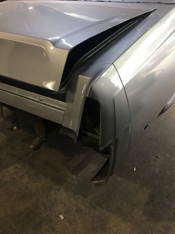

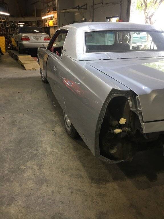

3/4 rear view of passenger side
3/4 rear view of driver’s side

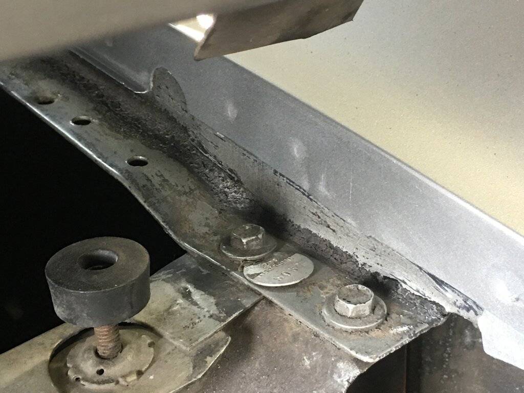

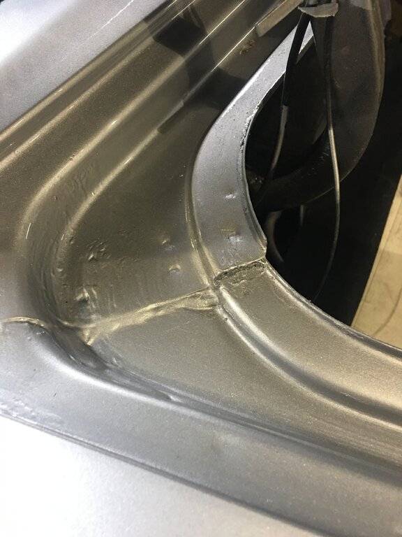

Top of driver door where they painted all the way over and in to end underneath the outer windowsill weatherstrip. (Still need to get new ones)
You can see color match here on the driver’s door where I had the boys paint to the inside edge of the door skin.

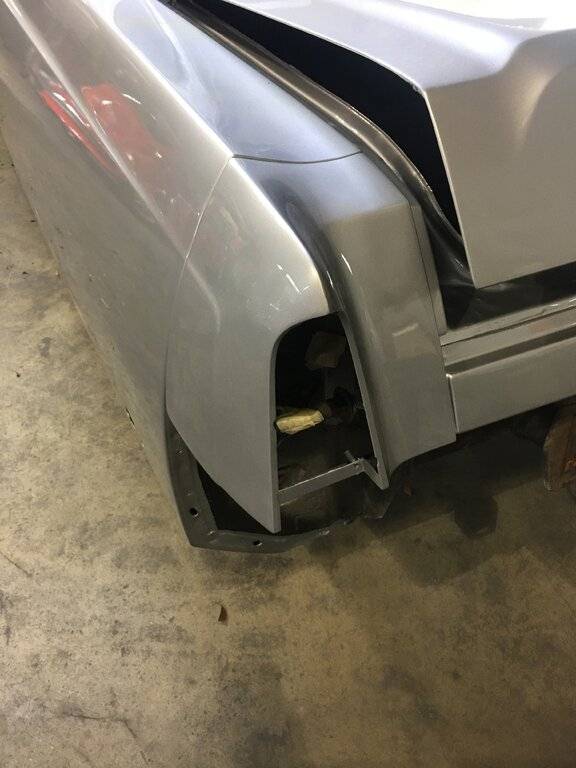

Detail of front cap ends
Other end.
Front nose looking perfect. It was a mess before...

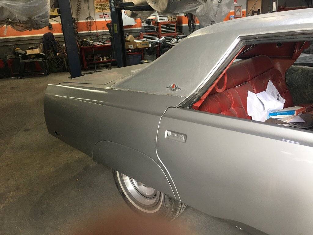

Side view doors and lower a keg line looking straight. Lower lip of body and fender to be repainted in flat black to match original paint prior to trim install.

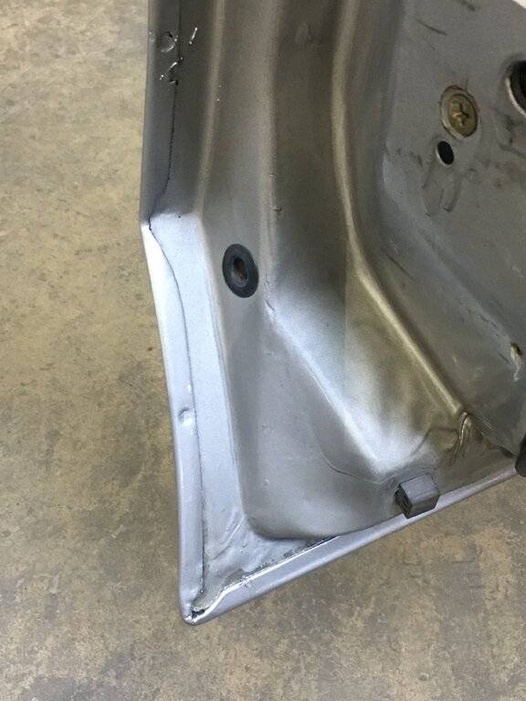

Door skins painted to the inside edge.
Fenders painted to inside lip

Rear quarter view. Light orientation makes paint look darker than it is and pops the top. I think the Salons had a brighter silver than mine. This is a dead on match to the original paint in the trunk and inner doors. Some areas a bit discolored and yellowed very slightly. Should not be noticeable when all the trim is back on to distract your eye.
Looks sweet Javier.. is that cut and buffed yet, can’t tell from pics.
Not even close to cut and buffed. That’s the paint raw from Saturday. Waiting until Thursday to start that process but more likely next week.

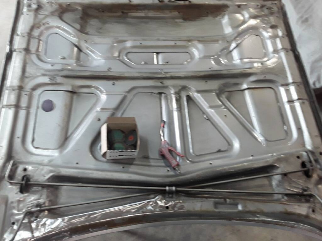

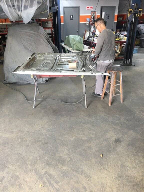

Based on success of underside of trunk lid, I decided to paint underside of hood as it was a bit surface rusted and needing attention to protect it. Will also have it sprayed with wax oil inside when done. That will require a few holes drilled in it underneath but.... what the hell.
Underside of aforementioned trunk lid...

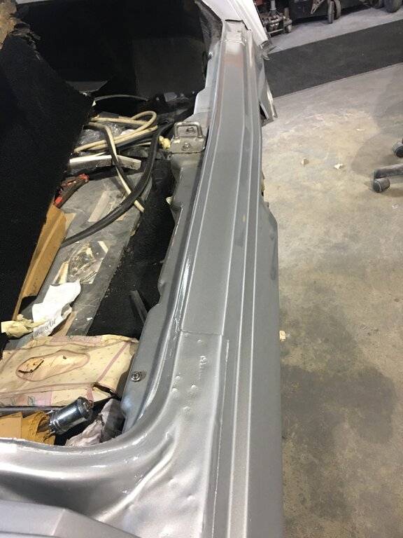

underside of trunk looking nice.
Painted to inner edges of quarters and trunk opening including lips for weatherstripping.
