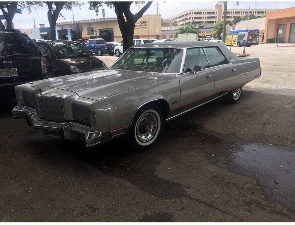

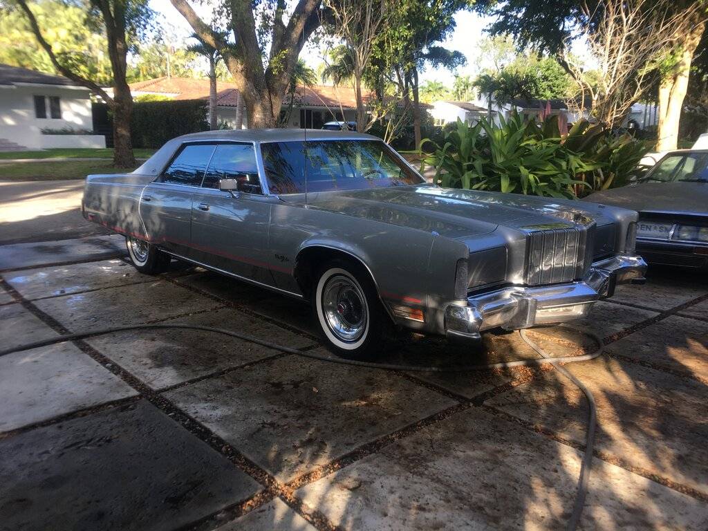

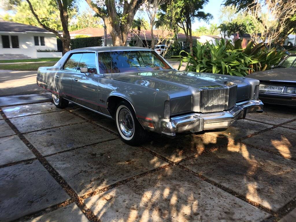

I washed her good and even tried out a new product on it. Ceramic coating “wax”. Spray on wet and buff dry.
Put a Mother’s shine on the wheels and treated the leather to some neatsfoot dressing.
Yesterday afternoon I fixed the switch on the right rear window, overhauled the washer reservoir and pump, and, repaired the driver’s side wiper arm (though I will probably look for a replacement).

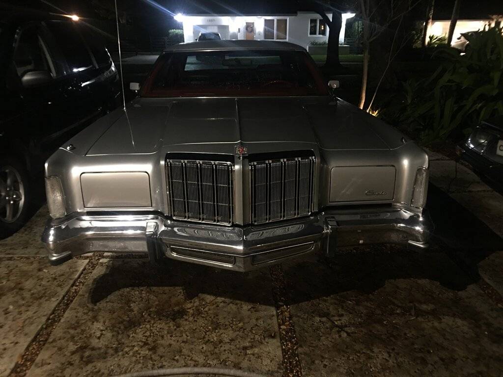

here she is for your viewing pleasure and critique…. With and without a hose in the picture.

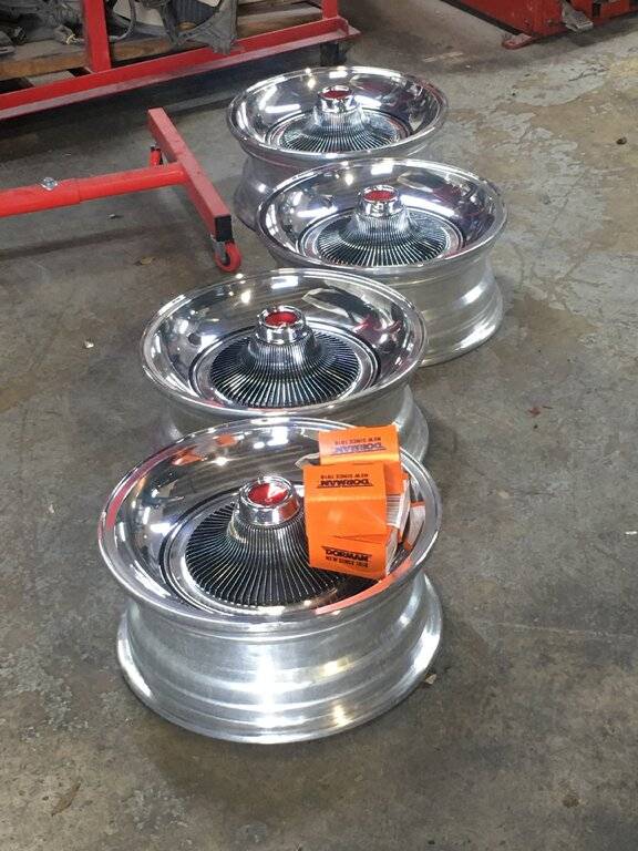

polished them myself…. What a job…

I've been looking for longer studs (3 inch) but have not found any, Dorman did not show a listing,
could you point me in the right direction?
