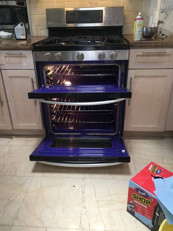

I’m working on my house at the same time so I partnered cleaning the stoves and ovens in between working on the car. I need to put a tach on it to see what RPM is max vibration point.

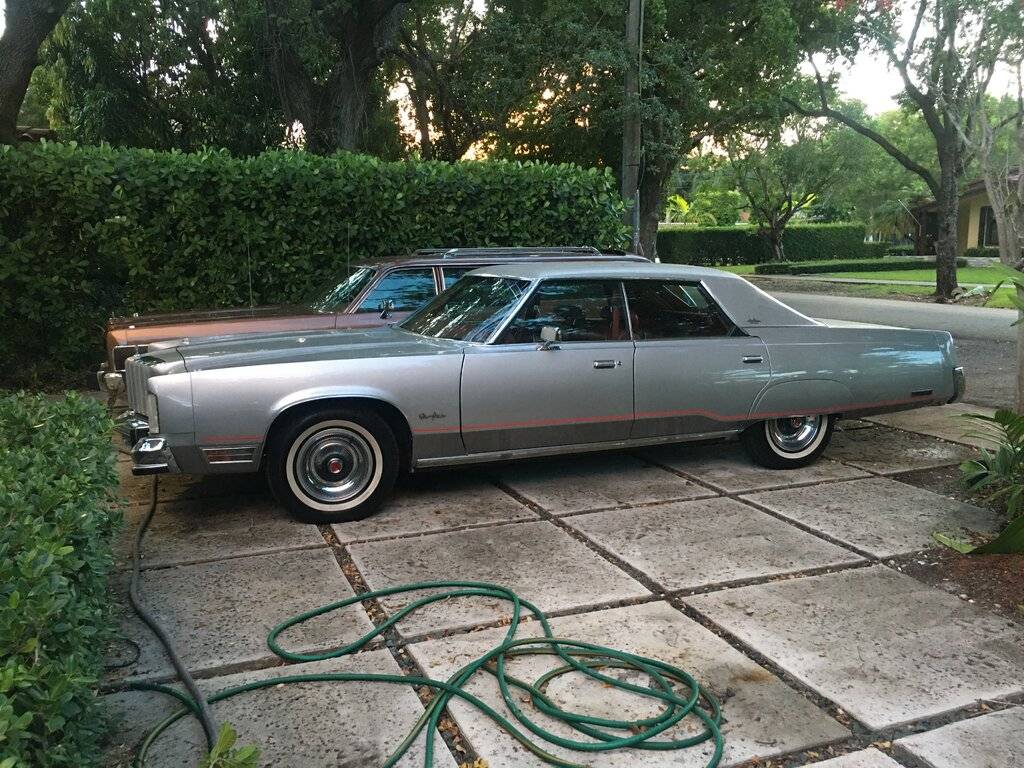

of course I had to wash the shop dust off….hose is for scale.
Drove in to work in “The Beautiful New Yorker” and was the talk of the town (or at least the office).
